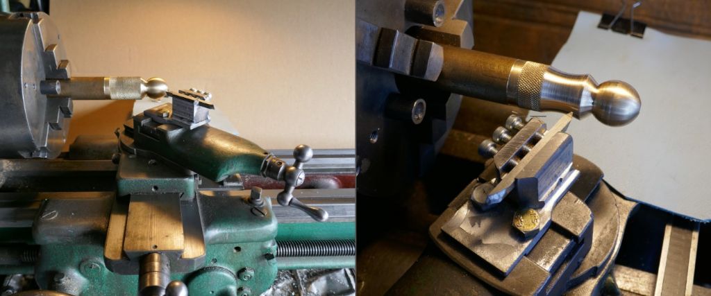

      I have to turn some ball shapes and contemplated making one of the designs already published but decided on a simple attachment utilizing the existing features of my 9" Southbend lathe.
      The compound rest and top slide on the lathe are mounted on a pivot (as are most other lathes) which has all of the features required for a ball turner. It just needs a diferent tool holder. It rotates about a centre point which can be positioned in any position in the X and Y direction and has a fine feed slide for advancing the cutter. After a few hours work using scrap materials I made this simple tool holder.
      Spherical shapes and curved grooves can both be machined.

        #368797
        I.M. OUTAHERE
          @i-m-outahere
          How many machinists have made or purchased a dedicated ball turner when there was already one on the damned lathe !
          Food for thought right there !
          #368812
          Clive Foster
            @clivefoster55965
            Works well if the pivot behaves when used for dynamic rotation. However they aren't really designed and made for such duty so may not work on all machines. Tried it on my first SouthBend 9", a well used machine, with iffy results. Got the job done OK after copious use of emery to give a proper finish. Looked spherical but I suspect it wouldn't have measured that well. But visual appeal was sufficient.
            Hardly surprising really as the pivot is simply a dovetailed ring with two rods with matching angles on the end pushed into engagement by screws to hold it in place. Fine to lock it down but not exactly a shining example of bearing guide and gib system design. The pivot ring is usually a good stiff fit in the cross-slide which must help. both mine needed care, accurate pulling and talking to to get them out for maintenance.
            Thanks for the reminder tho'. My Pratt & Whiney B has a decent diameter post over 1/2" long on the base of the top slide nicely fitted into the cross slide with a T slotted ring carrying the locking bolts and Tee nuts. That appears to be much more appropriate engineering for the job so I'll give it a try next time. Whether such field expedient solutions are appropriate on a hefty 12" (American extended definition so true swing nearly 14&quot swing industrial machine is perhaps another matter.
            Clive.

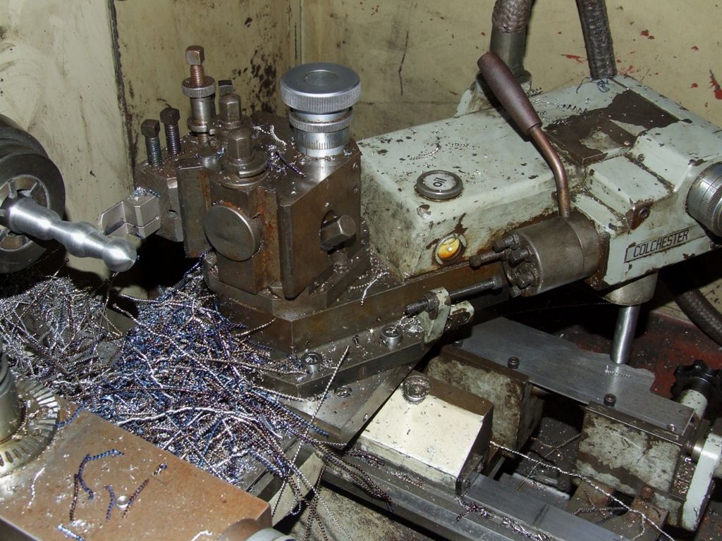

                Talk about OTT. embarrassed
                Andrew

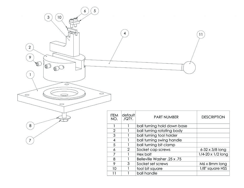

                                      I have seen the tailstock mounted type and the one from Mumbai, like that below.
                                      Both are fairly simple but what is missing from the design is a quick, accurate way of advancing the cutter. The only way in these is to loosen the clamp screws on the cutter and manually re-position it.
                                      The cutter holder in the above sketch was what gave me the idea for mine but I mounted it on the existing top slide on my lathe instead of the rotating base shown. The lathe top slide already has a micrometer adjustable slide.
                                      Paul

                                        You only need to advance the cutter to set the initial radius on the Bedair (mumbai) type then just use the cross slide to put on a cut. It will do the two outer edges first and then slowly form more of the curve. If the work is the OD of your ball you just need to touch off to set which takes a few seconds, at least it does for me.
                                        If you want a way to fine adjust the radius then it only needs a stop end on the groove and a push/pull screw into the cutter block.
