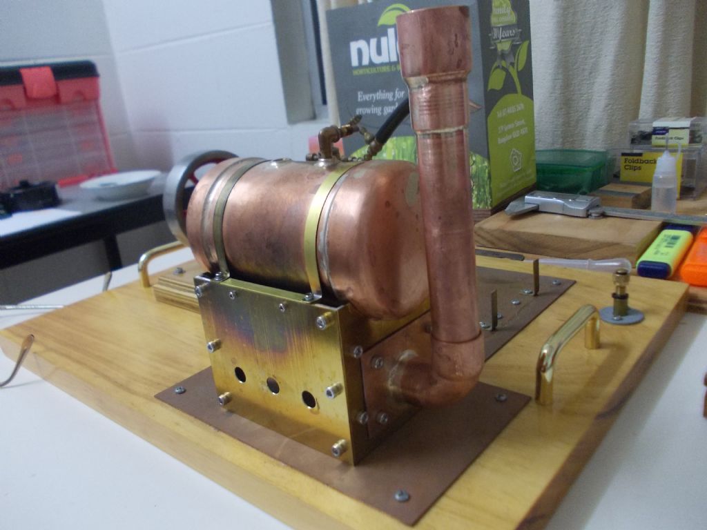

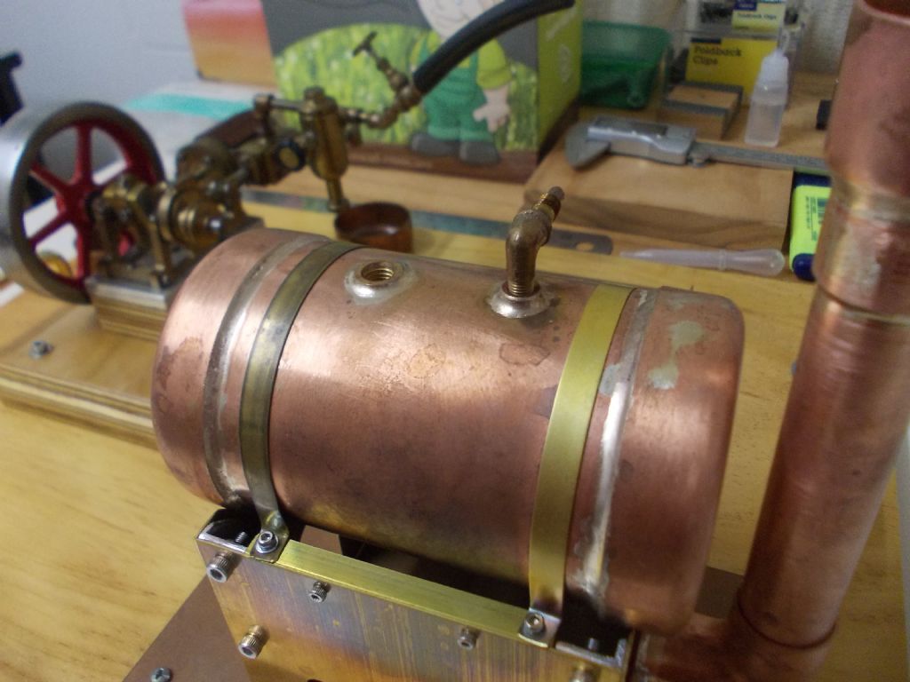

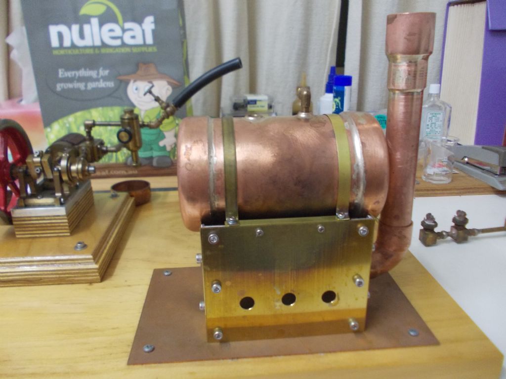

              #562381
              Brian John
                @brianjohn93961
                Mixing the dried out flux with water has worked well. Here is my latest boiler. Note that the chimney is only cosmetic and it is not open to the firebox as this results in too much heat loss. I thought the boiler looks a bit strange with no chimney. The other hole in the top is for a Mamod safety valve.
