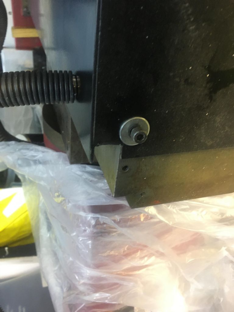

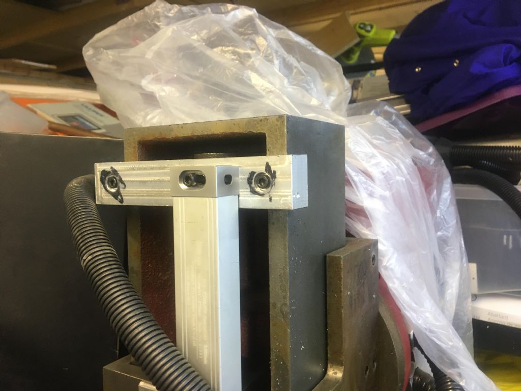

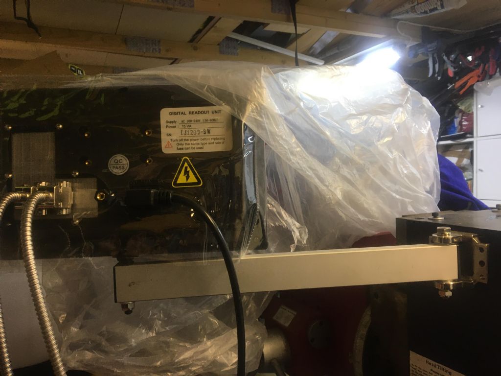

              I've just fitted one last week as im now onto the cross slide.
              You need to move the black controller back section out 30mm to allow for the scale to fit inside, also if you clip off 10mm each side of the black controller then the head can lift 60mm higher (bonus )
              I will sort some pictures later today

                        Martin Mcgiff
                          @martinmcgiff65046

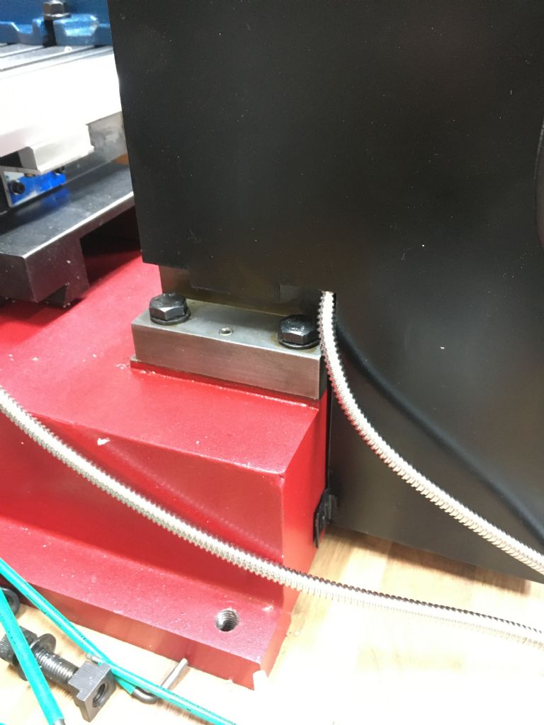

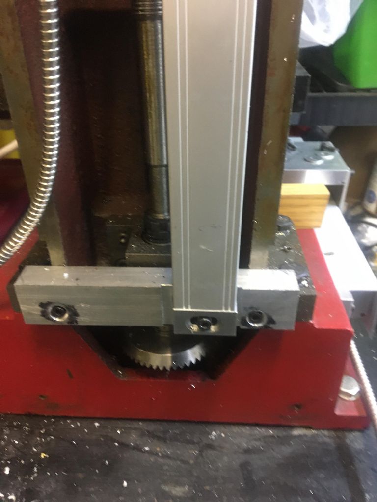

                          I made my own as was a better instalation as i also fitted the z axis in the column and moved the controller box back 30mm 92844905_532307884138885_3790375047504330752_n (1).jpg
                          Edited By Martin Mcgiff on 13/04/2020 15:40:23

                            Martin Mcgiff
                              @martinmcgiff65046
                              The machine controller i mean is the big black box on the back of the machine, i moved it by 30mm to allow the scale to be fitted inside, i also modified it to allow the head to travel 50mm higher, i fitted the DRO arm to the top of the controller box on the right hand side, it is ok and at the right height to read it.
                              i have painted the floor today but will get some pictures tomorrow

                                    Martin Mcgiff
                                      @martinmcgiff65046

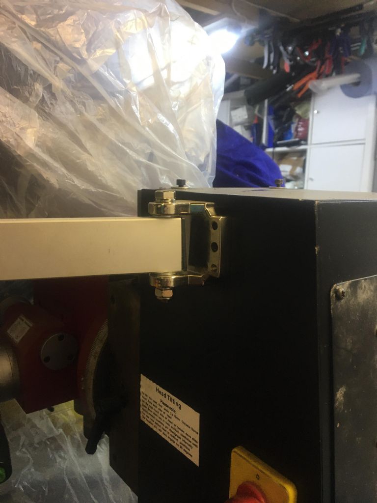

                                      Just on second coat of the garage floor but some quick pictures this morning of position ot the DRO arm, inside the rear column 2 cross beams and a bracket (all inside the black control panel) i moved back the screws on top 30mm to allow for this and i also removed 10mm each side at the top to allow the head to rise 50mm higher !!! 93234291_3733922976680341_2806761531662925824_n.jpgArm top right
                                      93156038_248617186182769_6193841499419967488_n.jpgtop of head screws moved 30mm back93001908_237492550789166_2834978938516668416_n.jpgTo allow Z scale inside 93566013_504843610395967_2313160959176212480_n.jpg93430323_851834245328550_5032960308017102848_n.jpg93303573_2734102963476369_4176346952188821504_n.jpg

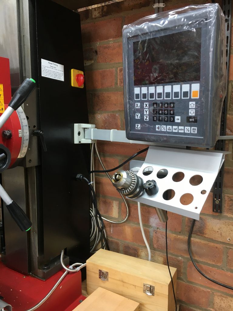

                                        Martin Mcgiff
                                          @martinmcgiff65046
                                          I have Moved the milling machine back into its final position, picture showing the DRO arm position92722314_2444467582531052_937057629425893376_n.jpg

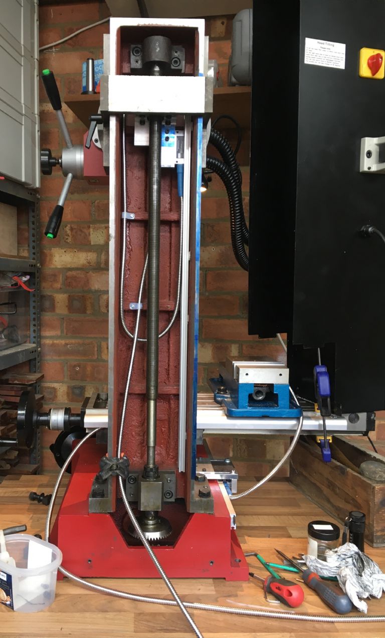

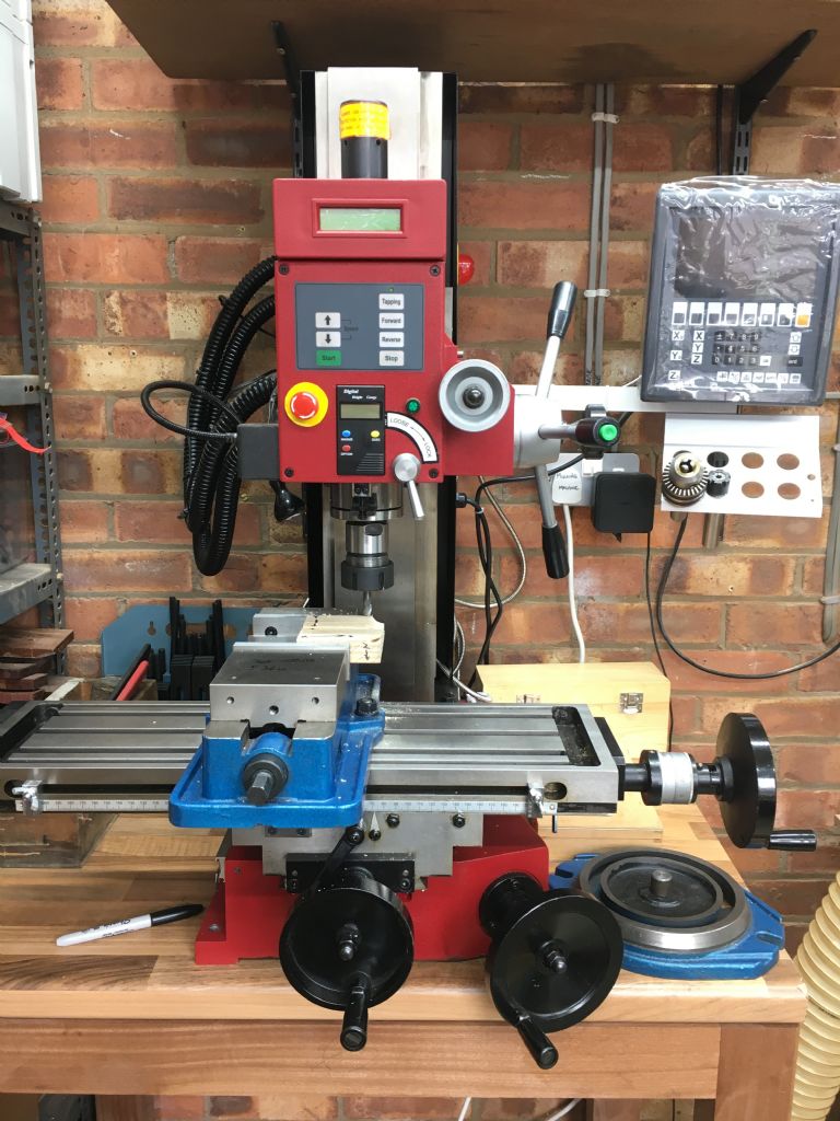

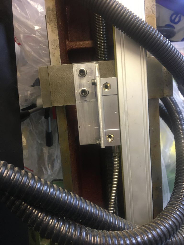

                                          Mike Donnerstag
                                            @mikedonnerstag

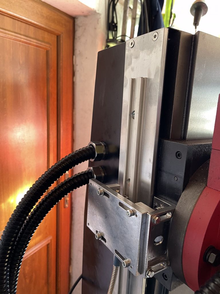

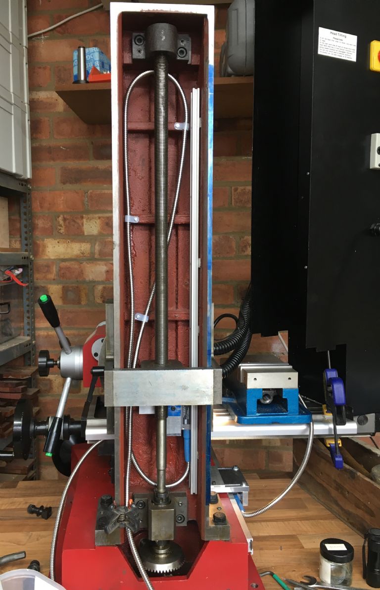

                                            Many thanks to everyone who commented on this post. I decided to install the Z-axis inside the column, as far back as possible to ensure the cable does not foul the Z-axis leadscrew. Photos follow:
                                            I'd be very interested if anyone has any comments.

                                              I'm impressed by the neatness of your installation, particularly with the mounting in the rear column.
                                              I've just invested in a 3-axis kit for my SX3 from MachineDRO so would like to pick your brains and benefit from your experience if you don't mind. It will be a while before I actually find time for my installation but I'd like to get it clear in my mind how I will go about it. It may be that I should address some questions to MDRO, and that the answers to some will or would be obvious when the rear column cover is removed – but in a restricted space my mill takes a lot of moving so a quick look inside beforehand is not so easy.
                                              An easy starter – you obviously discovered how to cut the magnetic strips to length, please tell.
                                              Is the mounting for the display fixed to the pressed-steel cover, or through it to something more substantial?

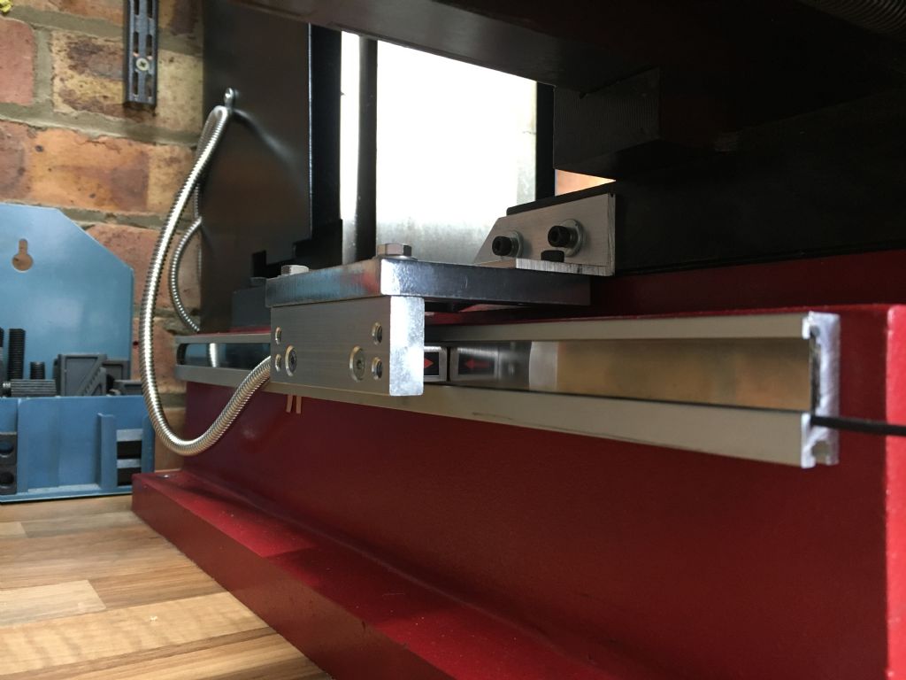

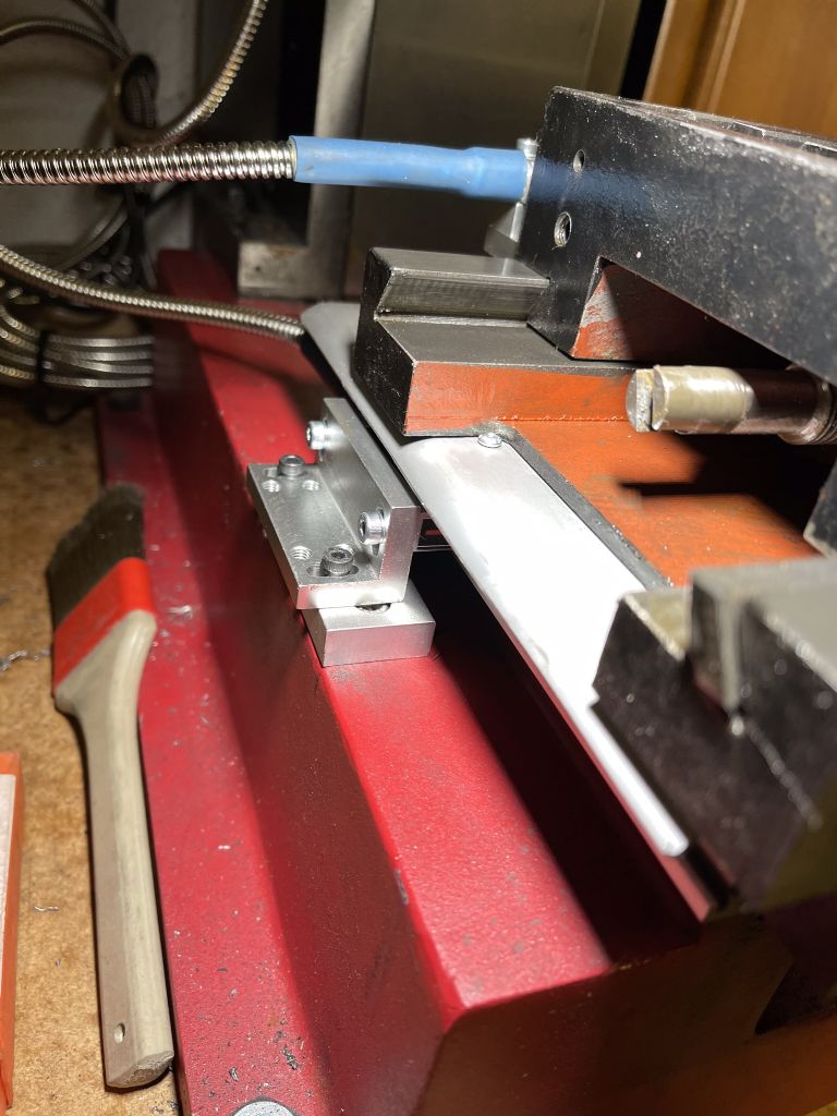

                                              On the X-axis you have mounted the scale on the table with the read head fixed, but vice-versa for the Y-axis – with the scale fixed and the head travelling with the saddle. Why have you chosen to do thi?

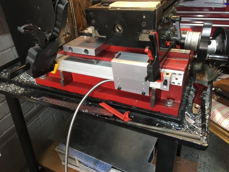

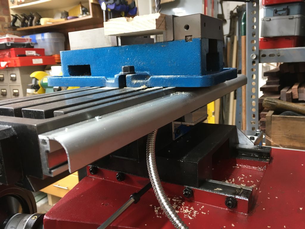

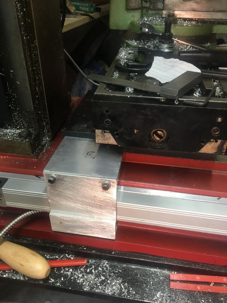

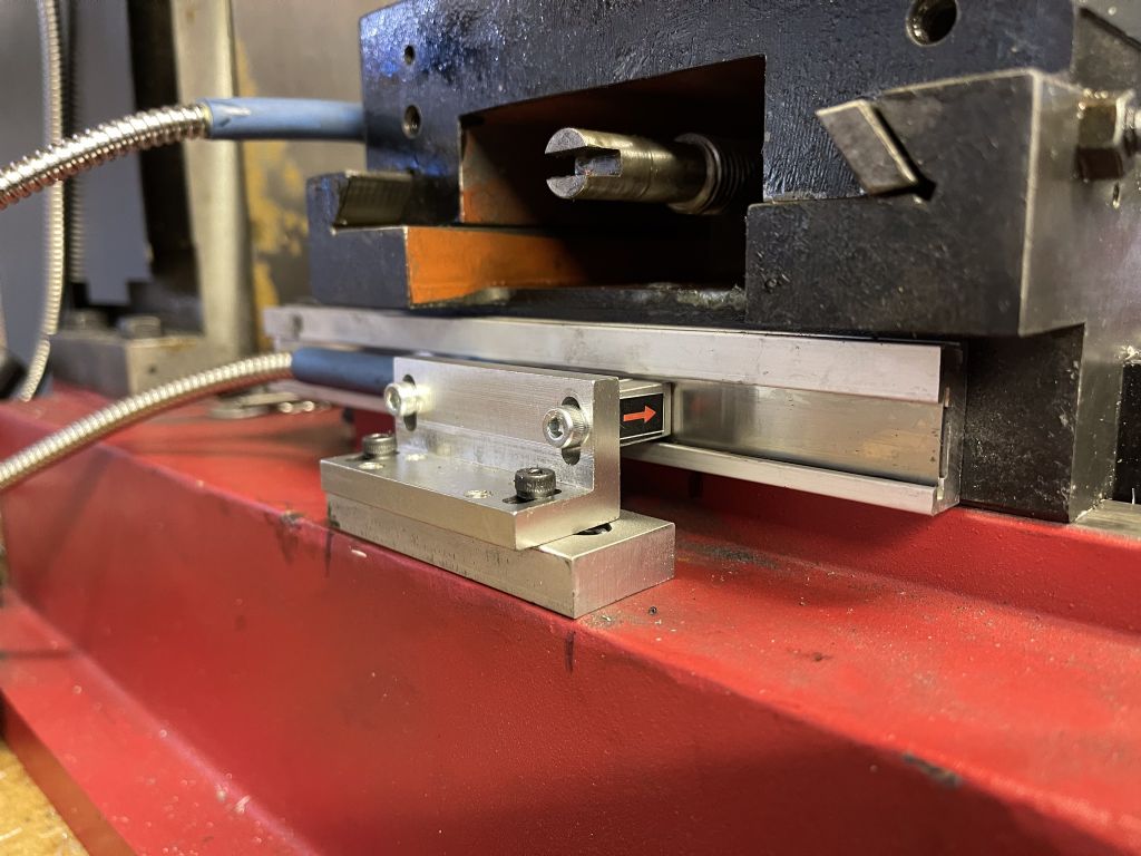

                                              Martyn Edwards 2
                                                @martynedwards2
                                                Same kit but slightly different approach on the Y and Z Axis.

                                                  @jameshall3
                                                  Thanks Martyn – interesting photos and another good looking installation. See that you have gone for fixed Y-axis read head and scale on saddle, but wondered what Mike Donnerstag's reasoning was behind doing it the other way round.
                                                  How did you cut the magnetic strip to length?
                                                  I still like the neatness of hiding the Z-axis gubbins in the column, but am hoping to pick Mike's brains on that.

                                                    If you get a longet scale extrusion for the Z then you can just mount that at either end and no need for the extra backing plate shown in Martyn's photo. I'd also fit the bracket to the casting rather than the sheet metal cover, you can make use of the existing screw hole in the top of the column.

                                                    Mike Donnerstag
                                                      @mikedonnerstag
                                                      Apologies for the delayed reply.
                                                      In response to James' questions:
                                                      The magnetic strips are easily cut to length. I think I just used tin snips. The aluminium extrusions obviously need to be cut with a hacksaw.
                                                      The mounting for the display is fixed to a thick aluminium plate behind the pressed-steel cover. This reinforces the mounting substantially.
                                                      Regarding my thinking behind how I mounted the scales and readers, it was all about future-proofing. Specifically, my objectives were:
                                                      1) To leave each of the three scales as long as possible to potentially mount them to a different machine in the future
                                                      2) To ensure the ends of the table are completely clear of mounting brackets, etc., to allow a power feed or even CNC motors to be mounted in the future.
                                                      I think this answers your questions so far.
                                                      I am still not too happy with my Z-axis readings. I think this is due to the 'spring' in the machine between the movement of the leadscrew nut and the head movement. I haven't investigated whether this is the gib adjustment, which may be a little tight, or whether it is fundamentally the fact that the reader is some way from the head. The travel of the feedscrew nut, to which the reader is fixed, doesn't perfectly follow the height (Z-position) of the head. The movement also seems to be too juddery to rely on for accurate height settings, hence why I use the quill for accurate height settings.
                                                      Jason: I'd be very interested in your thoughts on this. Specifically, would you expect to be able to set the head height just as accurately as the quill? Also, do you have any hints on how best to set the head gib so that it's not too tight or too loose? (Perhaps this is one for Ketan?)
