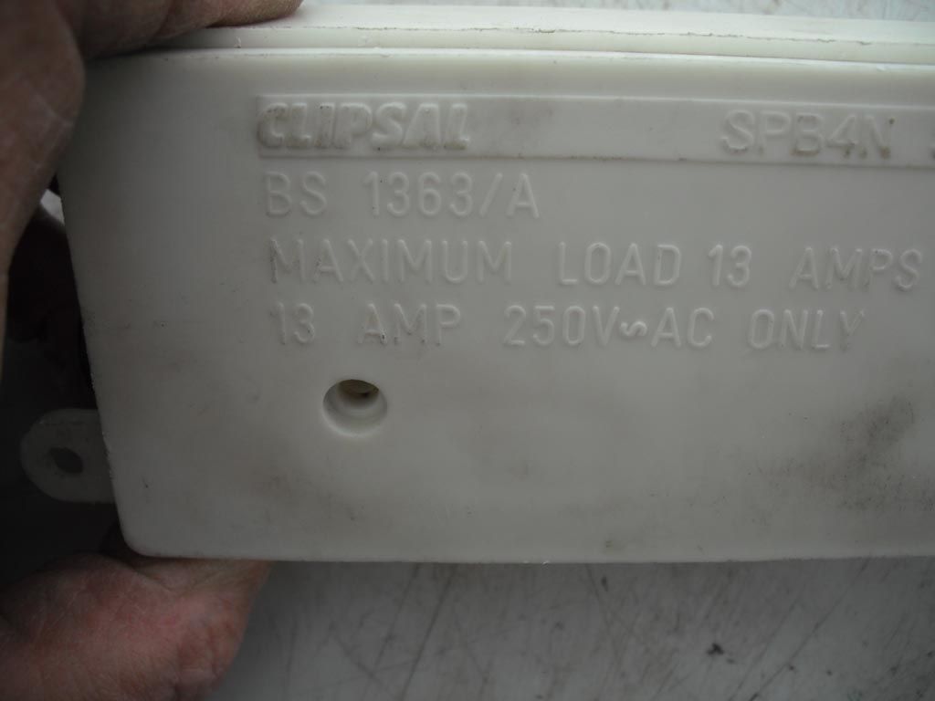

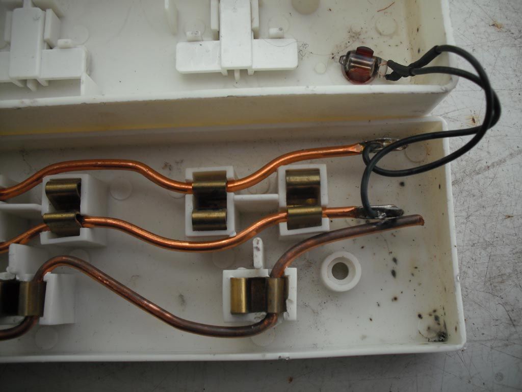

      Got a 4 way block with a 2m lead, from by box of electrical bits, to test my newly arrived bandsaw. Plugged it in and "pop", everything in the workshop went off. unplugged the extension and tried another one. Every thing OK.
      When I opened up the 4 way block I found THIS.
      How do they get away with putting a BS number on stuff like this?

              Holy crap, that is bad. I must admit on first view from my tablet, I didn't spot the major issue. Then I thought why is the earth conductor looking like that. A closer look showed the problem. Good job the earth continuity was sound at the plug end.

                The live and neutral wire fitting at the plug contacts do not look that bright either

                      BS 1363 is a dimensional standard not a quality standard.

                        Posted by Anthony Knights on 15/05/2020 16:49:23:
                        … It’s the ‘uncountable noun‘ BS devil
                        [ third definition in Collins COBUILD dictionary ]

                            So I assume you bent the rod to where it should be & carried on. That is what most would do. Not worth throwing away.

                              Nope! Cut the cable off and fitted a single trailing socket on the end and binned the 4 way block. (I'll probably get reprimanded for that. Should have recycled it.)
