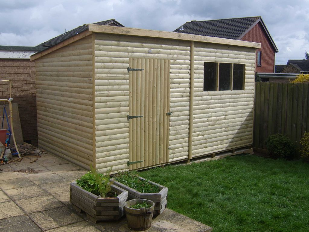

                John Coates
                  @johncoates48577
                  well the day has arrived, another 5 months on!
                  bought from a local supplier who built it as well
                  next jobs are insulation, electrics and planning where the bench(es) and machinery will go
                  also want some mesh security screens and maybe more solid shutters for when we go away
                  John smiley
                  Edited By John Coates on 26/03/2014 13:25:01

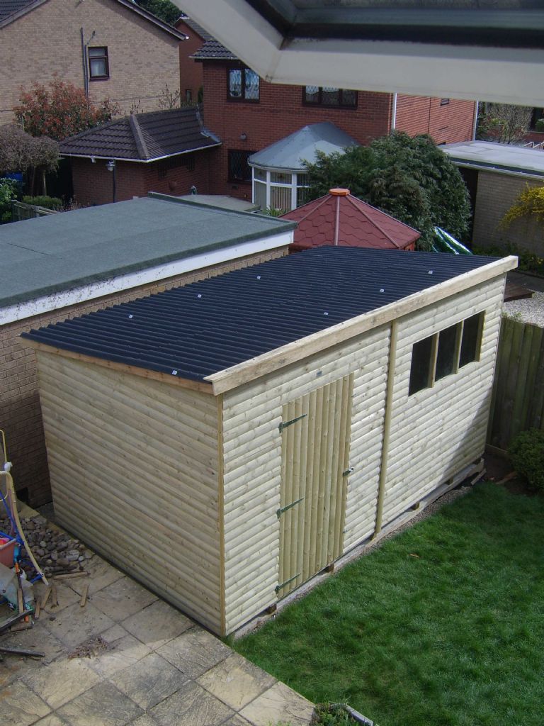

                  John Coates
                    @johncoates48577
                    oh and guttering and water butt
                    and don't give me grief about the pathetic security hasp, I know I know and it will be replaced with three far more substantial items top, middle and bottom
                    Edited By John Coates on 26/03/2014 13:33:01
                    #148114
                    V8Eng
                      @v8eng
                      That looks good.
                      Don't forget the security of hinges, the crooks just unscrew them because it's much easier than breaking locks!
                      Oh yes windows are quite handy to thieves as well.
                      Edited By V8Eng on 26/03/2014 19:01:24
                      Edited By V8Eng on 26/03/2014 19:04:25
                      #148115
                      John Coates
                        @johncoates48577
                        V8 – too true
                        will use coach bolts so no slot heads or hexagons for screwdrivers or sockets
                        also gonna wire it up to the house alarm and armoured cable back to the garage for the power
                        first job is computing the bench space to shelves ratio
                        laugh
                        #148122
                        Andy Pugh
                          @andypugh44463
                          For security, can I "plug" a friend's web-site shop?
                          http://securityforbikes.com/wooden-shed-security-advice.php
                          He has some proper shackles
                          Edited By Andy Pugh on 26/03/2014 20:08:02

                              Oompa Lumpa
                                @oompalumpa34302
                                John, nobody has said it but I would be taking the door off and hanging it from the other side unless you want to walk around the door every time you go into the building. When insulating, you will end up (probably) building out which will give your walls thickness. I would look upon the door as a starting point and set to with some timber and make it into a two inch (mine is three and a half) thick affair, well insulated, couple of thin steel plates around about where you can put a mortice lock.
                                Because most shed doors open outwards – a good thing, they don't encroach on inner space – it is a simple matter to put a frame around the outside of the opening door edge to create a better seal and hide that piece of steel you have going over the exposed part of the lock. I will take some pics later of one of mine to better illustrate, it stops a good deal of draught too.
                                graham.
