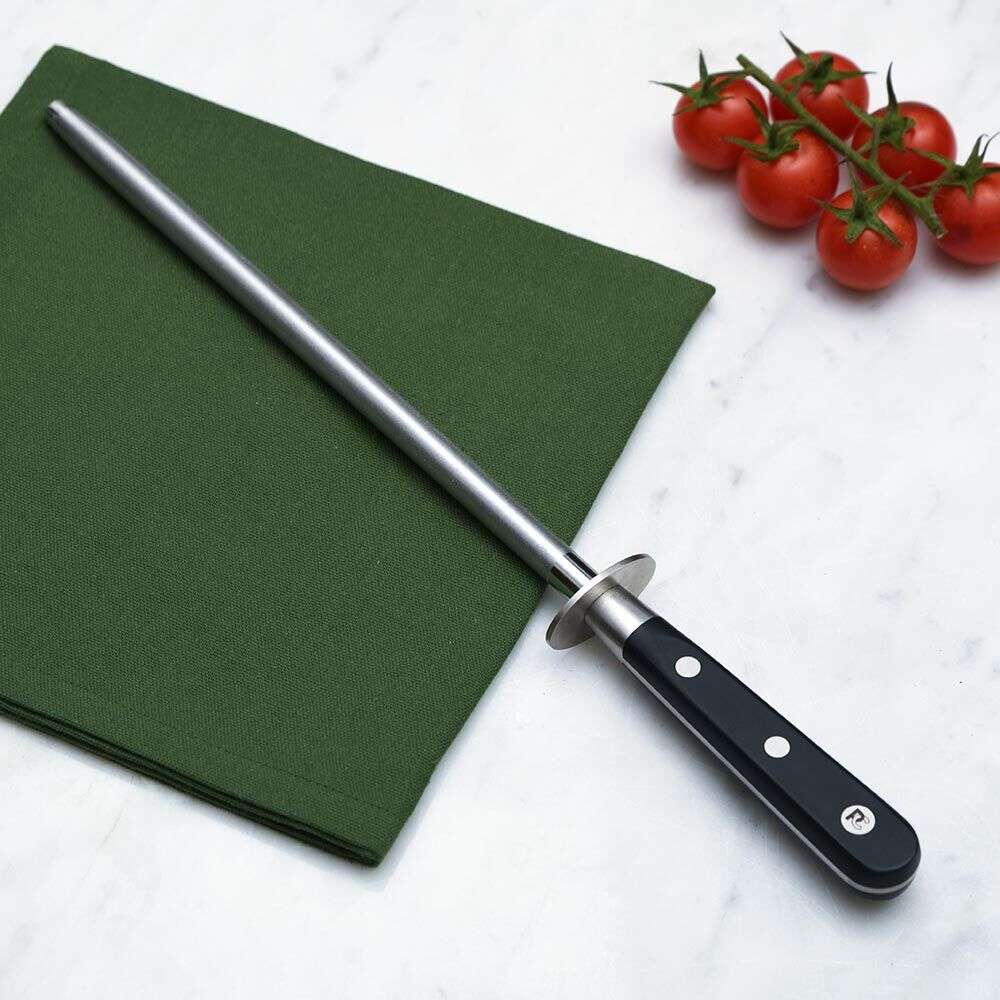

          What about just using a good old fashioned steel
          steel
          Can pick up a good one for £25 Not sure as this would work with the arthritis though as you have to use both hands.

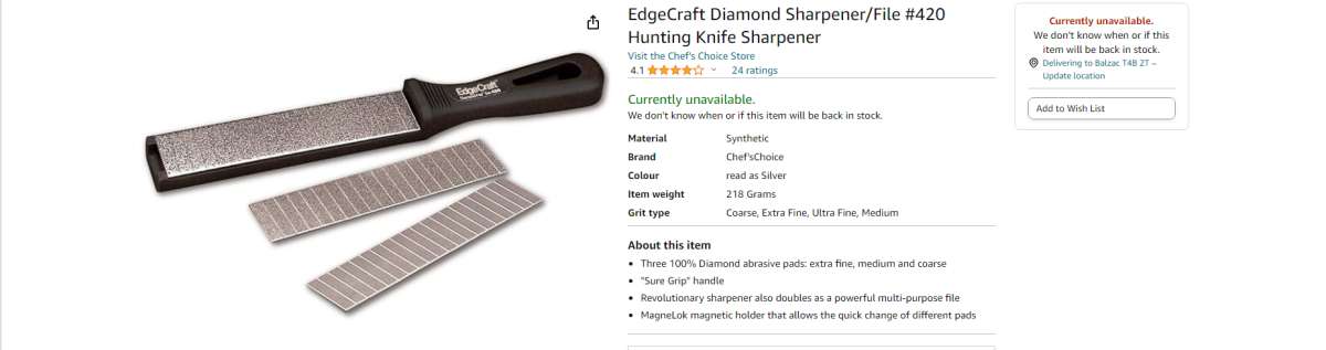

                Do you remember the `edgecraft tool which had a handle that was magnetic and supplied with 3 diamond flats that fitted on the handle. Got it from one of the shows years ago and the only thing its been used for is sharpening kitchen knives and dam good it is too.
                        Yes I have two, one I bought for myself, and the other for my Dad, which I’ve now inherited.
                        The first one I got from a show, and the second took some tracking down, as the guy who sold them was actually a one man outlet for what became a larger TV shopping channel.
                        I’m not sure if he also sold the tipped drill bits I still use for drilling HSS machine hacksaw blades when I shorten them. I can’t remember their name now, but the main branding colour was yellw with red and green writing as I recall
                        I’ve not seen the files on sale for some time

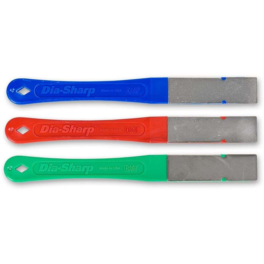

                                DMT diasharp mini hone. I have been using the same red (medium) one for years. May be410121_xl wrap some padding round the handle to make it easier to hold in an uncooperative hand.

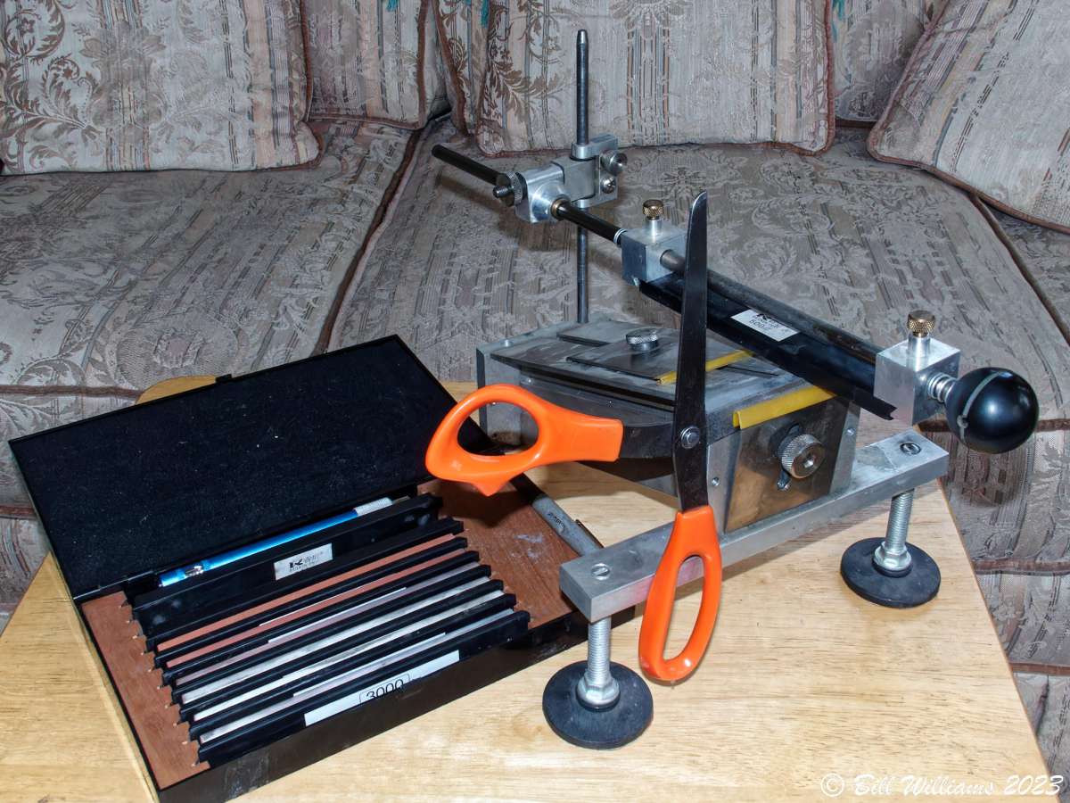

                                    Not the best of photos, but a quick shot of my home brewed version of JaCK’s gizmo.
                                    Made out of scrap bits whilst I was off work with a broken ankle. I intended to make a clip so I could swap sides on a knife, as per JaCK’s but the ankle mended and I returned to work, so never did finish it.

                                      Very nice! I like your mod for high angles/scissors!!!
