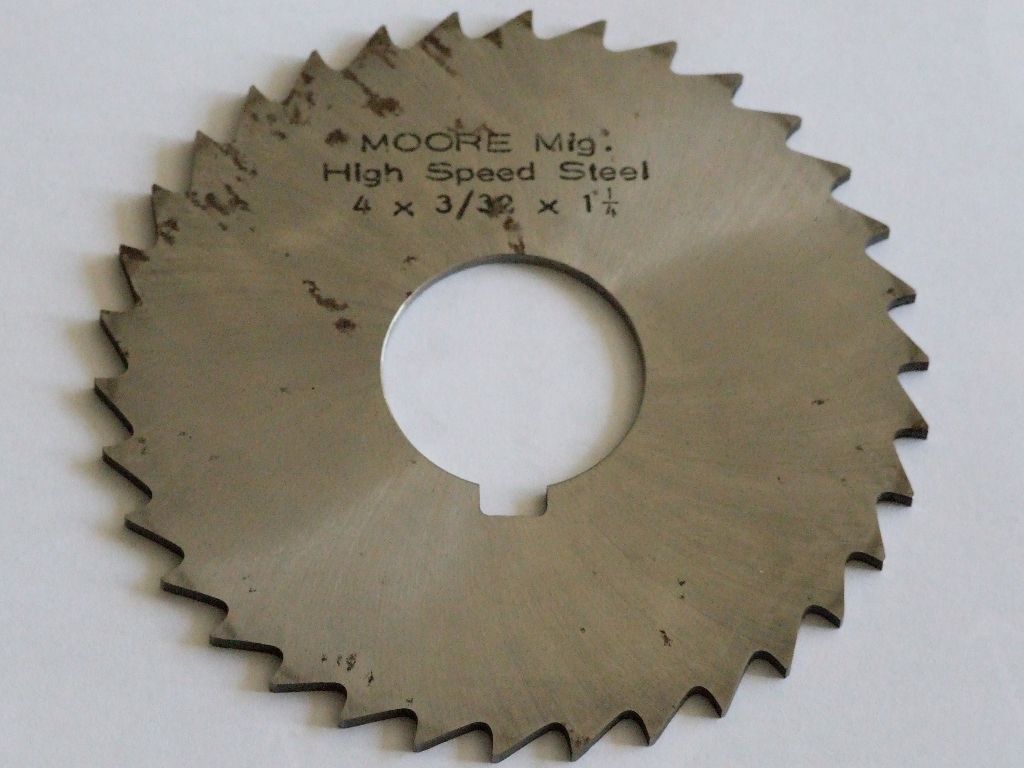

                          All cutters run eccentric to some degree. Slitting saws probably just highlight the effect due to diameter and shallow cuts. Eccentricity will be due to tolerance build up from grinding spindle runout, accuracy of the centre hole diameter, grinding errors and runout on the teeth, and spindle runout and cutter fit when using the slitting saw. I'd be surprised if a grinding wheel wore significantly while grinding the teeth on one saw. Modern CNC grinders have means of detecting wear and dressing as required anyway.
                          Here's a picture of a coarse tooth slitting saw:
                          The gullets are quite rough, almost certainly milled rather than ground. When grinding the teeth only a short (~20thou) primary clearance on the tip of the tooth is formed. The OP specifies a fine pitch slitting saw. These are intended for shallow cutting only, such as slotting screw heads. The shallow cut and reduced feedrate will make any eccentricity more obvious. For the coarse slitting saw shown I'd be happy taking a 0.5" depth of cut and 4 thou/tooth chip load. That reduces the effect of any eccentricity. Incidentally the slitting saw is hollow ground. About half an inch from the periphery the width is 10 thou smaller.
