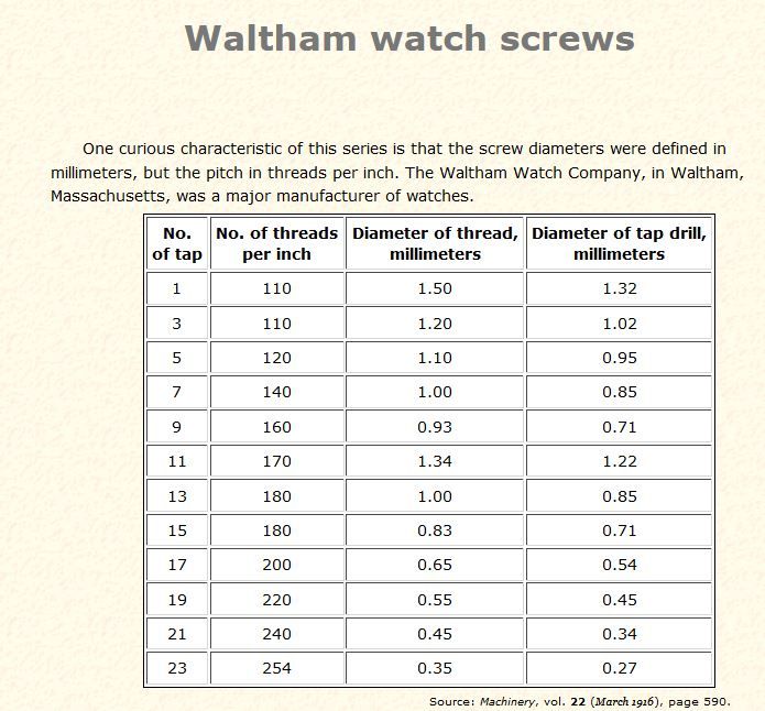

        Hi,
        I need to cut a very small thread for an old American watch. Best I can discover it is 0.6mm and 200 tpi.
        I have a Hercus lathe and an 8mm wolf Jahn (no lead screw).
        The gearbox on the Hercus can set to 192 or 208 TPI, My initial thoughts were to put the gearbox at a smaller number such as 50 or 100 and use change gears to hit the 200. But the gearbox neatly brackets all of the obvious numbers.
        I know this is going to be a real fiddle and is very small so will take a few gouges, but can anyone give me a start on the pitch please.

          Good luck screwcutting something 0.6mm diameter. With a core diamter of under half a mm there will be a lot of flex there. Can you not buy a die from watchmaking suppliers?
          Back to change gears though, for our US/UK readers, the Hercus is an Aussie clone of the South Bend, so would probably be same gears also as the Boxford?
          You may have to sit down with an online change gear calculator such as the one at littlemachineshop.com and the list of gears you do have and see if it can be done. You may have to use compound gearing though, which can get complicated.

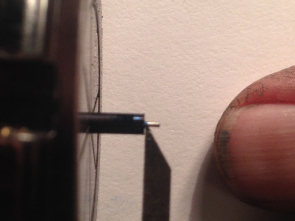

            After 3 tries I managed to make a couple of screws the right diameter with a screw plate that I do have on the 8mm lathe. However, the pitch did not match. The big trick seems to be to make the OD with a hand graver so no stress 😀
            A close look at a book on threads indicates that all of the makers seem to have their own 'standard', with the Waltham being the target here. I have not been able to locate a Waltham screw plate yet, and don't want to re-tap the watch plates to match a metric thread which I am sure I can do.
            There is no real rush, I may have sourced a couple of screws but they have round heads so are not quite right. Would like to get a range of plates, but suspect that will be pretty hot and miss. Any help on suppliers in that direction would be appreciated also.

                      Went through the box of stuf I have never used, never done a metric thread before, and doesn't look like the 100/127 set has ever been used. The setup needs a spacer with key way behind the screw wheel that I don't have, so need to make that first, otherwise, going well.
                      I used the screw plate I have with a tailstock runner to keep it square. The only problem was trying to get the right starting diameter and a nice square shoulder with the graver. The screw has afinished length of only about 2mm, so I started with a bit over 3 to get it running well. It's not that the screw plate did not produce a good thread, just the wrong pitch and I have been unable to source a Waltham plate.

                        ​However, I'm afraid I don't agree with you on the conversion of 200 tpi to metric. 200 tpi has a pitch of 0.005 inches and in metric measure that is 0.127 mm, not 0.6 mm.
                        I would be inclined to use the 208 tpi setting, after all the error is only 4% which on such a small screw with short threads may not be a problem

                          Brian, pitch is 200tpi, screw diameter 0.6mm
                          #298537
                          mark smith 20
                            @marksmith20
                            Isnt 0.6 or according to this chart 0.65mm the diameter of the thread not the pitch??? Sorry if im wrong as i dont know about so fine a screw threads.

                                ​Thank you for the correction, it was the way it was presented with mixed dimensions that threw me. I still stand by using the 208 gearbox setting though, would that not work on such a tiny short screw?
                                ​I was not aware of the Waltham chart for these fine pitches having never needed it.

                                  That chart is the same data I used, just a different source. I should have been more precise. The one I am shooting for is size 17. With the minor diameter determined by turning a short length until it just fit into the tapped hole in the plate. I got the best result from the screw plate with an OD of 0.6, But wrong TPI, assume because of the same deformation experienced with larger dies. I expect to start with 0.65mm when on the lathe.

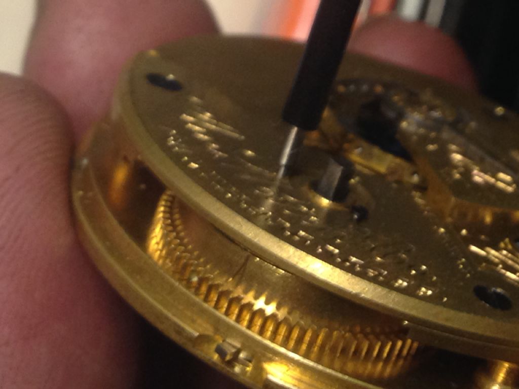

                                        Thanks to all, success.
                                        The OD is a little undersize (.63mm vs .65), and I could have come closer to the shoulder if the LHS of the tool was finer, but this will work when I finish off the head. Saw wont touch it, so will need a screw head file.
                                        #299097

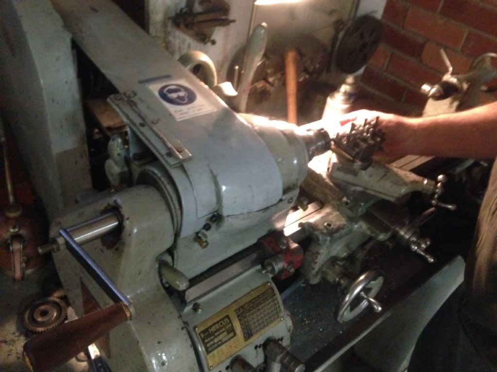

                                          this was all done on the Hercus with HSS tooling honed using fine Arkansas

                                            looks like a good job David. I wouldn't have thought you could do something that fine on a Boxford, Hercus etc.

                                                ERcollet chuck on the spindle nose – a commercial version of the one Harold Hall describes, careful attention to centre height and to sharp tools, and no cut larger than 2thou. I do have a few things to sort, such as not over heating the steel and being able to use a saw to cut the slot, but will get there.
