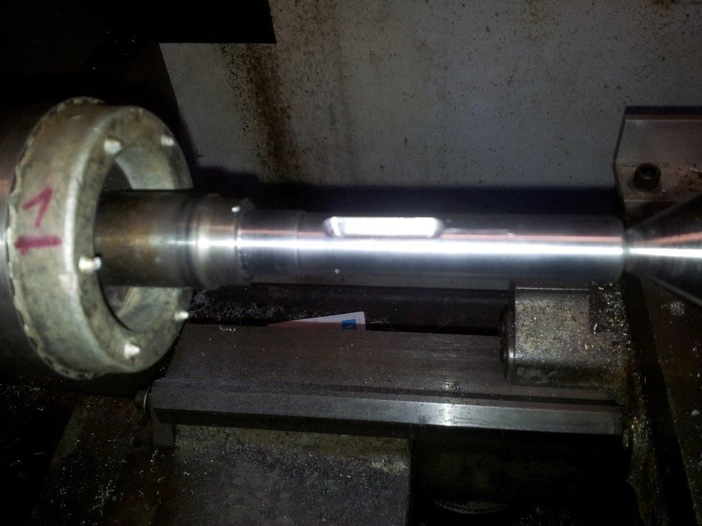

              Simon Williams 3
                @simonwilliams3
                A matching keyway in the cone pulley, throw it back together, nice and true BUT IT STILL KNOCKS!!!!!
                Stripped the motor again, to find a very small mark on the outer of the rotor, and a corresponding excresence of something hard and nasty that doesn't belong in the stator slots. Clean it out, all back together and runs as sweet as a nut.

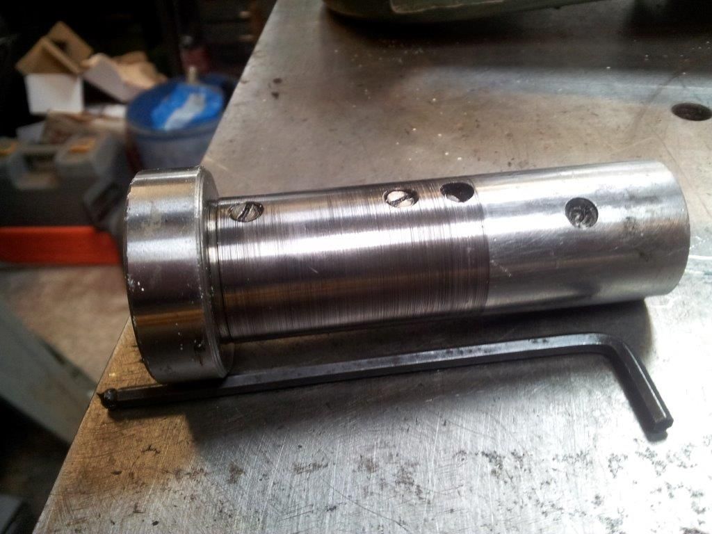

                                  Hi chaps, from memory I bought two needle rollers with their external sleeves OD 1.625 inches. They were 0.625 ins long each and were a perfectly standard catalogue item at my local bearing factors.
                                  I also bought two matching hardened inner sleeves, the internal diameter of which was (from memory) 1.000 inch. I chose these because that was the outside diameter of the driver sleeve – with the key way up its middle.
                                  All of these proprietary parts came from my local bearing stockist, but they had to be imperial dimensions because the starting point is that the hardened inner sleeve must be a snug fit over the original (damaged) drive sleeve.
                                  I then made a short spacer 1 inch ID by approx 1.3 OD and 0.25 thick which went between the two bearing inner sleeves to space them vertically, and a PTFE washer which was about 2 inches OD which went over the outside of the needle roller outer below the pulley to make sure the pulley and casing couldn't contact each other. This PTFE washer was about 2 mm thick, it had to be slim enough that the bearings were left with some endfloat when the driven pulley was correctly positioned on the drive sleeve. I know PTFE is self lubricating, but I greased this liberally on assembly. I can't remember what ID this washer was, but it was to clear the OD of the inner bearing hardened sleeve.
                                  Now I bored out the original milling machine top casting to accept the OD of the bearing assembly – I wanted it to be a nice snug fit so bored it out to 1.624 as close as I could get it. This stage is shown in the pictures above.
                                  Now I assembled the bits, bearing (no pun intended) in mind that the driven pulley is an interference fit over the drive sleeve and needed heat to expand the bore. The two hardened inner bearing sleeves were loctited onto the damaged outer of the driven sleeve (with the keyway up the middle) with the 0.250 thick spacer between them.
                                  Pop the casting and driven pulley back on top of the milling machine head, and replace the motor, drive belt and anything else I've forgotton, switch on and admire.
                                  I rather fancy that the factory version of this as shown above uses a double row needle roller bearing, but I used two separate bearings with a spacer to get the same result. I didn't know that there was such a thing as a proper factory fitted bearing, I was making it up as I went along.
                                  HTH, hopefully I kept some sketches of the bits I made in my notebook (and I can find them) so if they would help I go looking for them. It's all pretty obvious once you've got the bearings in your hand.

                                    I have just thought of a possible problem with needle roller inner sleeves.
                                    1. Getting sleeves that slide over the unworn part where the pulley fits. If you could, then one of the Loctite sleeve and bearing retainers would hold them.
                                    2. If the OD of the spindle driving shaft has to be reduced, there may not be much wall thickness where the keyway is. If that was ok, there is now a problem with the bore of the pulley being too big.
                                    If you have the means of producing a keyway, then a complete redesign of the spindle drive shaft is possible, and would be the best solution.
                                    I noticed that Simon Williams has a lathe with enough swing to enlarge the bush hole. I could have also modified that hole, but only because of having access to another, working, mill.
                                     The two needle races in the museums machine are only held in a plain bore by friction, they are fitted from either end leaving a gap in the middle. So far, there have been no nasty noises to indicate they have walked, despite using a 1hp motor rather than the original 1/2hp one. Because of the extra power driving the R8 spindle, I milled a second flat on the shaft at 180 degrees to the original and have two drive grubscrews, with backup locking grubscrews in the pulley.
                                    Edited By old mart on 23/01/2020 19:55:51

                                      Old Mart – you're quite right to be concerned about the damage to the driven sleeve outer surface from running in its bronze plain bearing. I sat and looked at this for some time before committing to the procedure described above, but decided that I had nothing to lose as making the driven sleeve was beyond me. I can cut short keyways, but this one is the full length of the bore of the driven sleeve, and is about 3 inches long and maybe 1/8 wide. I didn't rate my chances of making a slotter tool to do that.
                                      So I'd read on here of someone using the viscosity of the Loctite to centre two pieces together, and decided to give it a go. The wear on the driven sleeve outer was only a couple of thou, so it worked out fine. I expect I used bearing fit Loctite and left this assembly to set with it sat on its end – all's well that ends well!
                                      As for reducing the OD to clean up the damage – that's not going to happen as the wall thickness over the keyway is tight, if that's the right adjective to use. Not sure it isn't hardened as well. Besides, you'd need to work to commercially available bearing sizes – next size down would be 25 mm dia if such a thing exists, so that means taking 8 thou off the wall thickness.

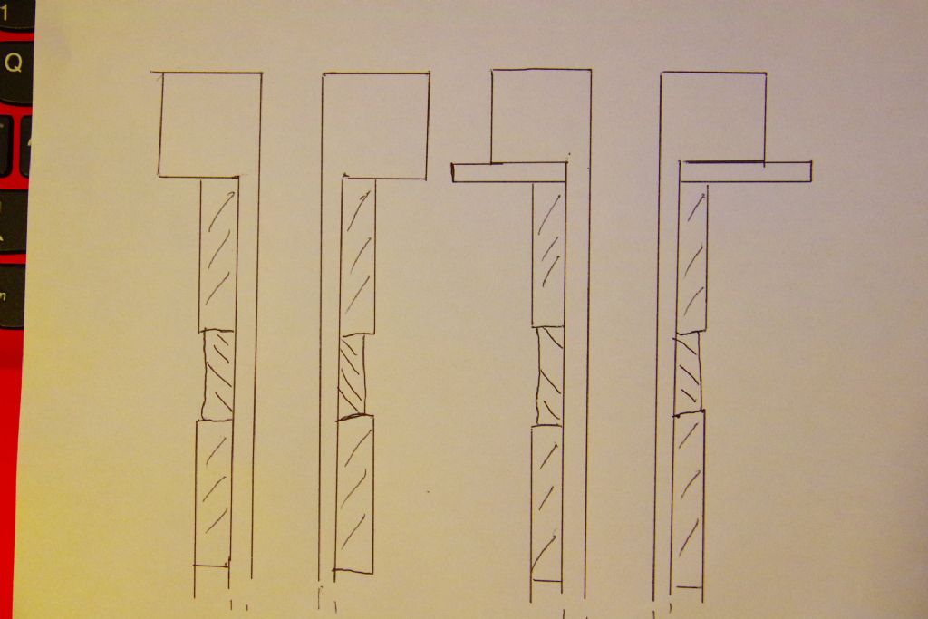

                                              Regarding the bearing sleeves fitted to the drive shaft, I would have turned the thickness of the large end down and fitted a larger diameter thrust washer of the same thickness before fitting the sleeves.

                                                Old mart Is your drawing the wrong way up? as my sleeve goes in from underneath and the small end of the drive sleeve is where the pulley is attached.

                                                  #448880
                                                  old mart
                                                    @oldmart
                                                    I never thought about which way up the drawing was when I posted it.
