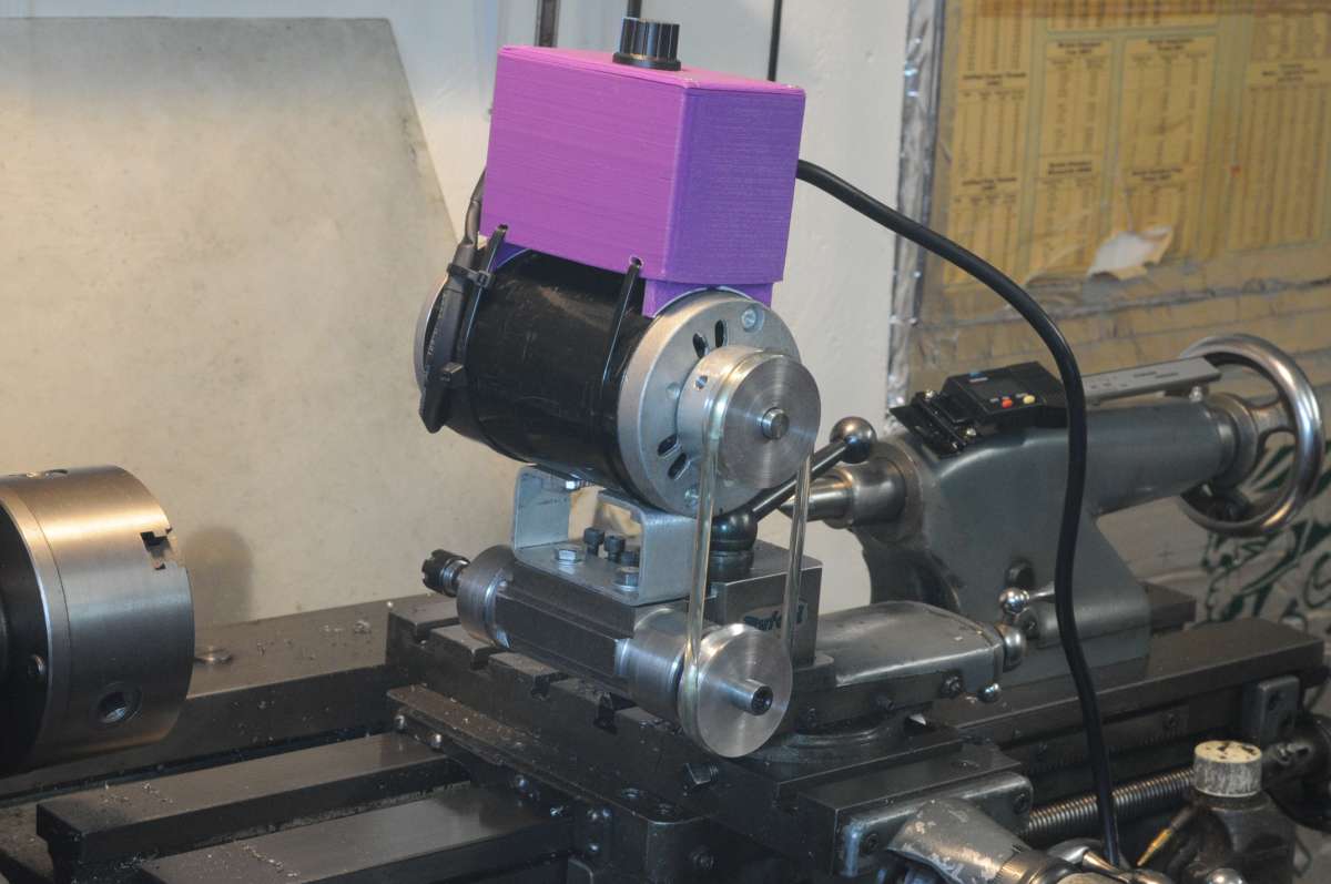

                Roderick Jenkins
                  @roderickjenkins93242
                  I used a 200W 220V DC Treadmill motor and speed controller.  I purchased it from hebdenmotorbits on ebay.  Sadly, they don’t seem to be offering anything at the moment.  Has plenty of torque and it drills and mills up to 1/4″ in steel, bits held in an ER11 collet chuck.

                    #716527
                    Greensands
                      @greensands
                      Hello Rod  – Your arrangement and motor selection is exactly the sort of thing I have in mind. I will certainly keep a look out for that particular model.
