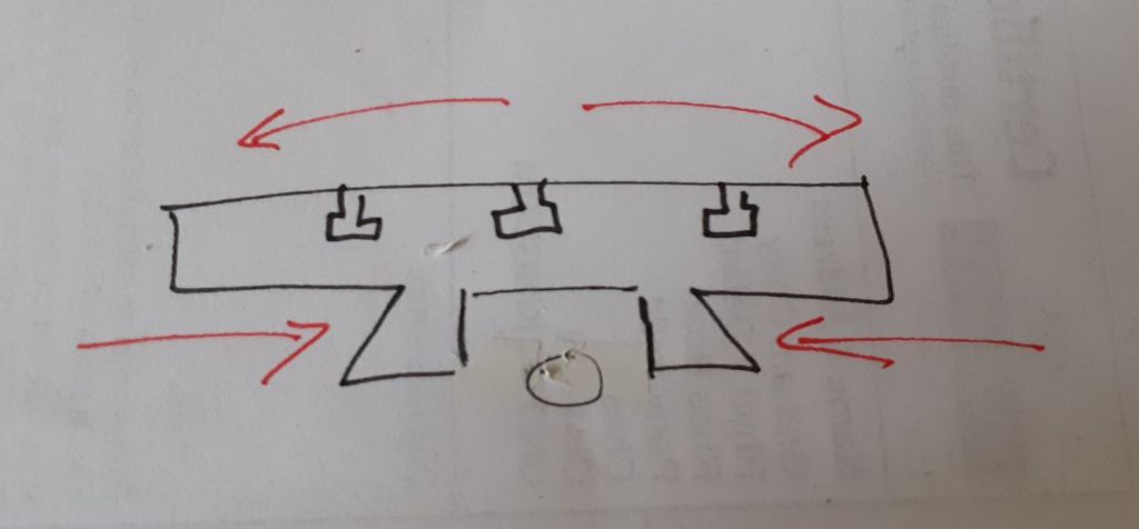

                                        I spoke to a machine shop engineer who asked me to check the gib adjustment.
                                        I found to my surprise that the largest error at the top of the 'hump' (across the y axis) increased by about 0.02mm when the gib/X axis lock lever was applied.
                                        I then remove the X axis gib and the error immediately decreased from 0.15 down to 0.05. (The gib is a tapered type with a lateral adjusting screw at each end).
                                        What I fail to understand is how the gib seems to be causing the table to bow upward. I assume that if excessive pressure was applied by the gib and/or the lock lever, this would have the opposite effect; in that the force applied would in effect try to 'spread apart' the tables own dovetails and hence force the table surface to distort in a concave manner?

                                                  #641976
                                                    Posted by Dave Shedman on 20/04/2023 09:07:48:
                                                    An overtight gib on the x-axis will squeeze the two dovetails of the table together on the underside and therefore cause the top surface to bow
                                                    Edited By JasonB on 20/04/2023 13:23:45
