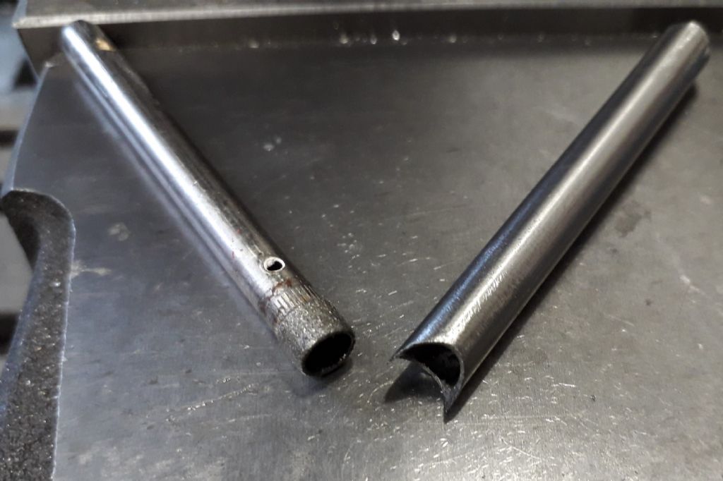

        I did try a diamond coated holesaw a while back when someone wanted to cut thin wall stainless tube and avoid something with coarser teeth catching on the thin metal but doubt you will get anywhere fast with them in solid metal at the sort of sizes you are looking at. Easler to work up through twist drills 6, 8, 10, 12 and then boring bar.

            I use the diamond coated ones for work quite a bit upto 50mm on glass, stone and ceramics so know how they work, they seem to drag and clog on metal so not ideal.

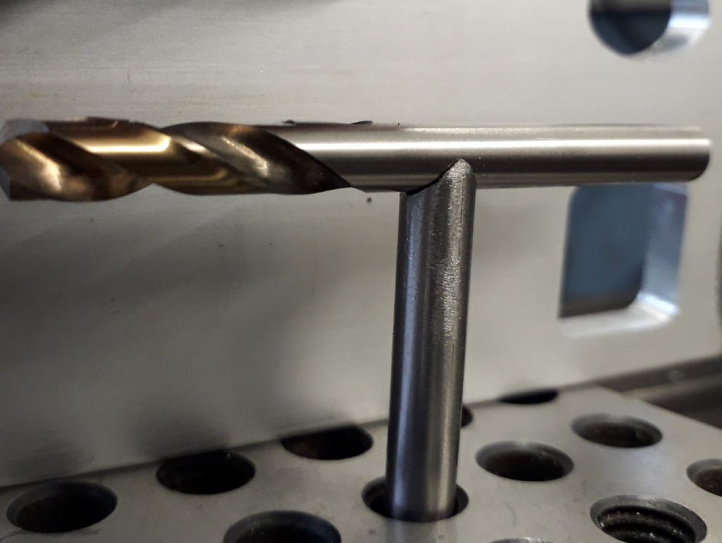

                #428302
                  These were the photos I took of one cutting stainless tube
