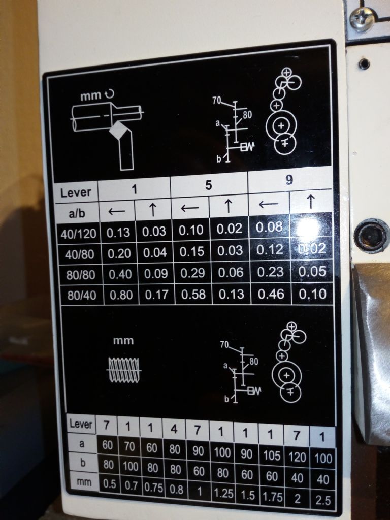

          You got a hand book with your DB10, wow they've raised their game.
          If you let us know what thread you are trying to cut it will help in deciding what gears you need to use, below is a picture of the gear settings on my DB10.

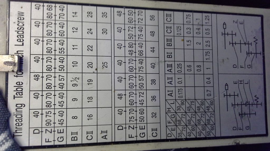

            Depends on which DB10 there's Ian's as above or there's the older DB10G like mine. Imperial or Metric machine? Mine had some kind of "manual" which was less than useless, threading section was a waste of ink, no explanations whatsoever.
            Easy enough if you follow the plate, I've only done metric threads on my imperial machine, you have to leave the carriage feed engaged for metric with an imperial machine not use the thread dial, others will say there is a way round this but it's no real problem to leave it engaged..Left hand set up figure is for metric, right hand for imperial. Picture was right way up, the album has put it on it's side…sorry
