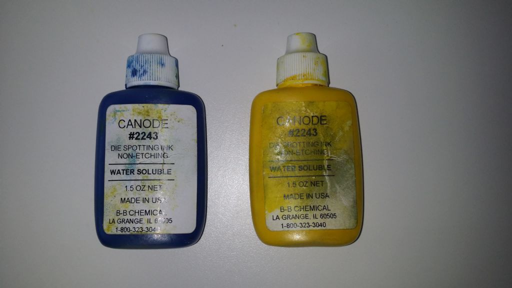

              Hi,
              I am using this:**LINK**
              It is water based. So easy to clean and keep the blue off of other things. I find it is different enough to the stuarts micrometer blue that you'll have to experiment a little bit at the beginning. I don't get on well with the stuart's too messy and harder to get a good print.
              Having said that I have no idea where to buy that volkcorp product in the UK. I think it is not CE marked so I get it hand delivered from the USA. The other option for water based is the "dykem high spot". Again I got mine via the USA.
              I have some yellow ink as well as the blue. This is used as a highlighter and it makes seeing what you are doing easier when you get towards the end of the work. These USA options are well referenced over on the PM forum.
              Having tried the water based I wouldn't ever go back to the Stuarts. They don't last forever though after a few years the die seems to collect into tiny pellets and it spoils the prints.
              It would be nice if some enterprising company started to import the water based solutions.

              Edit – to add a picture of the water based spotting ink

                                                    You use the yellow high lighter by putting it on the part you are scraping. Wipe on a very thin coat. It should be dry to the touch. I.e. not transfer over much if you touch it. I use an old cotton rag to wipe off any excess. In fact most of the time there is enough yellow on the cotton rag that I use that to apply it and wipe off excess. Plus I use my hand to wipe over to make sure it is nice and evenly applied. Your hand is very sensitive to feel for any contamination as well. So I always rub my hand over the yellow or blue. That is another reason why it is nice to have a water based ink. Having said that I seem to have some blue stain on my hands most days.
                                                    Then when you present the part to your plate and blue it up, the blue is much easier to see. I use this when the blue is starting to get to very small dots (i.e. when going from 30 PPI and getting close to ~40 or greater PPI). I also use it if I have a high spot problem that I can't easily see.. I.e. I put the yellow on the part. Then I present it to a clean granite plate and "polish" the part. The high spots are polished such that all the yellow ink is rubbed off the high spots. This makes it very easy to see the offending spots. Again when you are getting close to finished on a high PPI job a couple of rogue high spots can make it look like your going backwards. It makes all the difference to spot them easily and this way you can identify them and bump scrape them off, and then re-print the part.
                                                    Of course it is enough to do that with no ink as the high spots get polished by the granite anyhow. All the yellow does is simply make it easier to see what you are looking for.
                                                    I have found that everyone I've met or discussed the use of the water based inks with, that have tried it, prefer it to the the stuart's. Of course it is not essential, it just makes the job easier and also easier to clean up afterwards. DAPRA amongst others sell it in retail in the USA. Recently I have been told that the BIAX dealers around Europe are starting to sell it. I've not asked **LINK** who are the UK BIAX dealers.
