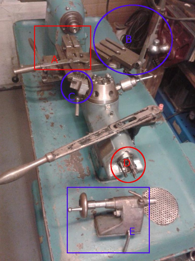

      A little while ago, I acquired a Schaublin lathe, does anyone know what function the thing in front of the Capstan is for?

          [assuming that by 'in front of' you mean 'nearer the headstock']
          A lever operated slide; set up for cut-off and chamfering it appears.
          Sorry, I don't know Schaublin's specific name for it.

              Hi,
              If you mean nearest to the viewer it is a screw operated tailstock….

                I followed MichaelG's link to the Schlaublin 70 catalogue of 1971 and was impressed and bemused at the massive range of accessories and configurations available for this lathe. What a super bit of kit!
                Can someone confirm my tentative identifications please:
                Red Square 'A' – a lever operated tool-holder mounted on the cross-slide.
                Blue Circle 'B' – a lever operated tool-holder mounted on the cross-slide for making circular cuts?
                Blue Circle 'C' – a basic tool-holder? mounted on the lever-operated capstan tail-stock.
                Red Circle 'D' – adjustable stops to limit movement of the capstan, if so why are there 4 of them?
                Blue Square 'E' – ordinary screw-operated tail-stock normally fitted in place of the capstan tail-stock.
                Clearly a versatile precision lathe that must have cost a fortune new. But is it a good lathe for the average Joe? The attachments would be brilliant for repetition work but wouldn't they rather get in the way for general hobby use? My experience consists mostly of making a series of one-offs, each involving several operations on an ordinary lathe, that wouldn't benefit from levers and capstans. Pairs of items aren't that unusual, but I don't think I've ever made more than a dozen copies of anything, and they were only pillars. Is my hobby experience typical or is everyone else busy doing lots of repetition work?

                  A – Lever operated topslide with a tool post on it
                  B – Rear topslide with vertical feed lever as horz would hit the bed, set at an angle for chamfer or similar cuts as per MG
                  D – There are six holes in teh stop one for each turret position but not all have the screw stops in them.
                  Screw cross and top slides would be better for general hobby use, the read slide could be kept as a lever feed for a rear parting tool.

                    Probably not but I have long thought that a (sensitive) lever-operated cross slide would make parting off easier.
