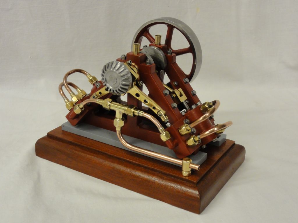

              Well it will be upscaling i will be doing most likely, i see a design for a simple steam engine, but its a bit small for my machines and i prefer larger models anyway.
              #402175
              Jim Nic
                @jimnic

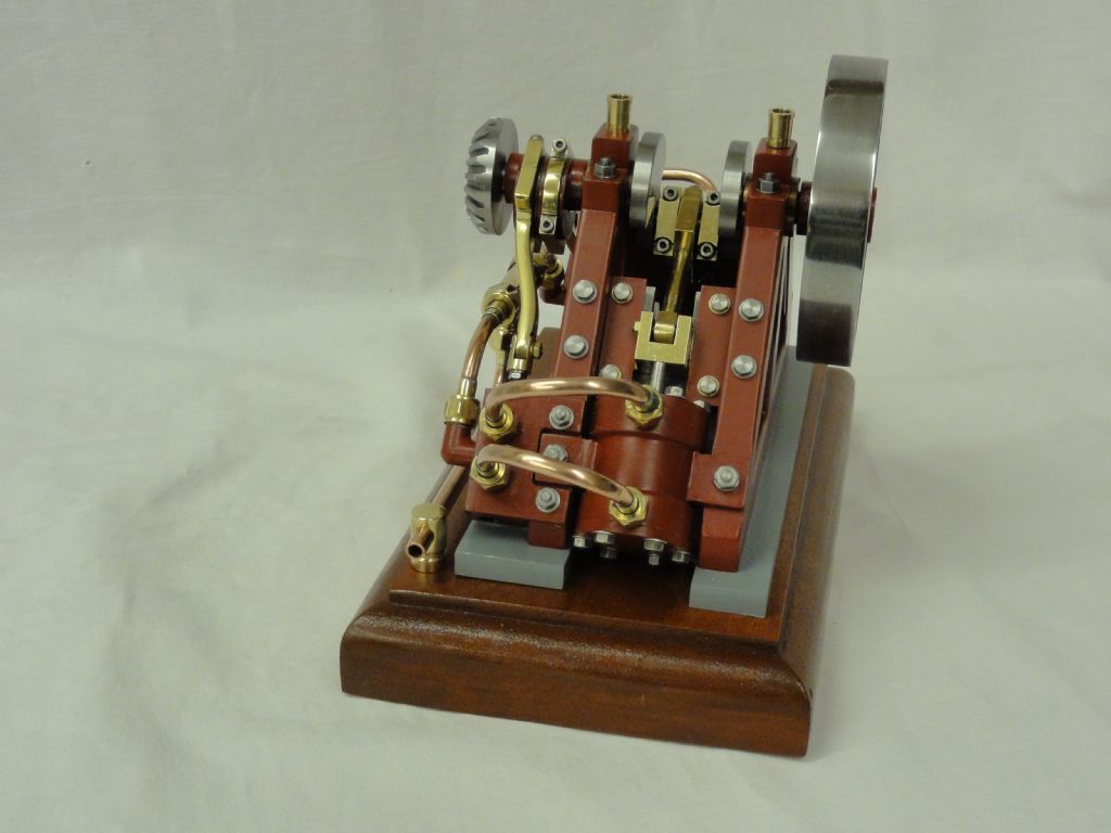

                I scaled up this Mogens Kilde designed Double Diagonal engine by two by simply doubling the drawing dimensions and found that while most aspects looked OK at twice design size, the fasteners most definitely did not. Bigger – yes, but not twice as big. I actually used BA fastenings instead of the metric called for on the drawings and just chose sizes I thought would look right and took the view that for an air powered model whatever I chose would would be strong enough.

                  Posted by ronan walsh on 25/03/2019 20:04:39:
                  Is scaling a drawing up or down a simple matter of multiplying or dividing the given dimensions by a set figure, say 2x or 4x ?
                  Or is it as i suspect more involved than that ?
                  In principle, but you may find things start to look a bit chunky, especially fixings. Also as Jason says, convenient stock sizes may not be available.
