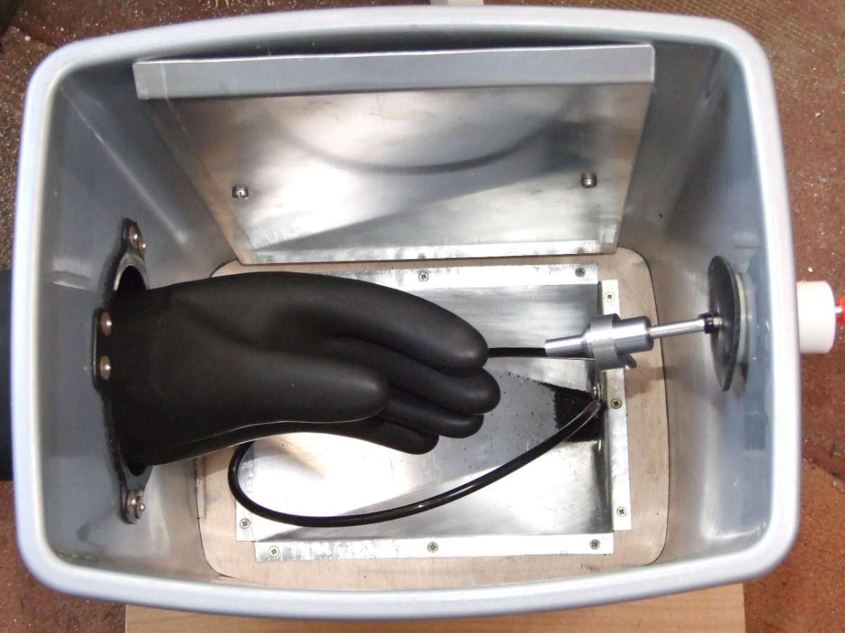

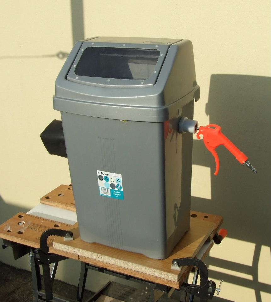

                When I built my small parts Blasting cabinet,
                Air control, Std Air Duster.
                I relied on a gravity feed for the media, the pick-up pipe is anchored vertically above the sump. The end of the pipe is cut off at an oblique angle to help stop blockages.
                All the workings, sump pan directs media to suction pipe. Filter protection Baffle at the rear also reflects light from the LED
                Regards

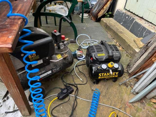

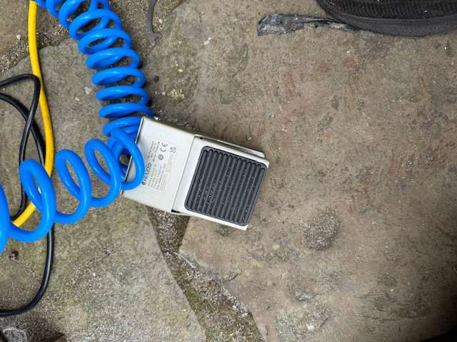

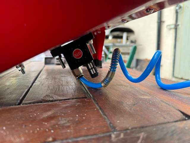

                    Well the vibrator arrived a small less than 2 inch square and 1/2 thick device
                    coupled up to an air source and it vibrates like mad but gobbles air
                    bolted it to the base where the glass collects and connected it to a foot switch
                    so when blasting i can see if the pickup tube is visible i give it a quick press of the pedal and it vibrates all the glass level..
                    So thats that sorted for now

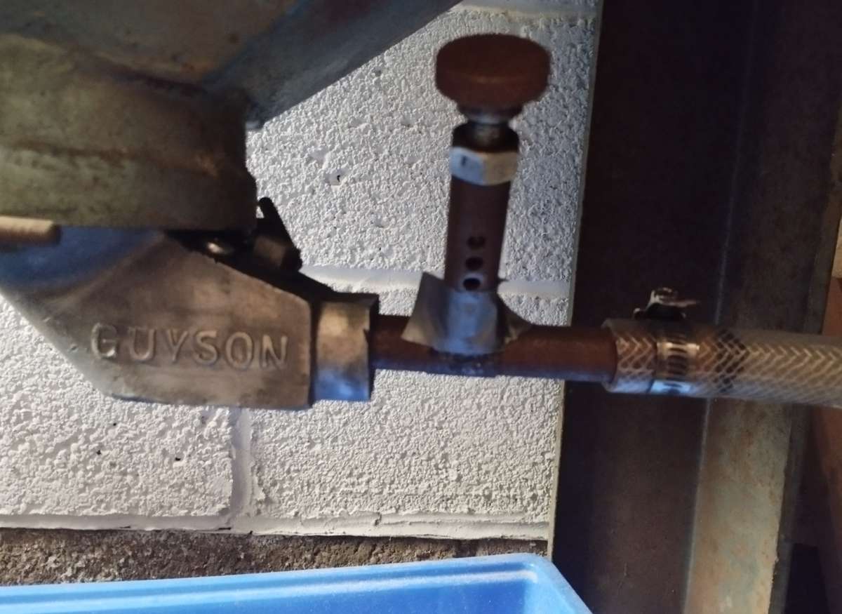

                                Not sure if the following will be of any use to the OP.   I have an ancient Guyson blast cabinet (and dust extractor) that I struggled to get working reliably.  I use steel grit.
                                It would pick up and blast for a couple of minutes then stop picking up.  Initially I thought it was a lack of air pressure.  Air pressure was not the problem, it now works well between 40 – 80psi.
                                Stirring up the hopper with a length of steel bar would get it going again, for a couple of minutes.
                                I played with nozzle sizes, made no difference.
                                On advice, I then emptied the hopper and refilled with a lot less grit.  That made a difference but would still not blast for more than a few minutes at a time.
                                I then found the American Guyson website.  Very much more helpful the the UK one.   It described a way of making a very simple regulator to control pickup by bleeding air in to the suction pipe.  Now, I can blast for as long as I like.
                                I find that I need to sieve the blast media fairly frequently, the suction side will pick up some big lumps of whatever I’ve blasted off that will block the nozzle

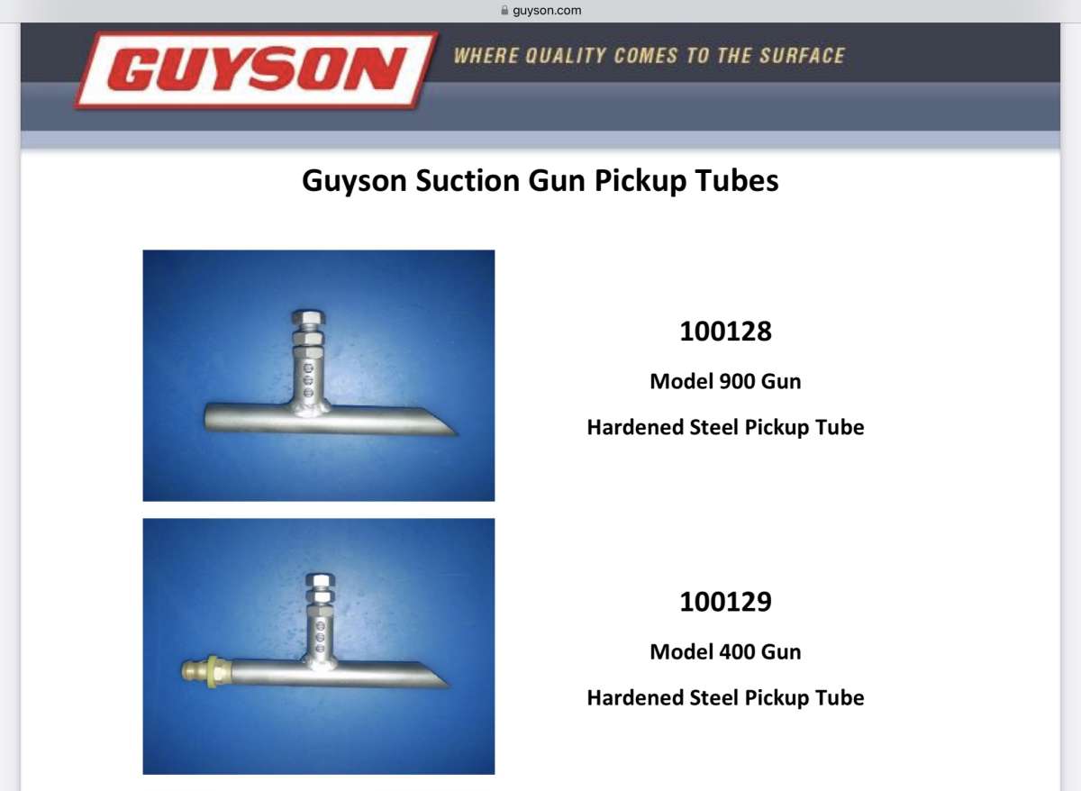

                                        In case it’s of help to anyone else. This is the Guyson Blog on media flow:
                                        SUCTION-BLAST BASICS: OPTIMIZING MEDIA FLOW
                                        Guyson Pickup tubes mentioned in the Blog.

                                          I don’t have a welder or any steel tube so it’s going to be fun for me trying to fabricate a pickup tube with similar functionality! 😆
                                          #742826
                                          John MC
                                            @johnmc39344
                                            This is a (poor) photo of the air bleed on my Guyson cabinet I made from the guidance given on the US Guyson website.  Works very well, wish I had come across the US site sooner, would have saved a lot of frustration.  The tape was a very quick way of blocking the lowest pair of holes to stop grit leaking out.
                                            The gloves Guyson supply are “industrial” Marigolds (I kid you not!) that are sealed by rubber muffs in the door.  Neither muffs or gloves lasted very long, the gloves split and the muffs went horribly sticky and fell apart.  Something like £80 to replace so I bought some thick long sleeved rubber gloves from the bay and fitted them into the door.  They have outlasted the Guyson supplied gloves and muffs.
