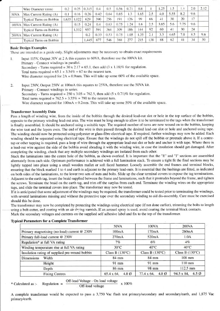

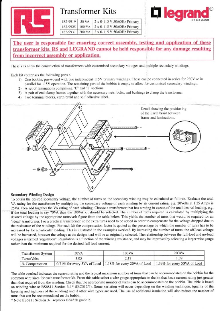

        Many years ago (at least 20?), RS used to issue paper "datasheets" on their products. One such product was a transformer kit. This had a pre-wound 240 volt primary winding and space for a secondary of your own choice. They no longer offer this product (EU regulations?). Does anyone have a copy of the original datasheet? I have no idea of the Datasheet Number but the RS Stock No. was182-9925. Can anyone help or do they have access to the old red/brown binders of the datasheets?
        Thanks.

                Here you go:
                I bought one of the kits many years ago but never used it.

                    Thanks John, I knew that someone "out there" would have a copy of the sheet available! All I have to do now is get some laminations of the right size (available from ASCO – https://ascocomponents.co.uk/ ) and off I go!
                    Kind regards,
                    The Mad Professor.
