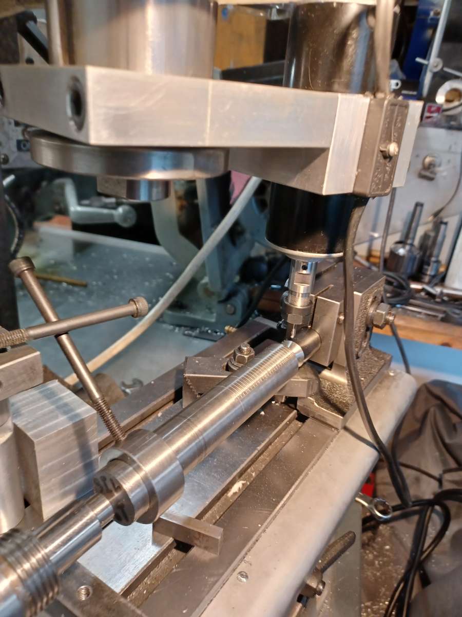

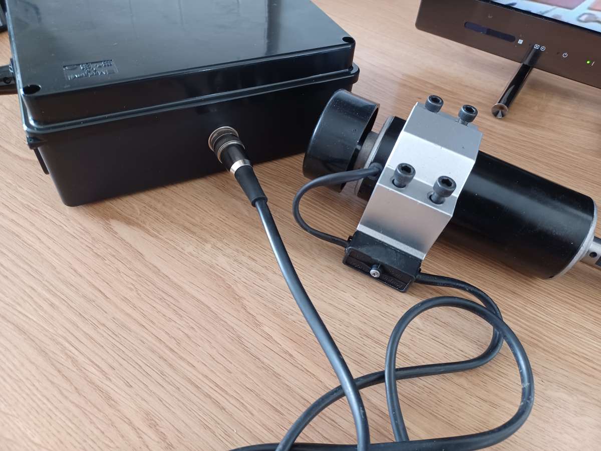

            David George 1
              @davidgeorge1
              Hi Steve welcome to the forum. When cutting with High Speed Steel cutters it helps to reduce the speed of both the spindle speed and the feed rate and the cutters will last longer. Also use a lubricant which will help to cool and lubricate the cut which will improve finnish. For aluminium I use parafin which is cheep from B&Q, cutting oil or coolant made from a concentrate and water for steel or similar. For brass I dont use anything as it dosnt need any and the same for cast iron which I have a magnet in a plastic bag which attracts the swarf but take the magnet out over a bin and the dust and swarf falls off. Bronze is better with a touch of cutting oil. I have ocasionaly had to cut with a very small cutter and instead of running my little mill at high speed for a long time, which may burn out the motor i have a cheep high speed spindle mounted in a bracket which clamps around the mill spindle quill and can run up to 10,000 RPM.
              20220717_12202220230205_223041
              David
              #714328
              Diogenes
                @diogenes
                Now his query has been ‘sorted’, I hope Steve won’t mind if I quickly ask what is it that you are doing there, David?
                #714354
                David George 1
                  @davidgeorge1
                  Hi Dioganes.  I am engraving a tailstock quill with a scale to mark like a rule on the outside diamiter with a carbide 3mm shank pointed cutter.
                  David
