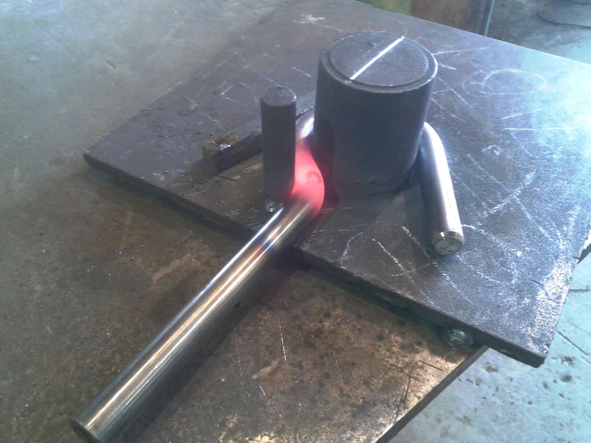

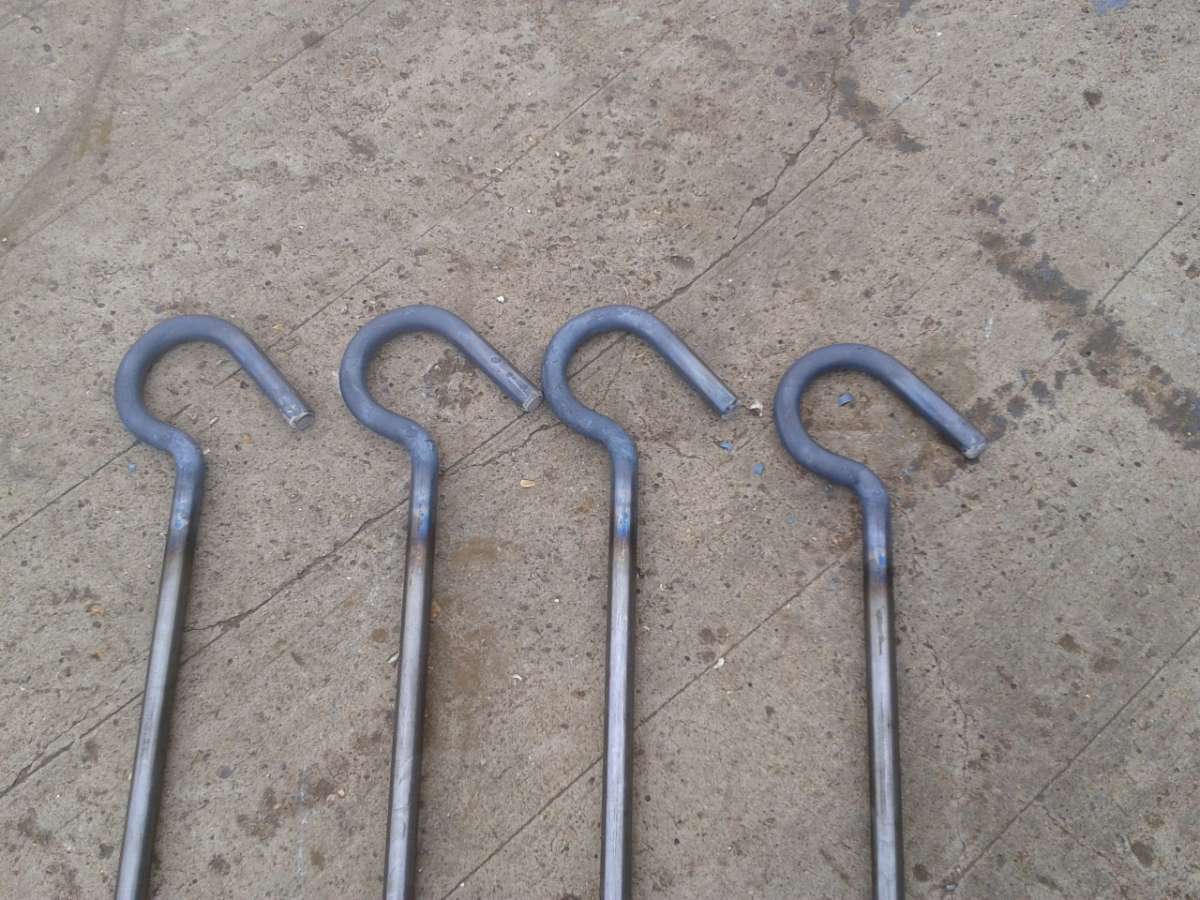

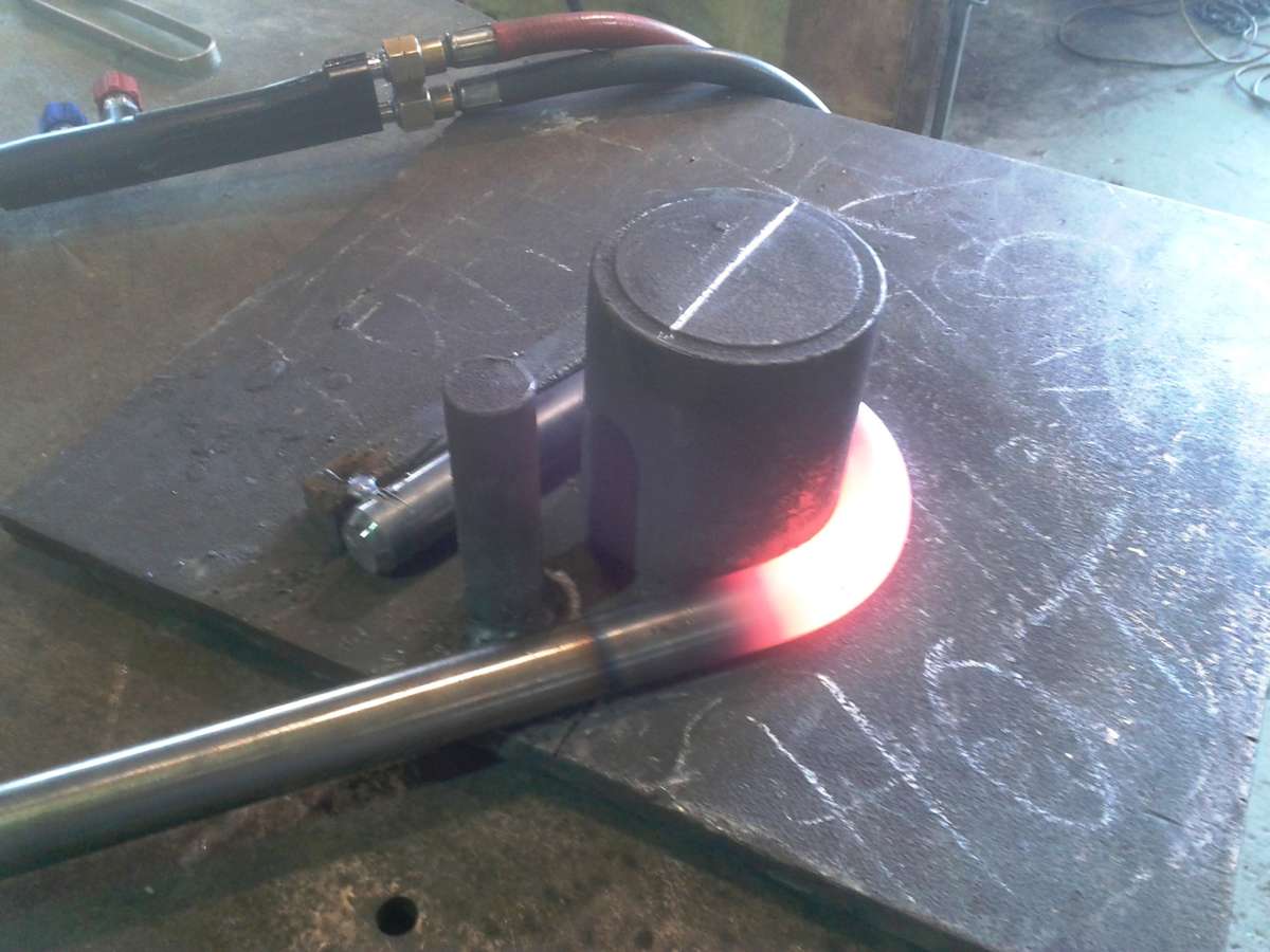

            Hi Trevor, yes you need to be a little specific as to what you need, but here’s one way of doing it.
            2018-07-24 12.10.30
            2018-07-24 12.14.57
            This is a sample hook that I made from 25mm EN8, in my last day job. I used to make these in batches of four, and they were about 1500mm long, and had other bars welded at intervals along the straight length.

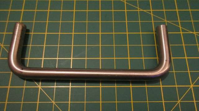

                            Hi, one of these would do the job Miracle Bender which is what I did the 10mm piece of stainless steel shown below on.
                            002z
                            It used about a 1200mm long lever. You would get a little tighter bend on 8mm bar, but not much, doing it cold.
