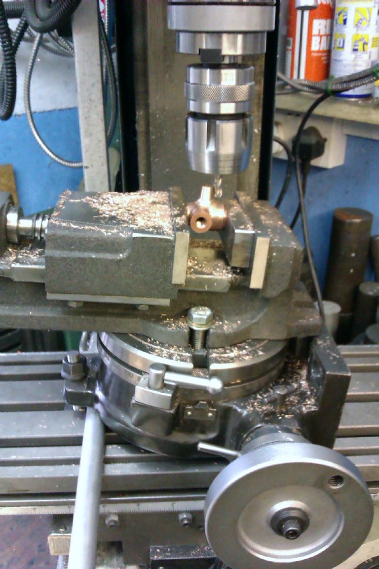

                      Vic – providing it does not interfere with the handle you can always extend the surface area with a disc of mild steel or even aluminium. drilling and tapping it for hold down bolts. and counterbored holes for cap heads into tee nuts to keep it in place.
                      Though I have yet to use it, I have done this on an 8" table with an ali plate to hold a flywheel rim.
                      Best – Tug
                      Here's an example (though smaller in diameter than the table) on the MES but the same principle. BTW a set of small clamps using cap heads for bolts are invaluable on RT set ups where space is at a premium

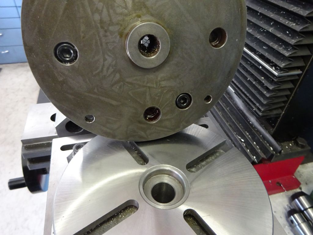

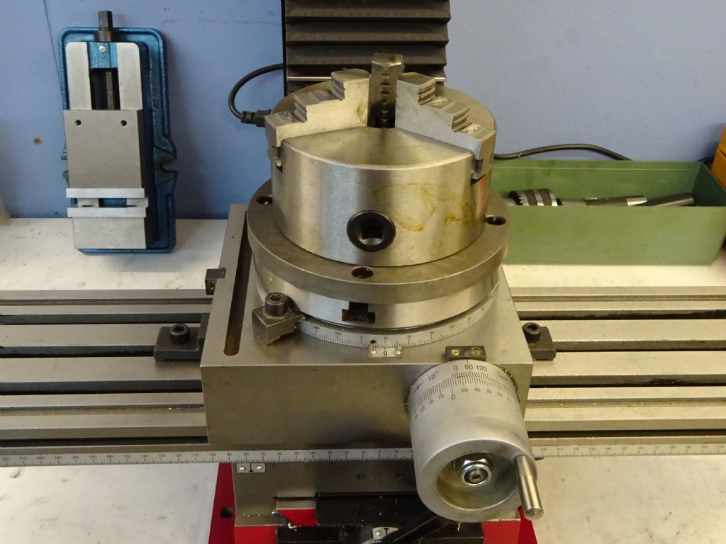

                                      I have two 3 Jaw chucks mounted on backplates that are a bit larger than the chuck body which allows the backplate to be held to the table with tee nuts, a spigot on the backplate to locate in the table's central hole make sfor easier set up.
                                      4 holes also make sit easier if you want to fit a vice to the table
                                      I would go with 72:1 or 90:1 on a rotary table as anything lower like 40:1 is better for dividing that curved cutting.

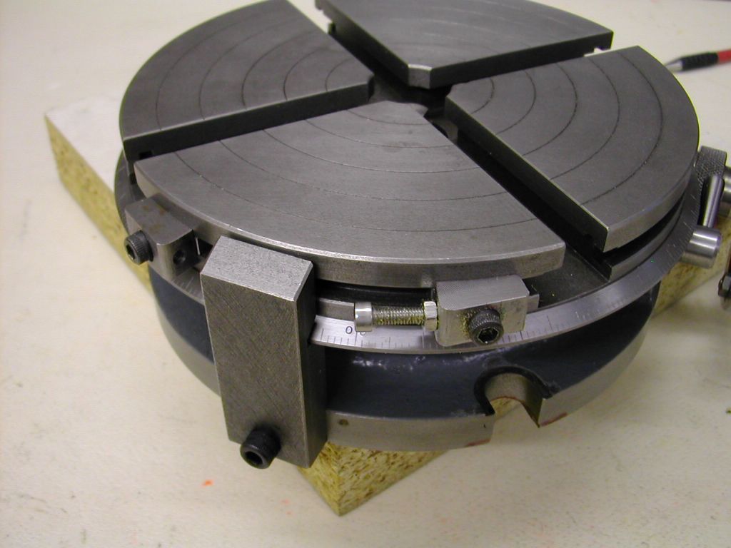

                                        Yep – Jason beat me to it but my set up is the same – chuck to plate, plate to table. Plate has locating spigot to fit table bore, chuck has locating spigot to fit a recess in the plate and the chuck bore.
                                        Ditto with the four versus three slots – four allows more versatile clamping of parts when using table alone. Buying a three slot just so the chuck can be mounted is limiting the versatility for something that is not used that often – well not on the R/T in the fashion shown. Both Jason and I have R/T's larger than the chuck body but you can still have a plate interposed even if the diameters are the same.
                                        Though I do use a chuck as shown its rare in comparison to sub plate set ups and four slots are definitely more favourable there.
                                        As said I made this R/T over forty year ago from a set of castings supplied by MES if I remember right. It has a 90 tooth wheel – four degrees to the rev each degree split into four. It has served me well over those years and is still used when required – just a week or so ago I made the expansion links for the marine engine using an ali sub plate to extend the diameter. It's done a six spoke steel flywheel in it's time – it carries out milling ops well if used sensibly. Most of it's use has been on IC engine crankcase profiling so it's been well used enough to base advice on.
                                        Those large tee slots however were cast in originally – anything but smooth so took a fair bit to clean up. I later added the degree ring and the stops – if there is one thing to improve an R/T it is to fit some kind of adjustable stop set up as they take all the worry of, and potential for, over movement to occur, something that's easily done on a R/T

                                              If it is any help, I fit a small 3 or 4 jaw Myford fitting chuck to my HV6 by mounting it on a 2MT /Myford arbor.
                                              The arbor is clamped into the taper by a M6 capscrew in a top hat bush
                                              Obviously, being a screw fit chuck, if using for radius cutting, the direction of table rotation / cutting forces need to taken into account, to prevent the chuck coming loose…
                                              So far, with Tailstock support, have had no problems with unwanted movement when cutting gears (Table face vertical, axis horizontal ) Since gear cutting involves a full depth cut with SLOW feed , this seems to have worked, so far!
                                              Have used with table face horizontal, to cut slots, and to graduate with workpiece clamped to the table.
