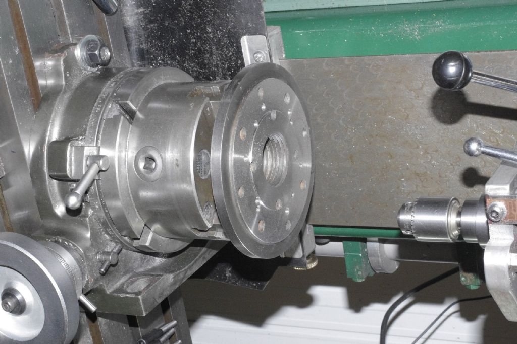

                                            Not wishing to be argumentative … just mentioning another approach:
                                            The lathe can provide an excellent alternative to mounting a rotary table ‘vertically’
                                            [i.e. with its rotational axis horizontal]
                                            For some users, it may be easier to add dividing and milling facilities to the lathe, and use the milling machine only with a low-profile rotary table.
