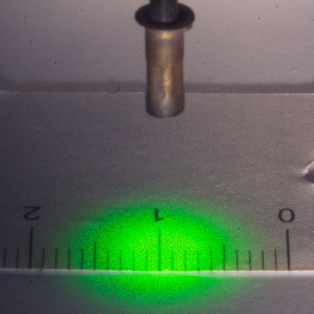

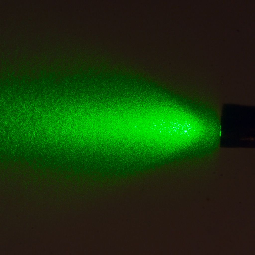

                                            Posted by MICHAEL WILLIAMS on 26/01/2014 21:50:51:
                                            Just quickly :
                                            (2) Ends of optic fibres can be cut off at any angle required . Square on and basic polish will make the spot described in earlier posting .
                                            Components for coupling light sources to optic fibres are available off the shelf now thanks to extensive use of optic fibres for communication cables and use of optic fibre/laser combinations in science research .
                                            MikeW
                                            Mike,
                                            You say:
                                            "Square on and basic polish will make the spot described in earlier posting ."
                                            Forgive me for responding in my best Pantomime voice:
                                            … "Oh no it won't" …
                                            As I referenced earlier; the light exiting a circular Fibre Optic light guide with a square-on polished end will be a diverging cone with an included angle of [typically] 68 degrees. … This is also the acceptance angle at the input end [assuming, in both cases, that the other medium is Air].
                                            The light guide in the two pictures below is a 1mm diameter multi-fibre bundle, in a 2mm plastic sheath; and the ferrule is just under 3mm diameter. The bundle is Epoxy-potted and finely polished [they were made by Schott; so the quality is pretty good].
                                            The light input for these pictures is a Green LASER pointer.
                                            First; the exit angle:
                                            Now, the spot size, at a distance of 10mm
                                            As you will see; this is not a 1mm spot.
                                            … If you want the small spot size, you will need additional optics. … It's all "do-able" but can quickly get complex and expensive when compared to a Pound's worth of LASER Pointer.
