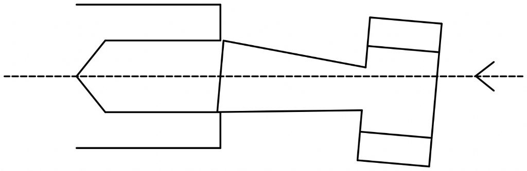

                      Also interested in this as it is on the list to try. Surely though, the broach should not “wobble” when rotated, merely rotate on an axis one degree displaced from the rotation axis of the work. Presumably also the broach is advanced along the work axis, not its own rotation axis.
                      Edited By Macolm on 02/07/2023 15:37:58

                                      The principle is very simple. If you look at Malcolm's sketch you'll see that the bottom edge of the tool is inside the hole and the top edge is outside. This means that the point at the top will be more to the left when it's made half a turn to get to the bottom. The end of the broach is the cutting face and it plows the metal into the hole as it turns. All you have to do is push it.

                                        As Peter says the principle is very simple but perhaps more easily understood as the action is akin to skiving with a wood chisel type action.

                                              If it's in the tailstock try moving the tailstock off-set a tiny bit. If you were looking at Malcolm's sketch above move the tailstoks off-set in the downwards direction.
