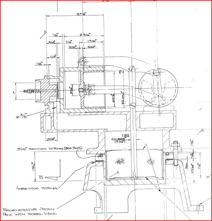

                              Thought I had it tucked away somewhere, this is the section through the Alyn Robinson engine which is a close representation of the full size, you can see the valve, wire wool fille dregenerator and all the properly cored passages unlike some models that you have to drill achieve the same effect. Graham had/has access to a lot of full size engine so his models are true to teh originals.

                                    Thanks for the extra info, especially the dimensioned drawing.

                                            Very useful information, I've been searching for a year and drawing my layout,I was just about to start but will now have yet another think. As far as I can find out the smallest real engine was 7 1/2" bore, I'm making mine 1/3 scale, so 2 1/2" bore. I found a brass beer pump with this bore, so that fixed it. All the photo's Ive found are different, some have the throttle valve and some don't. Some have the water tower, I'm assuming that is what it is. Jason- do you have that dimensioned drawing with the cut -off dims' ?

                                                The Alyn one is based on a No4 engine which had 4.5" bore so their 1/2 scale model is 2.25" bore.

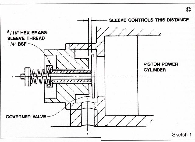

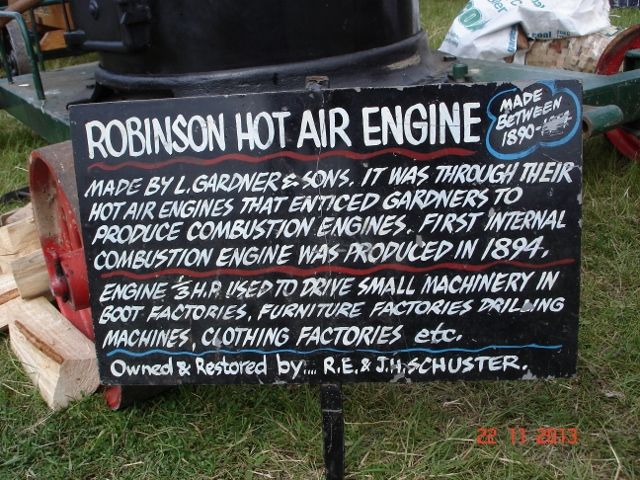

                                                    dsc00730 (640x480).jpgThe Robinson based in Christchurch NZ has a 10" bore. dsc00729 (640x480).jpgIan S C robinson govenor valve (640x468).jpg

                                                      Thanks Ian, so the vertical 'box' is a radiator.
                                                      Seems the valve can be either sprung or worked by a Watt-style governor.
