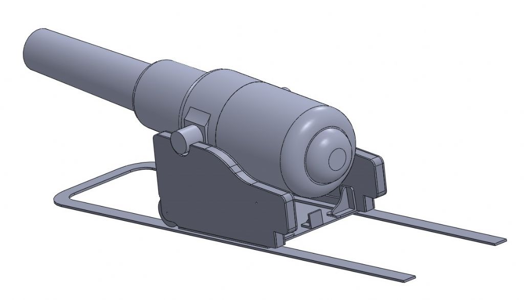

        Hi
        I thought I would start a thread on the latest piece of artillery I am hoping to model. Progress will be a bit slow I'm afraid as I have quite a few distractions at the moment, however I'm hoping that putting this on here will encourage me to pull my finger out and get on.
        For any enthusiasts it will actually be a Mark 4 barrel. The carriage will be a Garrison Casemate or Dwarf sat on top of a Dwarf A Pivot Slide. Its going to be about 1:12 scale so the barrel will be about 12" long as that is about as large as I can handle in my lathe.
        At the moment I am slowly producing a CAD model of it so I can get a few bits cut such as the carriage side plates.
        I hope at least one of you might find this interesting. Thanks.

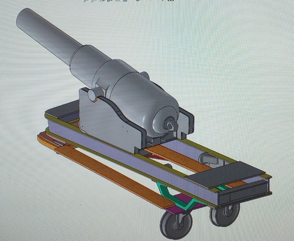

                I've also got a photo of a gun in New Zealand which claims to be a mark 4 but it could I suppose be the similar looking 2. Anyway here's the progress so far.

                    Quick update, I have made a bit more progress on the slide. I thought there wasn't many bits in one of these but that was a mistake.

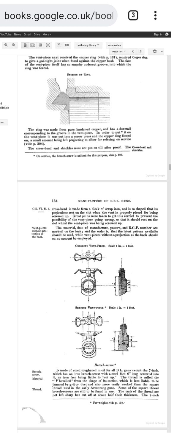

                      My son has just started making one of these 7INCH Gguns. He is short of some details. Do you have any Breach block details please or is yours a muzzle loader.
                      #567203
                      Buffer
                        @buffer
                        It's a muzzle loader. But let me know what gun it is as I may have a drawing.

                              If you do a Google search of ' constructure of ordnance 1877' the first item my phone shows is treatise of construction ….1877. This has many drawings and details of that gun and its breech block. It's a free ebook for you to download.

                                  Thank for your assistance, I have download the book.
                                  Ian

                                    Well I managed to make a bit more progress on the Cannon, mainly rivet holes.
