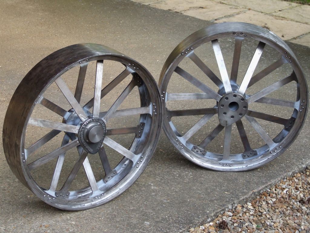

                I've recently almost finished riveting my traction engine wheels; two rear wheels to go. For scale the following are 3/16" steel rivets. First you need to practice:

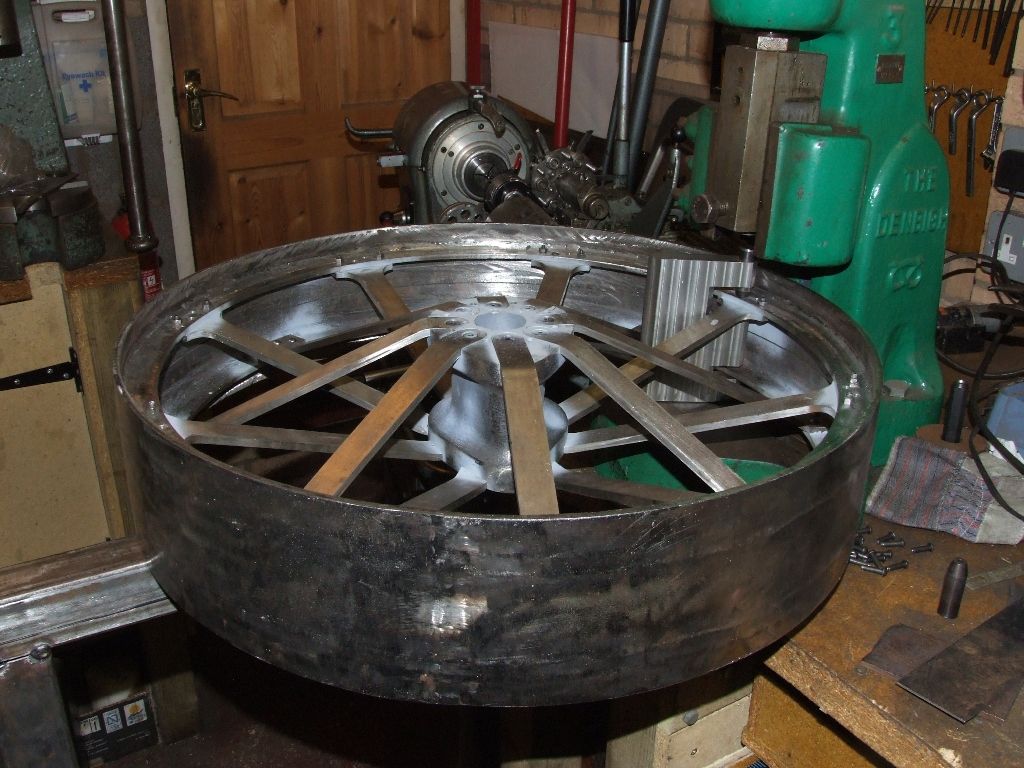

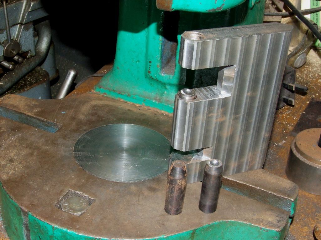

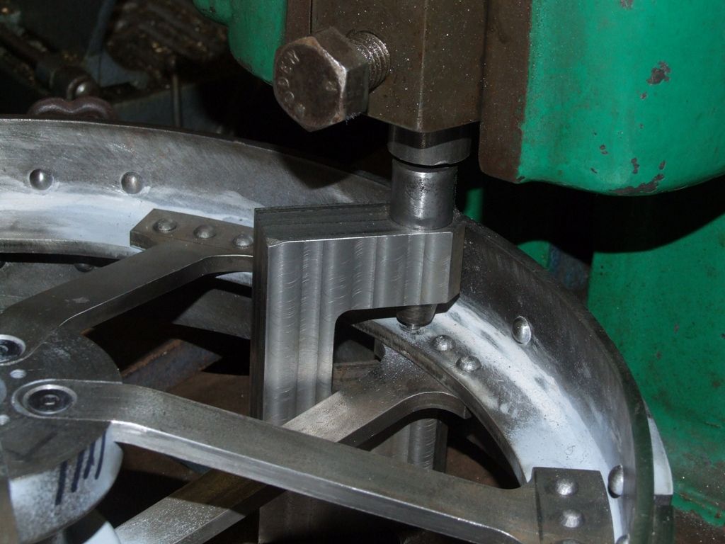

                The practice rivets also allowed me to experiment with rivet length. I found that the length was critical to get a nicely formed head, certainly within 10 thou and preferably 5 thou. The actual length will depend on the rivet snaps. I made all my own snaps from silver steel, hardened and tempered. The business ends of the snaps need a slight chamfer so if they're not quite square they don't mark the work. I also made my own riveting jigs. It is important that the snaps are held in line and perpendicular. Here's the front wheel being riveted:

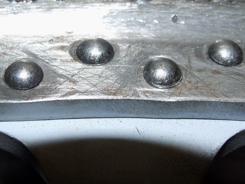

                I used a flypress but for 3/32" rivets you'll probably get away with a hammer. Here are the formed heads; for comparison the rivets at the top are the commercially formed heads of the rivets for the steel tyres:
                This is the riveting jig and more snaps, plus the setting snap, for the rear wheels:
                Riveting the rear wheels, it don't half hurt when you drop the wheel on your foot:
                These are the formed heads on the rear wheels, not quite as good as the front wheels. But full size isn't perfect either! The T-ring has bulged slightly as the rivet shank expanded:
                And the two rear wheels finished:
                Any questions?

                          Thanks Jon; it ttook a lot of faffing about to get proper rivet heads formed. I spent some time with bigger and bigger hammers before I realised they simply weren't going to cut the mustard. Even then with the flypress I had a few hiccups and had to drill out the rivet and start again.
                          To answer the "feed" from KWIL the front wheels are 15" diameter and the rear wheels are 24" diameter. That's why it hurts when you drop it on your foot. Thank goodness for the proper safety shoes I purchased shortly before doing the riveting.
