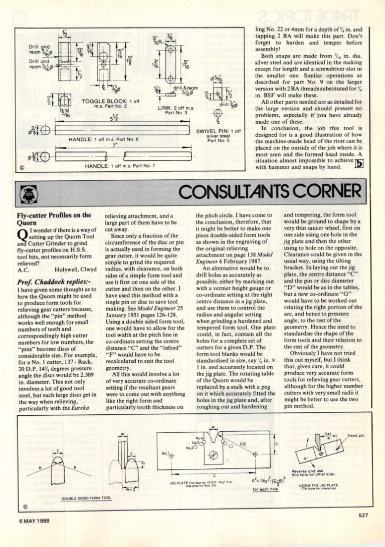

                      #620454
                      Brian Abbott
                        @brianabbott67793
                        Good morning everyone,
                        Would someone be able to send my a copy of the rivet squeezer write up?
                        ME Index for 1988, Volume 160, Issue 3824, Page 526
                        I thought i could get it through the archive but it does not go back that far
                        Thank you.

                            #620465
                            Brian Abbott
                              @brianabbott67793
                              Sorry..looks like there was another one
                              1987
                              Vol 158
                              Issue 3801
                              Page 574
                              Can anyone help?
                              Thanks
                              #620467
                              Ady1
                                @ady1
                                in here
