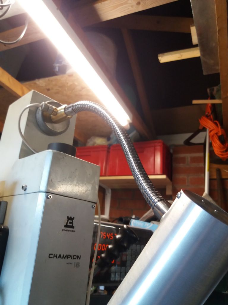

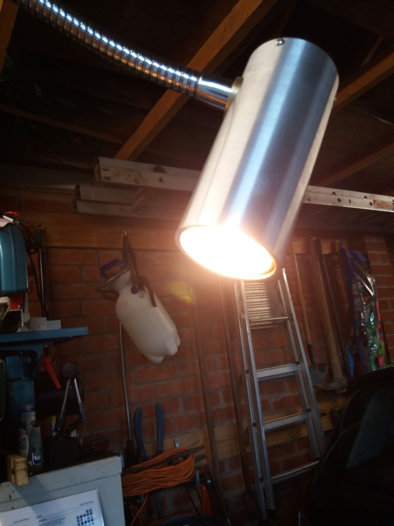

                  #365455
                  David George 1
                    @davidgeorge1
                    This is one I made a few weeks ago
                    Magnetic base recycled, lamp insides from Ikea, flexible stem ex microphone stem short length of aly tubing
                    David
