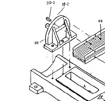

                  Hi,
                  look at the picture from the manual of my X2. it is the piece 39 that makes the column has some flexibility, not the column. it is a simple square in cast iron with a small base and 3 bolts almost in line. you cannot enlarge the base without reducing Y travel
                  Scraping and cleaning this base and the corresponding surface as you did is the best we can do this this machine, or buy a X3…

                    My thoughts are on the lines of a back plate at the moment, but bring it down to bench level. Instead of the ‘tensioners’ fit an exact spacer between bottom of plate and the base and a couple of M8/10 screws into the back of the base.
                    I think the three screws in Part 39 are too close together, my spacer idea would spread the load over about 4″ front to back, instead of 1-1 1/2″.
