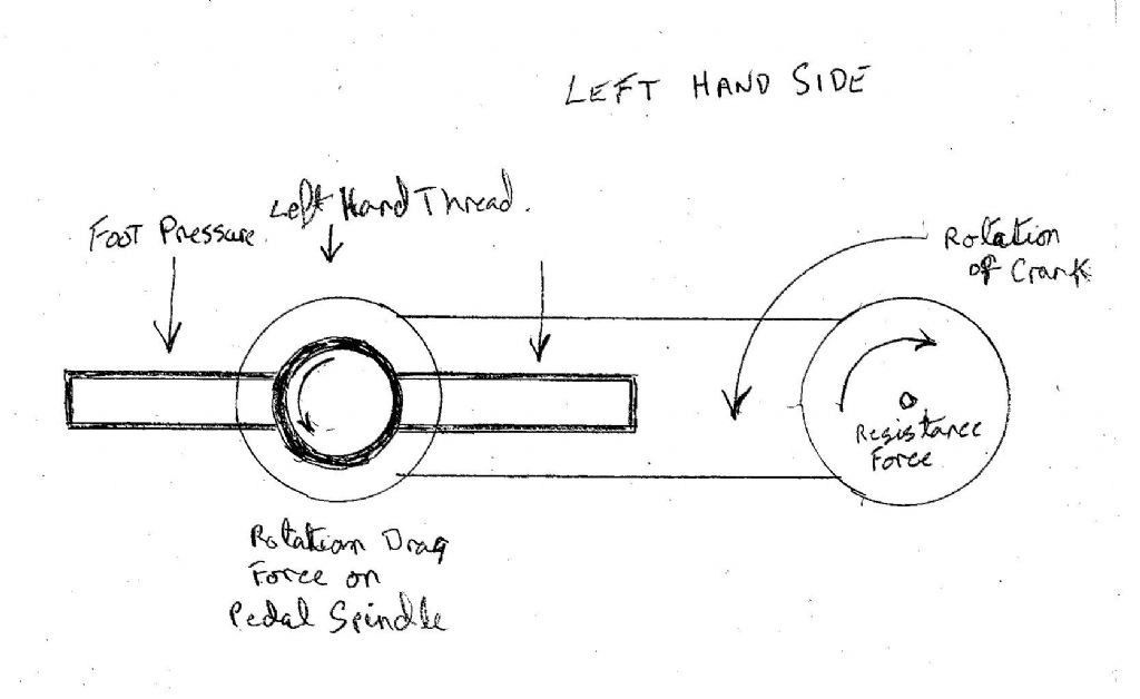

                      #536852
                      John MC
                        @johnmc39344
                        I thought it time to ressurrect this thread. The choice of LH vs RH threads on a bicycle is done for good reason. Considering the pedals, RH thread on RH side, the often made assumption is that the pedal rotates CW on this side , it doesn't, it rotates ACW, the direction that will undo a RH thread. So why the RH thread?
                        A couple of the replies to my original question have "got it", what I am looking for is a simple explanation. So, once again over to you guys.
                        #536853
                        Nick Clarke 3
                          @nickclarke3
                          Posted by John MC on 29/03/2021 09:27:05:
                          A pedal will indeed turn anti clockwise on its spindle, however the spindle is not totally frictionless so the force of a power stroke from the rider will tend to tighten it in the crank surely?
                          #536865
                          Nicholas Farr
                            @nicholasfarr14254
                            Hi John MC, here's my crude diagram of how I understand it. Notice the drag force on the pedal spindle is in the opposite direction to the resistance force, the resistance force is the resistance the road wheel has from turning, therefore a left hand thread on the pedal spindle will tend to tighten.
                            Regards Nick.
                            P.S.  If the pedal seizes onto the spindle you will find the pedal may well unscrew if it isn't rusted in, which has happen to me at least once, but I was young enough then to get home on one pedal.
                            Edited By Nicholas Farr on 29/03/2021 11:00:08

                                          #537042
                                          John Haine
                                            @johnhaine32865
                                            So you can put a spanner on the flats on the pedal, with the pedal horizontal and facing forward, so the spanner handle is near the bottom bracket. Then stand on the handle to exert maximum torque to undo while holding the bike down and back firmly.
