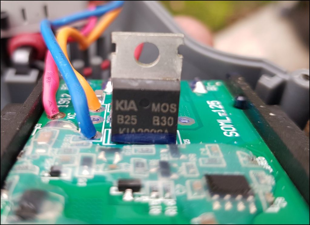

      I have bought a £15 Ferrex battery grinder from Aldi with a view to removing the metal work head and fitting only the motor to another device.
      This grinder uses a 40v battery and has a soft start but no speed control. I don't need the soft start since there will be no cutting disc or rotating parts exposed.
      What I want to do is either junk the soft start and fit an independant speed control in it's place, or manually manipulate the soft start ramp to adjust the RPM with a speed pot or something. Here is the board and components that make up the soft start module:
      The motor won't be under much load from it's retro-fitted duty, far less than when being used as an angle grinder. What I want to know is:
      Does anyone know what method would be used normally to control the ramp, and could it be manipulated to work as a speed setting instead?

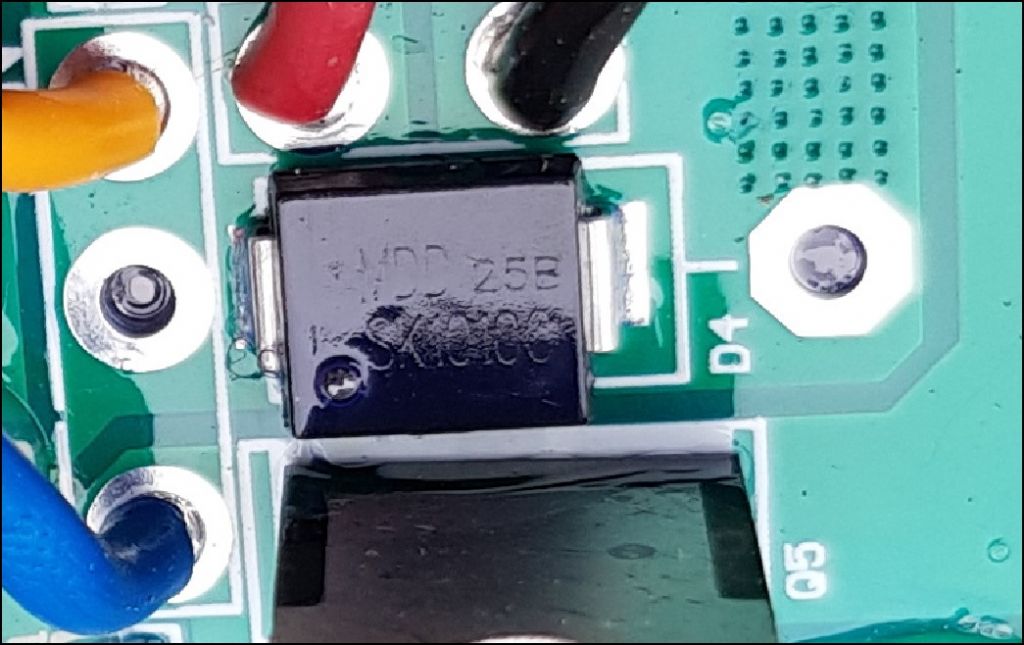

          P.S. __ The shiny black chip is a rectifier
          http://www.thinkisemi.com/pdf/SK1045_SK1065_SK10100.pdf
          … so presumably U3 is the clever bit.

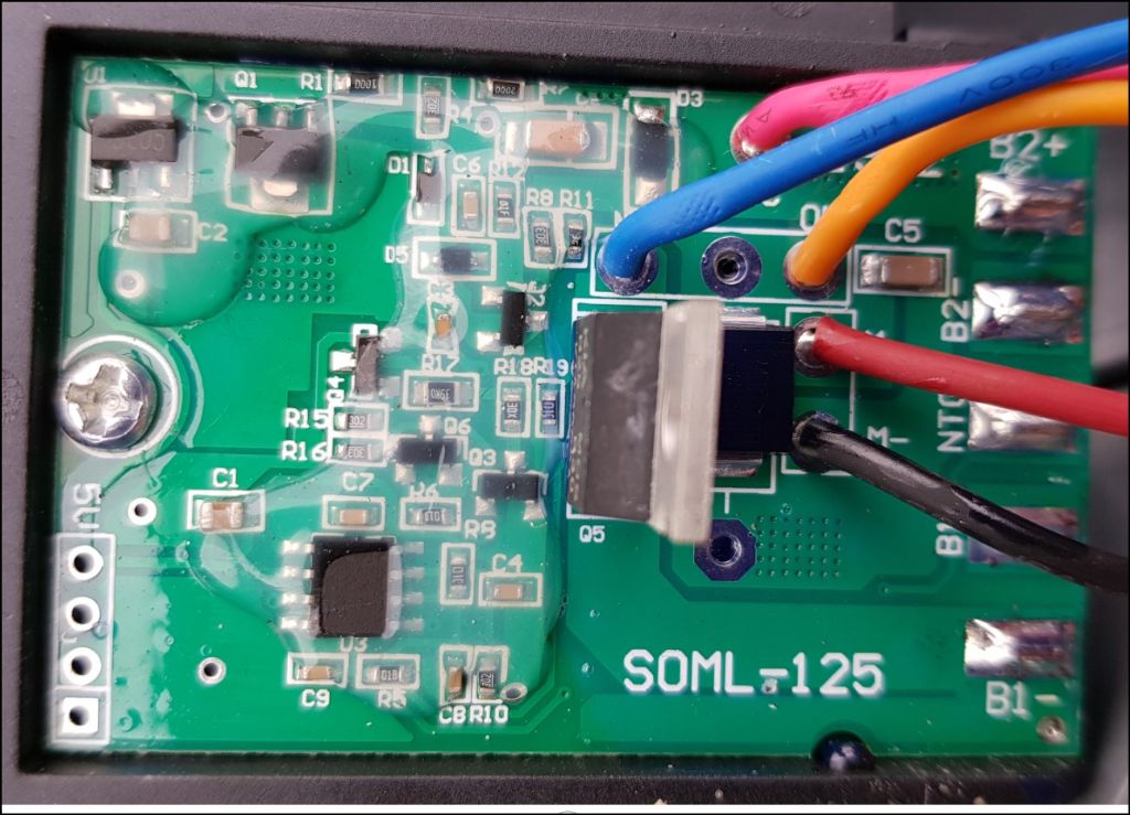

            Yes I have the battery system (I obviously needed a battery so I bought one battery set and two grinders).
            No marks on the motor it's just a basic PM stator and 7 segment wound commutator.
            I was wondering about U3, it rather unhelpfully has no markings. Looks like the top's been sanded off.
            Edited By Pete Rimmer on 19/11/2022 13:47:09

              • I was just wondering whether you could ‘review’ the battery system, but it sounds like recent purchase
              • as for the motor .. there are plenty of basic PWM controllers that should handle that

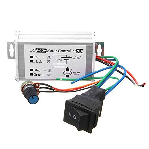

                    Hi, look up dc motor speed controller on eBay ,plenty on there fairly cheap.
                    Maurice

                      I think it will be difficult to modify unless you can reverse engineer the circuit and take measurements with an oscilloscope. Looks like a mosfet power transistor used to switch the motor controlled by U3.
                      Probably easier to buy a speed controller from eBay as has been mentioned.

                          I have looked at some of the ebay/amazon offerings and so far there are none that are powerful enough yet small enough to fit inside the housing. I was kinda hoping that the soft-start works by sending a rapidly-lengthening PWM pulse to the mosfet and that I could somehow swap that output for one from a PWM chip but I guess my 'lectronics knowledge is too scant for that to be feasible.
                          It's not a deal breaker. The original device is fixed speed it's just 10x more flexible if it can be varied.

                                I would be at all surprised if the 8 leg chip with the label sanded off was the ubiquitous 555 timer. Operated in a mode where it generates a pulse train whose duty cycle is set by an external voltage that ramps up when you switch on to give the soft start. Pulses go to the gate of the MOSFET, the big diode is a flywheel diode on the motor. Some judicious 'scope work could test the theory. If it's right then you could just feed a voltage to the 555 for variable speed control.

                                  Interesting John, I didn't realise that a 555 tier could send variable duty pulses I thought they were always 50% duty but variable frequency. I'm very weak on the subject though.
                                  #621847
                                  John Haine
                                    @johnhaine32865
                                    Well, it's a bit suppositious, but there ain't that much circuitry there and it doesn't look very high tec.

                                      It’s conceivable that the chip is a micro, an ATtiny variety…the 4 pads may be the program connections…there’s 5v, MOSI, MISO AND GND….but no pads for Clock and Reset…,?
                                      Easy enough to check with a meter..

                                            I agree. The circuit almost certainly is a soft-start, but how it works is unknown and it includes an unidentified 8 pin chip that could be anything from an NE555 to a microcontroller. More trouble to understand and modify than it's worth when PWM speed controllers are inexpensive on amazon, ebay and others.
                                            An ordinary PWM controller provides a sort of built-in soft start. If a switched pot is provided, turning the motor off also sets the pot to minimum speed. May not be ideal or completely fool-proof, but often a reasonable solution.

                                              Wherw do all the wires go?
                                              Motor I can see, Red and Black, and battery connections allong the bottom.
                                              What are the markings nest to the wires on the PCB (the silkscreened white markings)?
                                              The fact that the Orange and Blue wires go to the outside two of three connections that are enclosed in a rectangle on the silkscreen. This looks a lot like it was intended for a potentiometer which could be used for a variable speed option.
