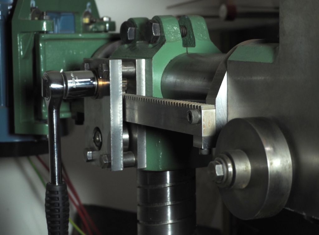

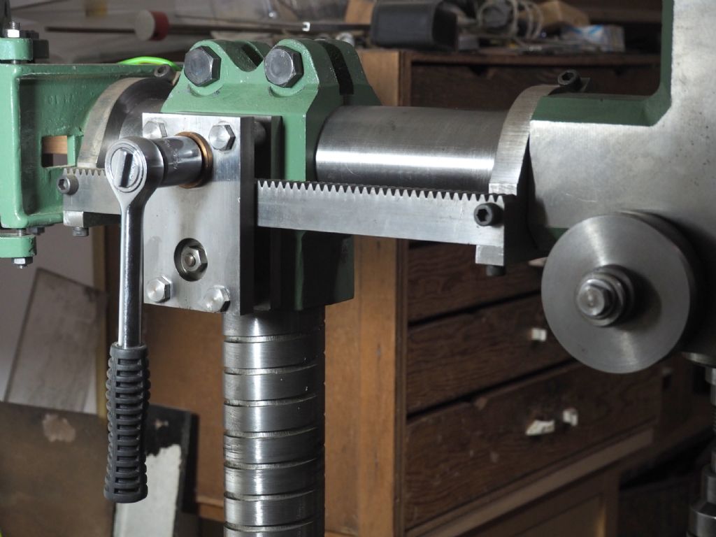

        I bought a Tom Senior light vertical mill last week. It hasn't arrived yet but already I'm thinking about how I could modify it I'd like to make it easier to move the head in and out and also to retain the registration when doing so . This is the mechanism that I designed for my Dore Westbury mill to achieve the same function. The pressure angle on the rack maintains the contact with the registration bearing. Working from the inverse of this design seems a good starting point. Any thoughts?

          Sorry no thoughts Miles, but I do like that mod on the Dore Westbury. Very nicely done! yes

            Thanks Vic! The Dore Westbury has been a really useful machine for me – it's very versatile. It is a bit of a lightweight though…. Now I've upgraded my Myford Super 7 to a 254, I wanted a mill on the same scale which is why I bought the Tom Senior. I'll keep the Dore Westbury as a 'radial' drill for woodworking.

              Very nice work on the rack. You could probably buy a Bridgeport for the cost of the Tom Senior and get it ready made.

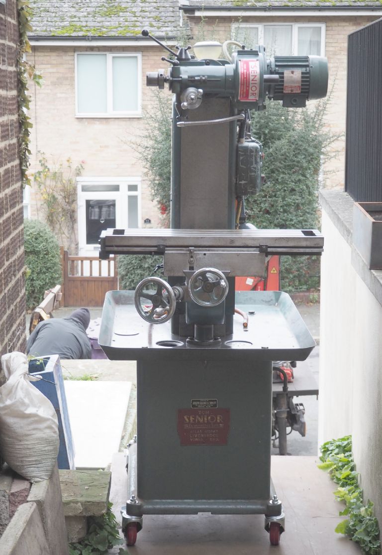

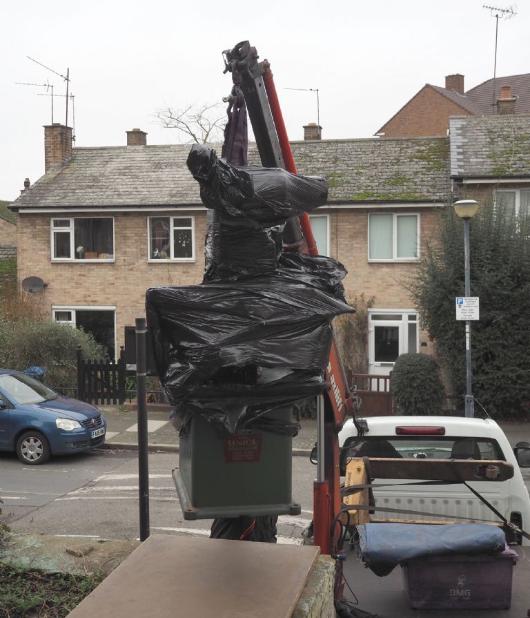

                  My new toy has arrived

                      Shame the top half will be in the bedroom :O)
                      #388129
                      Miles Hellon
                        @mileshellon
                        No problem. I've already dug a pit for the base

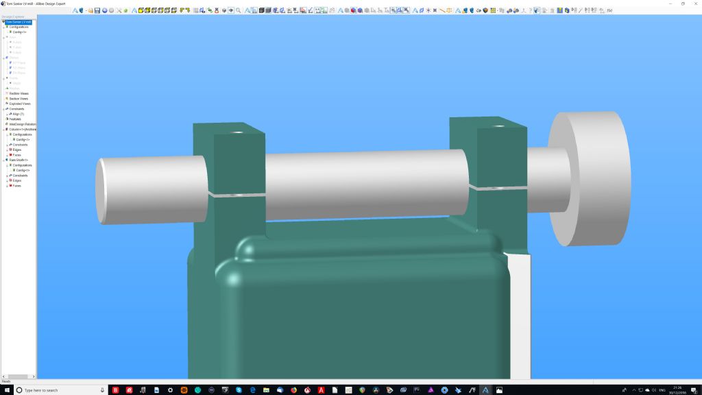

                              Made a start, this evening, by modelling the column and ram shaft.

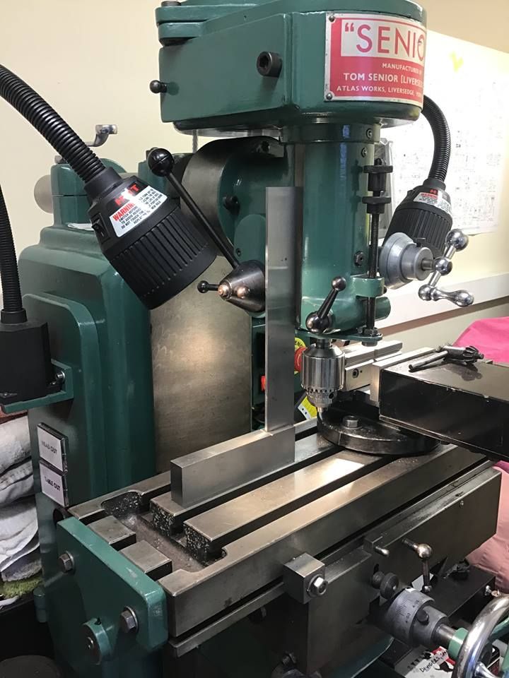

                                    Hi Miles. For alignment after moving the head out, I would wind the table up, put a large square on it and align the vertical part of the square with the machined slot on the left side of the head. For complete accuracy I would trammel the head with a dial indicator.

                                        Thanks Nick,
                                        I clocked the machined slot yesterday but its obvious purpose didn't register!

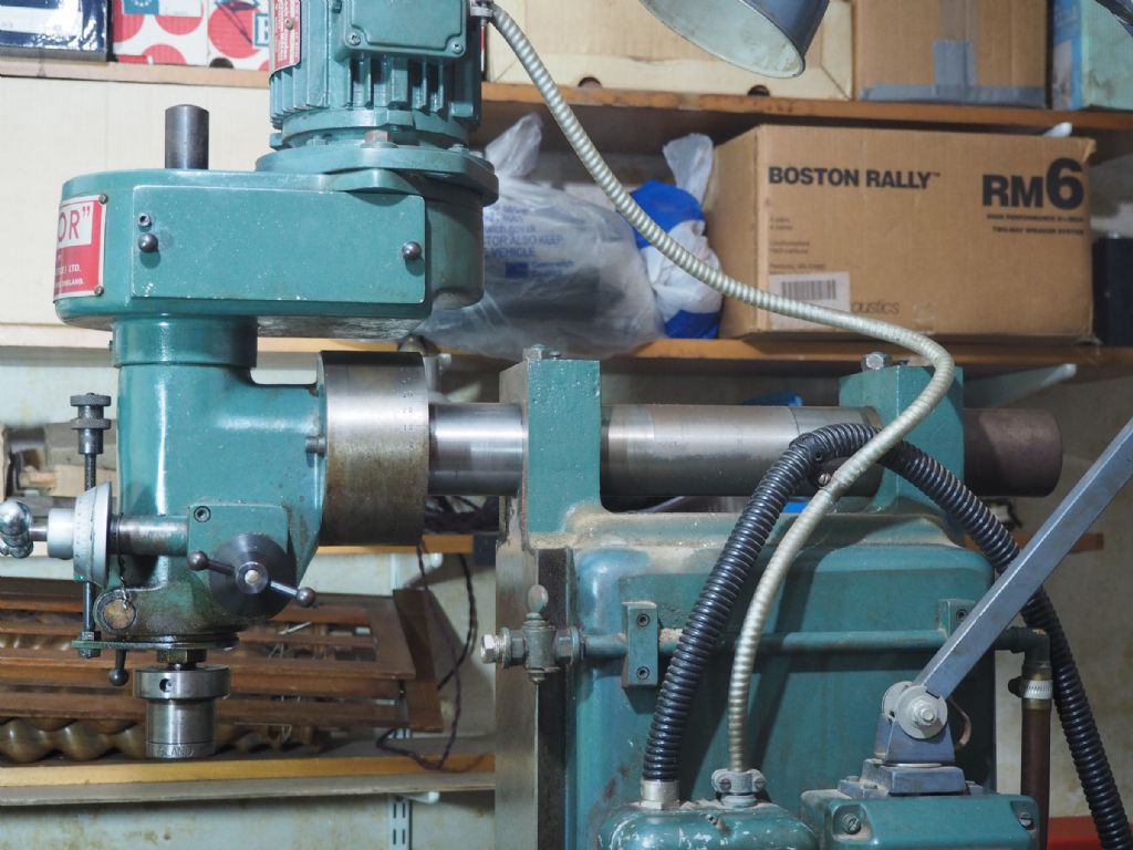

                                            It's interesting that they made a few with a mechanism for rotating the head…..senior lv with head rotation mech..jpg

                                              Hi Miles. I am not sure that the slot was intended for that purpose but it works! I think mine is circa 1978, from memory.
