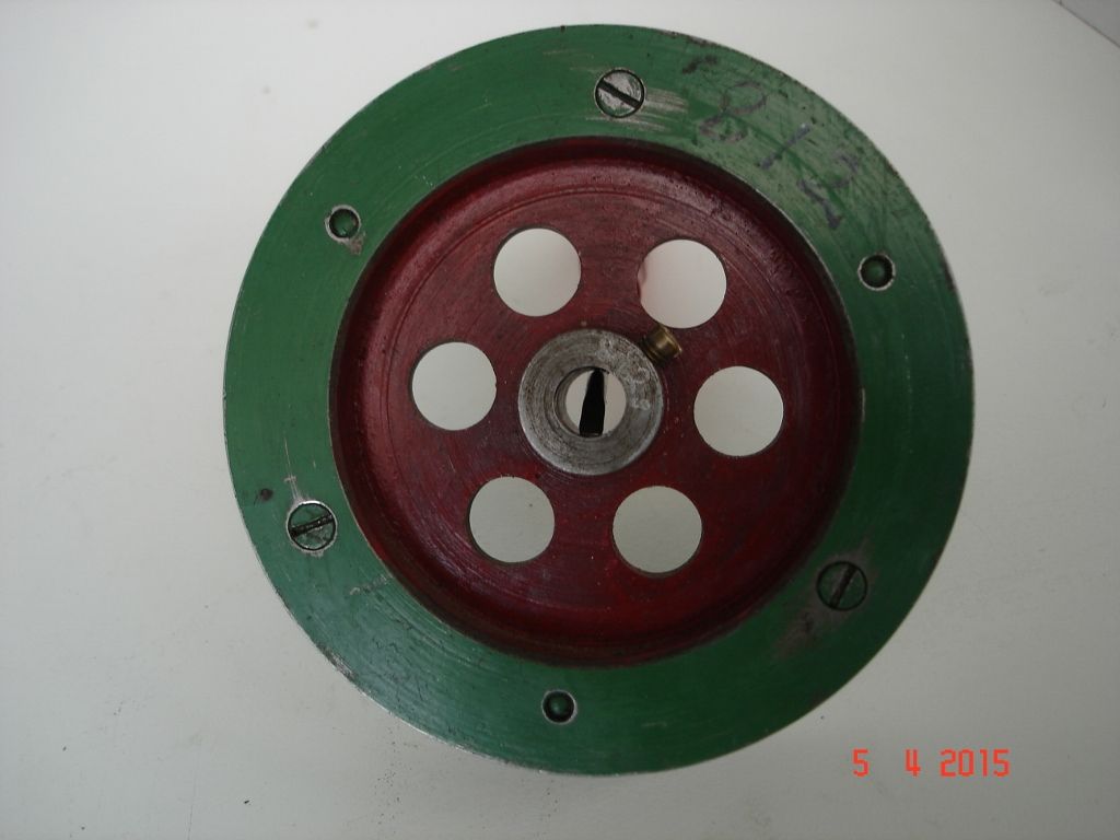

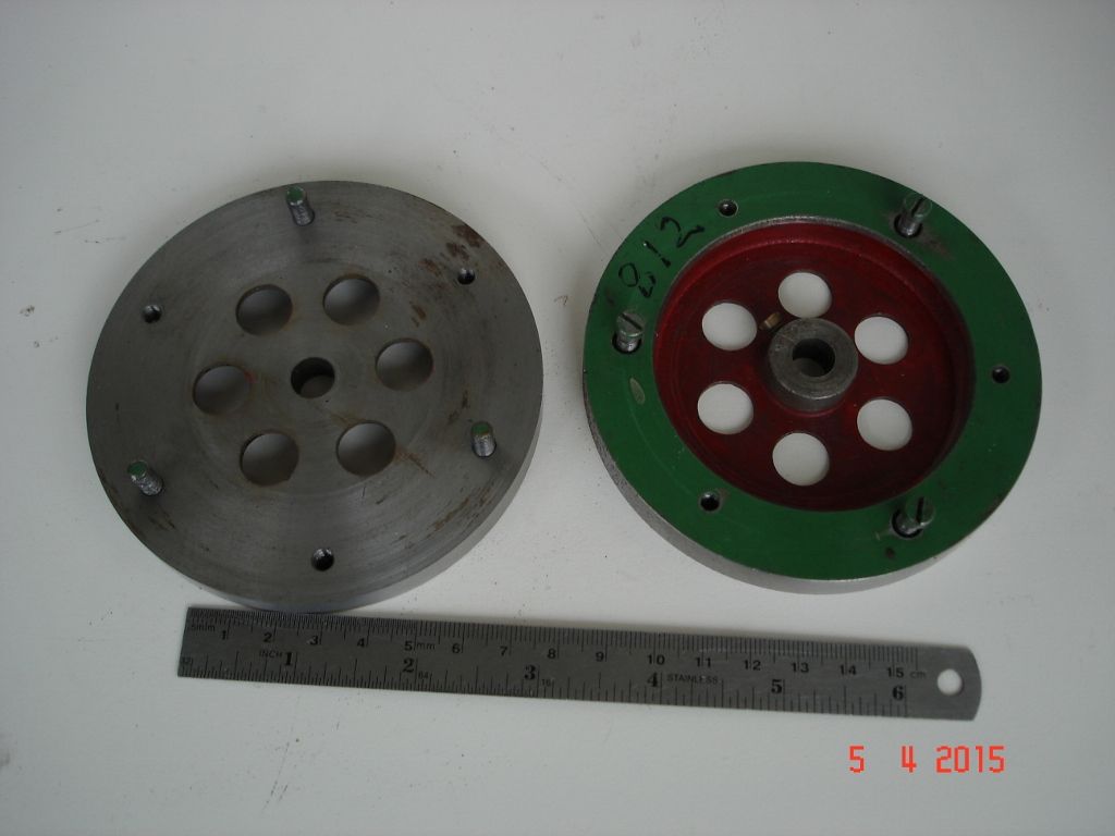

                  #198489
                  Ian S C
                    @iansc
                    dsc01071 (1024x768).jpgThe flywheel on the above motor is made of stainless steel, the spaces between the spokes chain drilled, and the spokes filed to shape. You could make a flywheel like this one, made in two parts to get the required thickness. It's got bigger holes in it now, and it will get a bit of a clean up.
