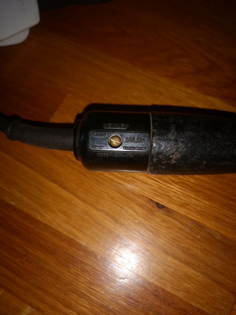

      img_20230206_123237.jpgI was wondering whether anyone has had any experience and success repairing this type of soldering iron? It has taken to tripping out the electrics from time to time. I shall change the lead as a precaution, but would welcome any other suggestions or advice from experience that people have.

          I'd replace it unless certain the cable was the problem, (Quite likely it is, but be sure.)
          Last thing electronic work needs is a soldering iron with an earth fault, and it might burn the house down after shocking the operator too.

              Looks like Henley Solon iron so quite elderly and (depending one which model/wattage) not ideal for modern electronic equipment.
              If there is leakage to ground in the element then its toast, if its just a wiring or cable fault then its an easy repair.
              I would put it on ebay (they seem to be wanted by some collector or enthusiasts) and get a new proper new iron

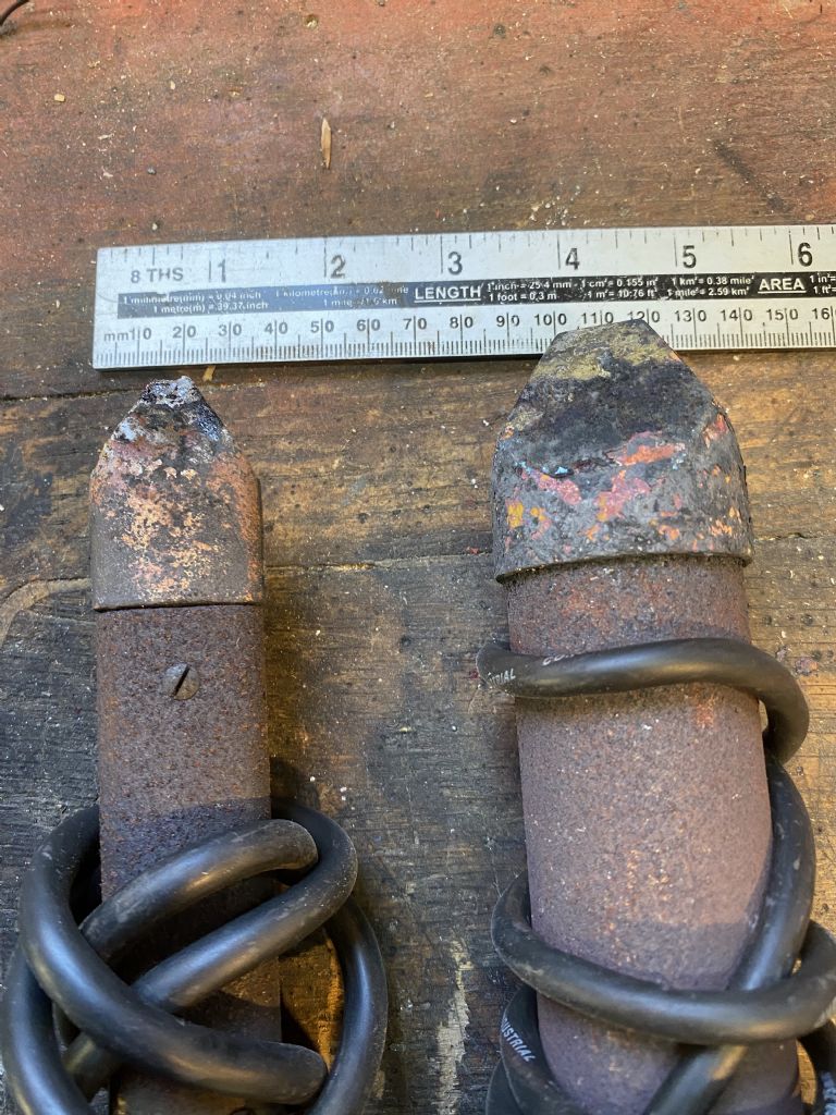

                                  Hi Speedy Builder5, a photo of my 65 W & 250 W irons, which the copper bits are 18mm & 44mm wide, the big one does take a fair while to get hot though.
                                  Hi John Haine, no cheap plastic on these, the handles are wood and the covers over the lead connections are Bakelite, and their quality is a long way upwards from your description and they have both done a fair amount of work in their long life.
                                  Regards Nick.

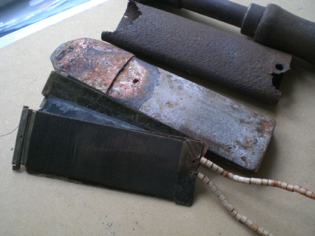

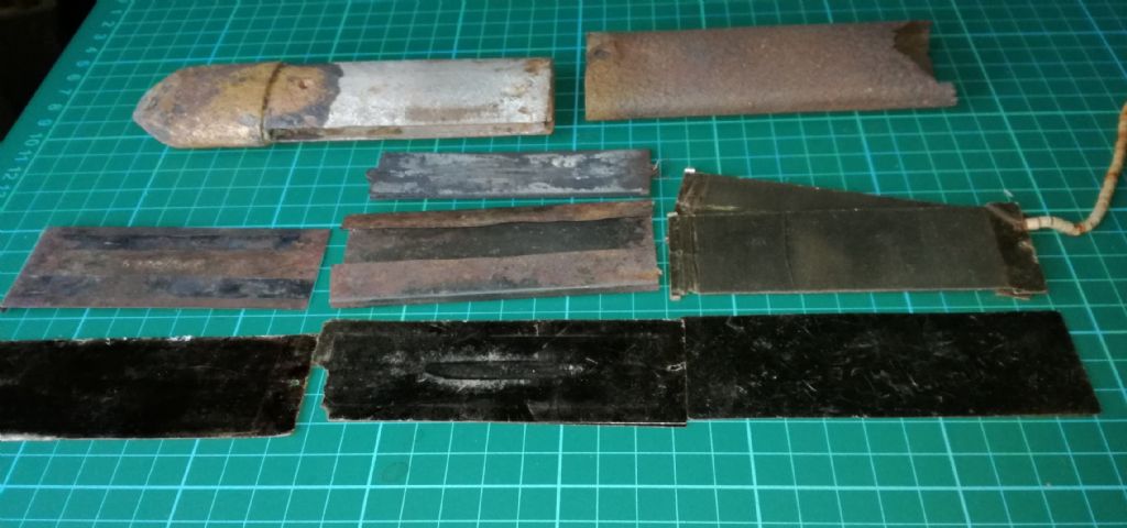

                                    What wattage is that James? If it's 65W then I could spare one of mine for you as a replacement. I have a 125W (110v) , had a 100W but it got destroyed in a fire and I have a couple of 65W.
                                    To anyone contemplating stripping the element out of theirs for a service be advised that they do contain what appears to be asbestos and it's quite friable so only attempt this if you're aware of the risks and precutions. You don't want 5 million fibres in your lungs just to save a tool you can get for a fiver at the boot fair.

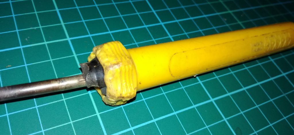

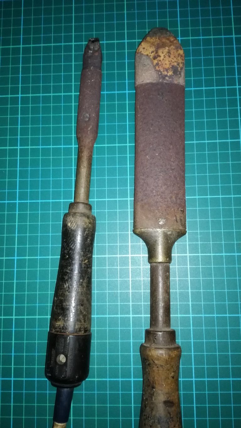

                                                  Hi Pete, I don't know if there is any asbestos in my 65W one as I've never had any reason to take it apart, But there certainly wasn't any in the 250W one, there were Mica sheets though, which some had just fell to pieces, these were between the two heating elements and a separation strip of soft iron, and between the outside of the two heating elements and the outer shield, which was inserted into the slot of the copper bit.
                                                  I don't know why some rubbish these soldering irons, as they do the work they were made for, and both of mine have paid for themselves without any doubt. The one that is in pieces was one that I used in my old job many years ago, and got used for a whole day on a regular job over many years, until that particular piece of machinery became redundant, but it wasn't new when I got it, and it didn't melt like the Antex one that I did buy new, in the photo below.
                                                  I only had this one at home, but it didn't do even a quarter on the work the one above it did.
                                                  Regards Nick.
