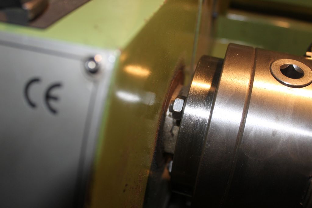

                    If this is the first time and you have removed the three chuck securing nuts from behind the mounting plate, it is probably stuck with the protective grease that was originally used to protect these components. I had the same problem and used a rubber mallet to knock the chuck off. You need to rotate the chuck a little after each blow. It will release suddenly so be prepared as Jens said by protecting the bed with ply, I have a specially shaped softwood cradle which protects the bed and is used to store the chuck, I'll take a picture later. You may also like use a large wad of cloth, both to cushion the possible landing and to prevent it rolling off the bed if the chuck releases unexpectedly. A rubber mallet will not damage the chuck.
                    Tips:
                    Switch OFF the power to your lathe, do NOT put your free hand under the chuck to catch it, you WILL cause yourself an injury, Also be sure to REMOVE any fabric before turning the lathe on again. Clean off the protective grease with white spirit and lubricate chuck locating spigot with a dry grease, I use PTFE spray – it doesn't attract swarf or grit – to prevent sticking in future.
                    Regards
                    Terry
                    P.S. I Forgot embarrassed,  do not remove the nuts completely from the securing studs, screw them to the end of the stud then use the mallet.  This will prevent the chuck dropping unexpectedly when it releases.

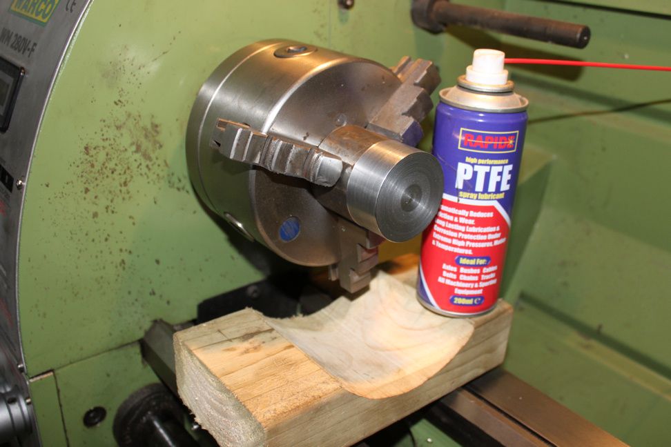

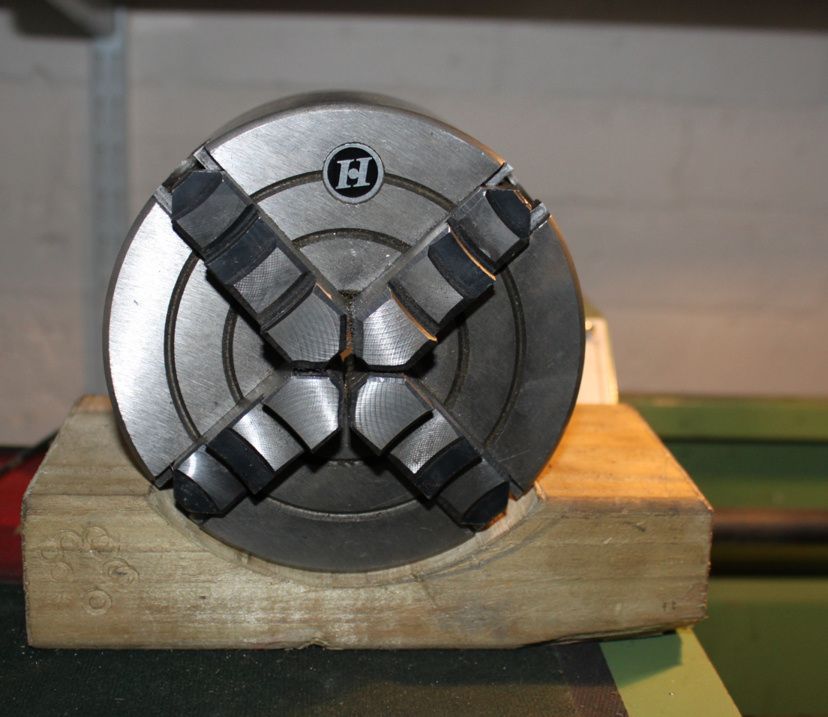

                      Out of interest I post pictures of my chuck cradles on my lathe which is different to yours but the principles apply, They really need a means of locating them accurately on the bed of the machine such as a block of wood attached to the underside. I forgot to mention that the padding etc is to protect the bed of the lathe rather than the chuck – bed damage is much more important to accuracy (and expensive to repair) than a 'bruise' on the chuck.
                      In case you are not exactly sure I also attach a picture of one of the securing nuts of the chuck, ignore it if it is of no interest.
                      1. Chuck cradle positioned to protect bed and chuck when removing (Spray is included as a reminder!):
                      2. Chuck cradle used for storage – I have one for each chuck:
                      3. Chuck securing nut – do not completely remove initially when releasing chuck:

                      Hope this may be of some help,

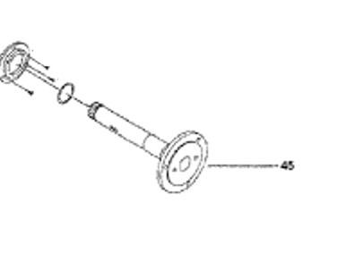

                                  I'm a bit confused here, I just checked the Sealy parts list (see Michale Gilligans link above) and the spindle definitely shows a mounting plate such as I and others have described. The relevant part is number 45 in that list. I have extracted it here and you can see the mounting plate as an integral part of the spindle – not a seperate component – on the rh side of the picture.
                                  I suggest that you do a double check and definitely post some pictures, just make an album and upload them (must be jpegs) You can then post them using the 'Camera' icon above teh message box.
