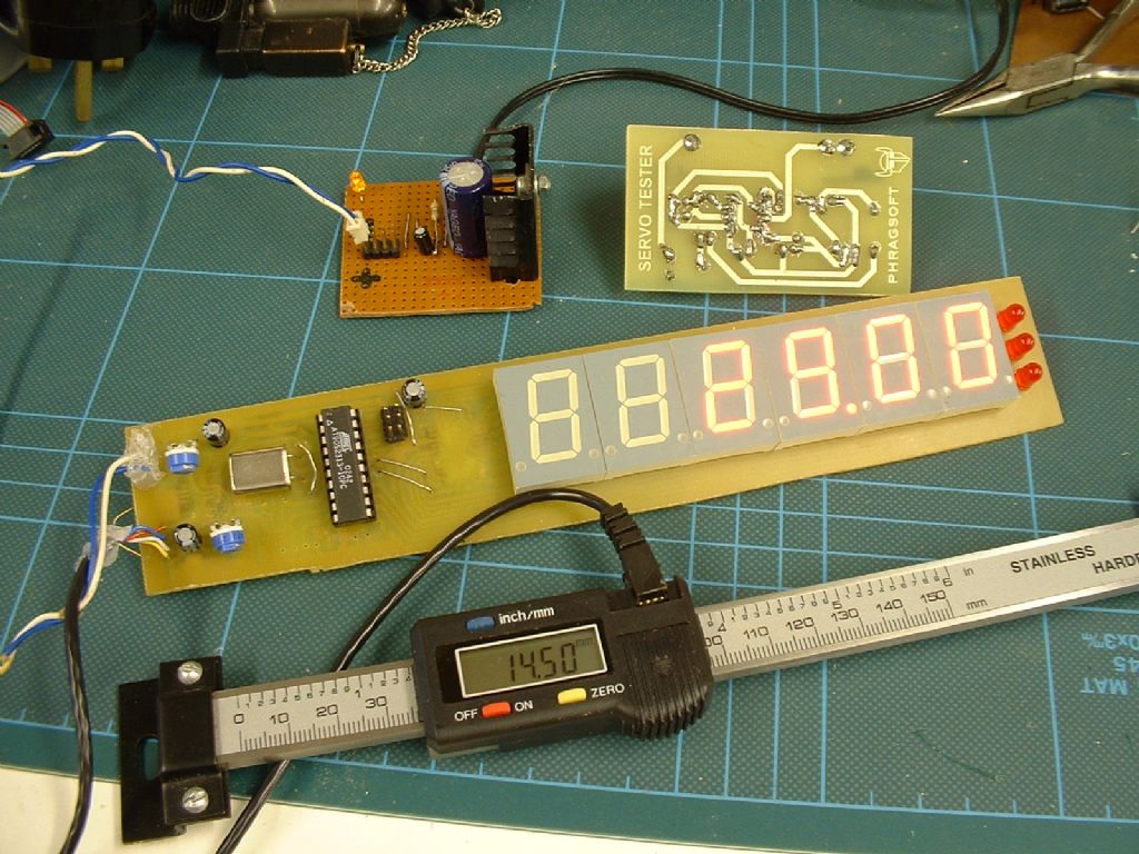

                        I've put a few photos in my albums of the scales fitted to my X2 mill.
                        Here are a couple.
                        Cheesy display unit:
                        PCBs for DRO and Tacho:
                        Test of DRO prototype (digital calipers use the same protocol):
                        #136753
                          I presume that Phragsoft must be long-gone [or re-born]
                          ??? This is the only reference that I can find
                          #136759
                          Sub Mandrel
                            @submandrel
                            Thirty years ago when I played AD&D, I had a half-orc cleric character called 'Phragmites the Algal' who had a two-horned helmet…

                              Neil,
                              Cheesy works for me.
                              Did you etch the PCBs?
