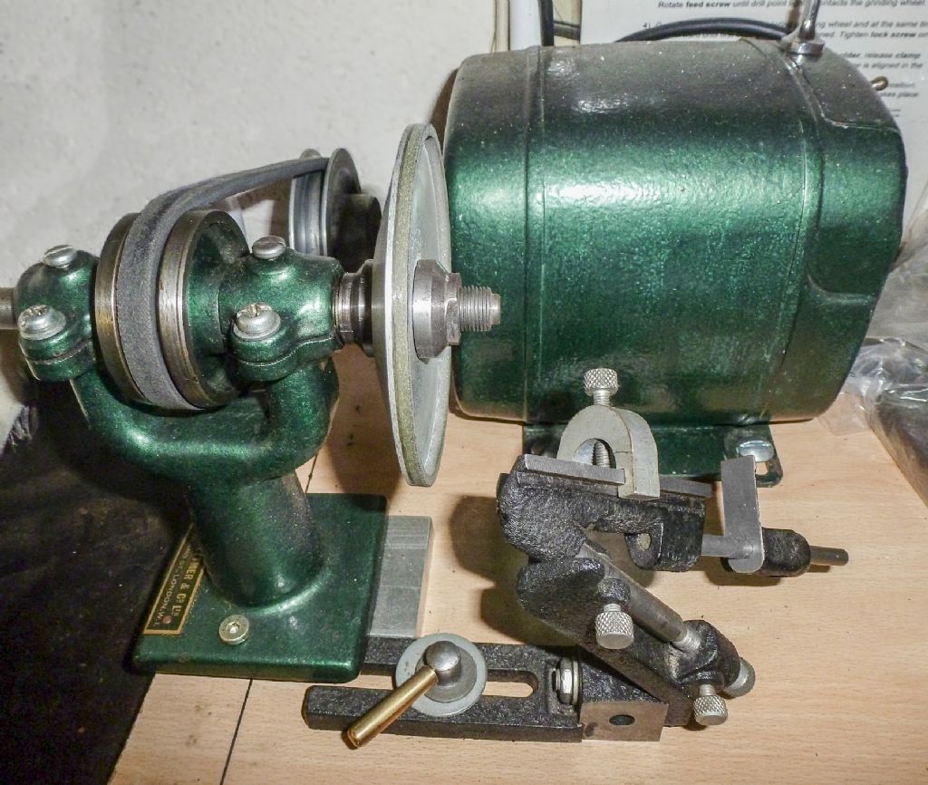

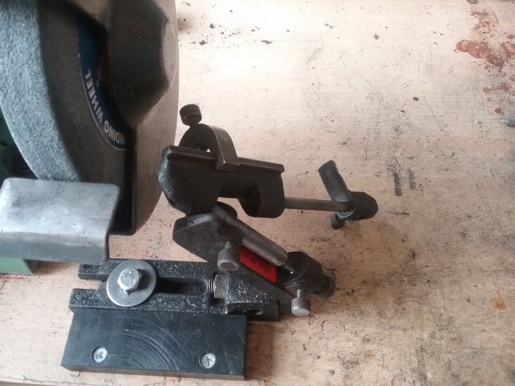

                                #366075
                                Fowlers Fury
                                  @fowlersfury
                                  Re: Clive Foster's posting, whilst not professing much (if any) knowledge of the finer points of drill geometry, I fully endorse all his comments about "perfectly flat and perfectly aligned at 90° to the……etc".
                                  For me, recognising such came from early failures to grind drills accurately with the Reliance jig.
                                  As recommended to "fishy-steve", a means to keep alignment of the Reliance at 90° to the wheel is essential.
                                  In the image below, I raised the diamond wheel so that drill points were close as possible to its centre line. This was done with a ms block which also provides the guide for in & out movement of the jig. Drill sharpening now seems accurate and although noting the "don't use a diamond wheel with HSS", I'm not aware of any decrement in HSS drill performance. I have though found it important to follow the Reliance instructions with respect to drill 'overhang' vs. its diameter.
                                  (I gave up trying to get 4-facet drill points on the Quorn – far too much time spent & seldom achieving a central point of intersection).

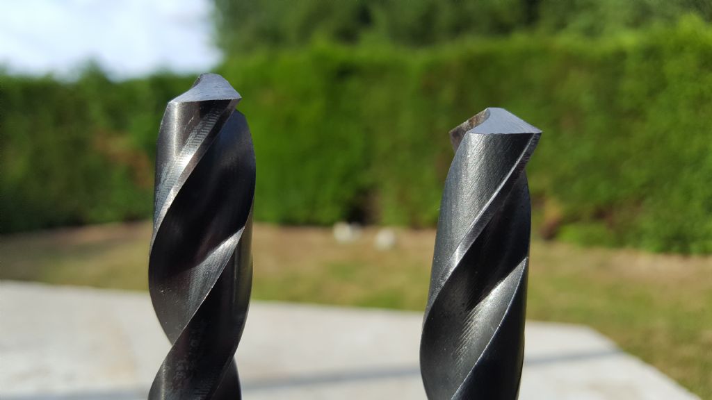

                                    Having now had a play with the jig my first impressions of it are very good.
                                    A couple of issues though.
                                    Firstly, having made sure that the jig and the face of the wheel are at 90 degrees to each other, I've found that the included angle of the cutting edges is 123 degrees. Not the 118 degrees I was expecting.
                                    Secondly, the attachment is advertised as being able to grind drills down to 1/8 diameter. I've found that when grinding standard jobber drills below 3/16 diameter the drill bit is to short to use the back stop as supplied. I have though, with a spacer between the drill and stop, managed to grind down to 1/8 diameter.
                                    Neither of these issues are show stoppers though.

                                      #366212
                                      Fowlers Fury
                                        @fowlersfury
                                        Re: your 2 queries about the Reliance.
                                        (1) You shouldn't need any spacer for shorter drills. Take off the end stop and replace it so the triangular part now points forward, to lay along the groove as below:-
                                        (2) Looking at the images of your 2 drills, it doesn't appear there's enough back-off from the cutting edges. As there's no adjustment on the jig for the angle ~ are following the Reliance instructions for overhang vs. diameter? Also you must pull the drill carrier back against the stop i.e. towards you with the lip aligned vertically as described. Then advance the whole jig up to the wheel so it's just touching. Release the little knurled screw and push back the drill carrier to traverse the wheel. Then of course advance the "cut" with the bottom screw after slackening the others before retightening.
                                        In the above image, there's a new Dormer 10mm drill against the wheel. You might just about be able to see the angle is correct.
                                        Edit: I ought to have paid more attention to your post and images. I now see you have a smaller Reliance jig and therefore the comments above may not be applicable. IF you ever spot a larger size Reliance for sale,
                                        snap it up !!
                                        Edited By Fowlers Fury on 07/08/2018 22:51:48

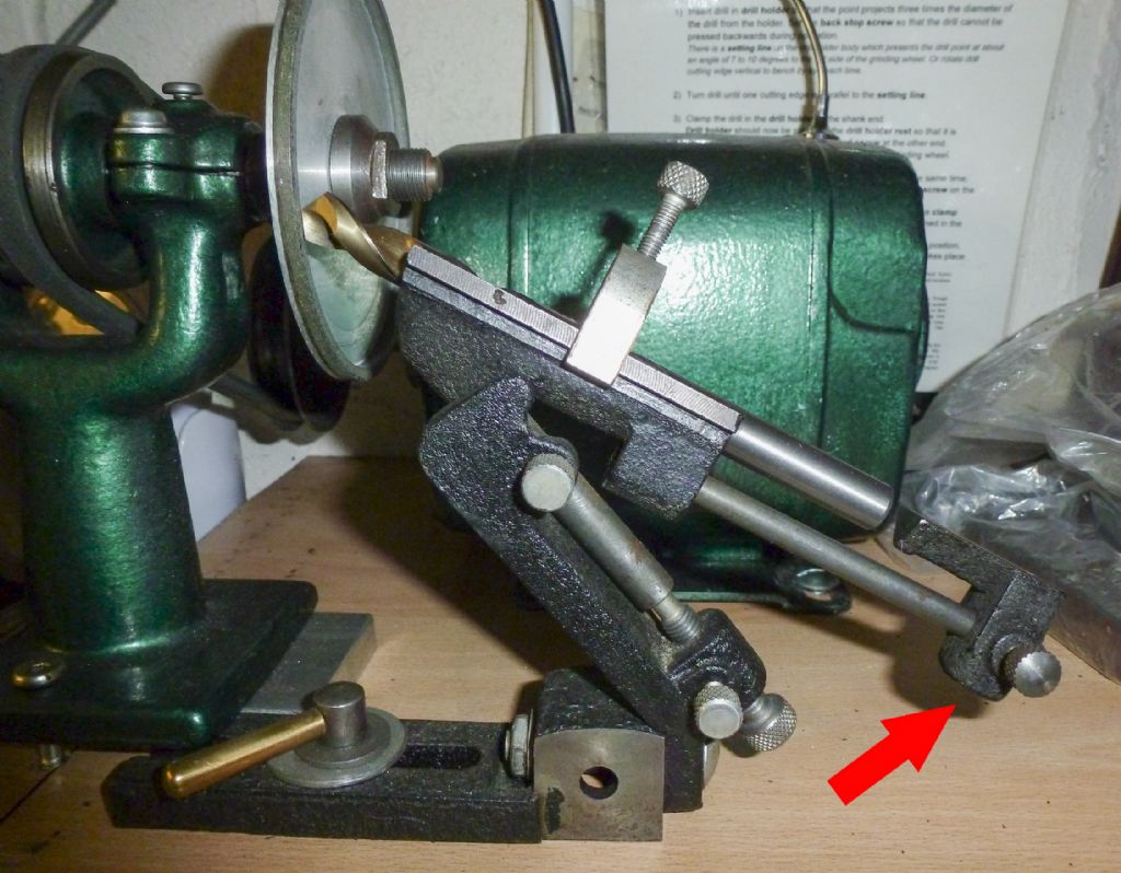

                                        #366214
                                        fishy-steve
                                          @fishy-steve
                                          My jig is the number 1 and it does differ from yours. It doesn't have the triangular shaped stop.
                                          The angle that the pictures were taken at does make the relief look shallower than it is. Although I would agree that the drill on the right could be relieved more. The drill on the left I ground free hand. Also the drill on the left is 13mm the one on the right 14mm so is slightly bigger than the 1/2 maximum size that the jig is designed for. I think the relief could be improved if I altered the 3X overhang slightly.
                                          If I ever come across a number 2 jig I will definitely buy it.
                                          Steve.
                                          #366218
                                          Fowlers Fury
                                            @fowlersfury
                                            "It doesn't have the triangular shaped stop."
                                            Not querying that and sorry for any confusion. It was just that your picture at first sight appeared to show the same type of end-stop as mine but closer examination then revealed the differences – hence the edit.
                                            Would it be worth drilling your end-stop for a silver steel rod, secured by a screw somehow? I''ve considered doing that on mine when sharpening the ends of short centre drills, thus avoiding an imprecise loose "spacer" in the jig.

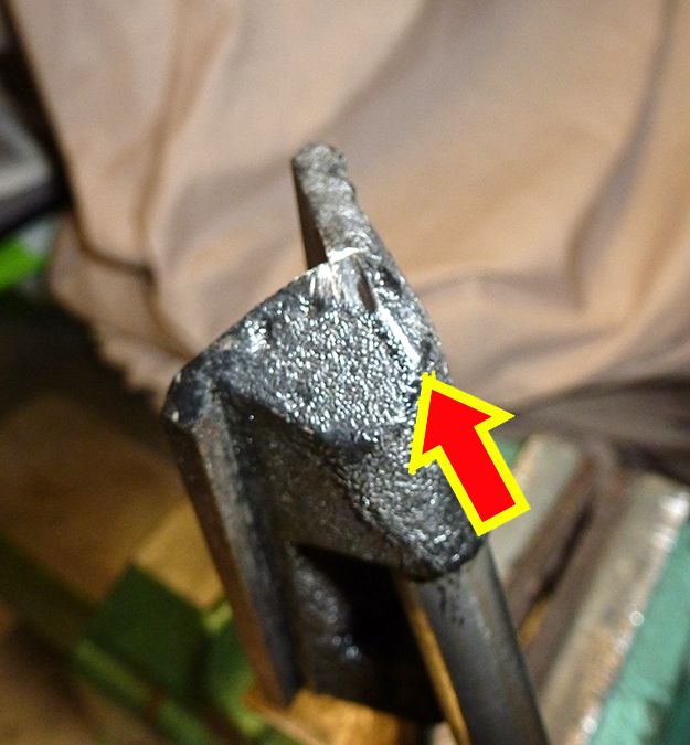

                                                  Sorry to resurrect an old thread but there is exactly one thread returned for a search on 'reliance' so I thought it would be good to keep it that way…
                                                  I hope this is a simple enough question to answer… The manual kindly shared with me by peak4 some time ago says 'rotate drill until the cutting edge nearest to you is parallel by sight to the engraved line on the front of the trough'
                                                  I dont see anything that fits the description of an 'engraved line' on my jig. I suspect that mine may be a clone built from a kit.
                                                  Could some kind soul please share a photo or sketch showing where the engraved line ought to be on a Reliance jig?
                                                  Thanks.

                                                    #608659
                                                    Fowlers Fury
                                                      @fowlersfury
                                                      Andy,
                                                      If the front of your trough is anything like that on mine, then no wonder you can't see it. The Reliance jig I have was purchased 2nd hand and herewith macro of the front of the trough. "Honest, it wasn't me wot did all that !"
                                                      I've indicated what remains of what I assume was the line.
                                                      In use, I just align the drill points' straight edges with the outer face of the trough. Drills always cut OK.
