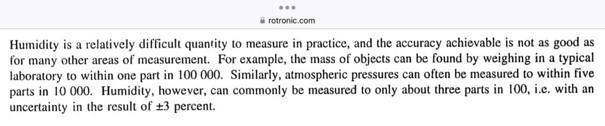

                          This won’t do much to inform the discussion, but I will just mention it:
                          Having worked for eleven years [mid 1970s through mid 1980s] in an environmental test-house, I recall that the accurate measurement of relative humidity was one of our biggest challenges … By any normal standards, these contraptions all have remarkably wide tolerances.
                          Edit: __ Couldn’t find this on the NPL site … Grrr!!
                          Bedtime reading:
                          https://www.rotronic.com/media/productattachments/files/n/p/npl_guide_to_humidity.pdf
