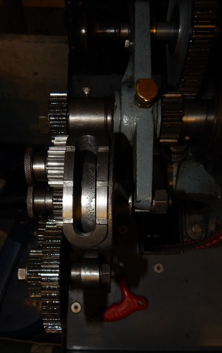

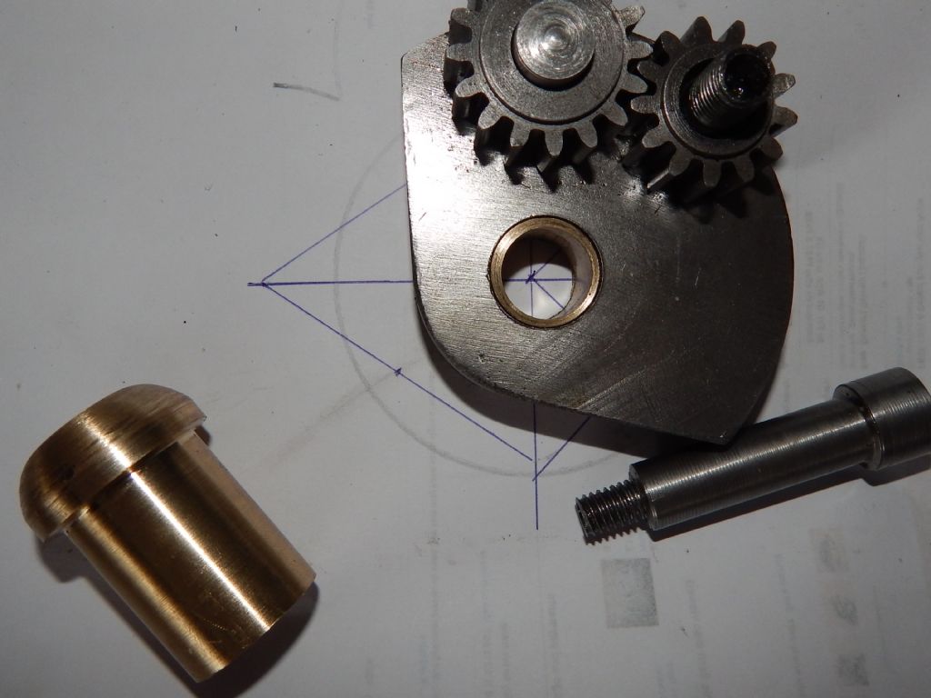

              Today I went to friends as my lathe issues are still not sorted and the company is being worse than useless as usual a letter is on way to them as am getting rather fed up with their rubbish. The Quadrant was re-drilled with a 14 mm hole and this covered all of the damage. After drilling this it was noticeable that when a rod was pushed through this was not at right angles to the face. A quick check indicated that the faces of the casting are not parallel despite being milled down. This was refaced and the hole expanded to 15 mm a Stud was made up that could be bolted from another side. A nut then was made to fit . And the whole assembly was trued on the lathe.
              First try at fitting with gears fitted after having a job to get them in as the sides of casting are not even
              Gears meshing first try

                Have worked out that if I make a brass bearing I can pull the quadrant forward on to that and push my 1/4 i need from the rear. This is what it looks like off . Still needs pinning and a handle and knob but the end is in sight.
                Gears on shafts

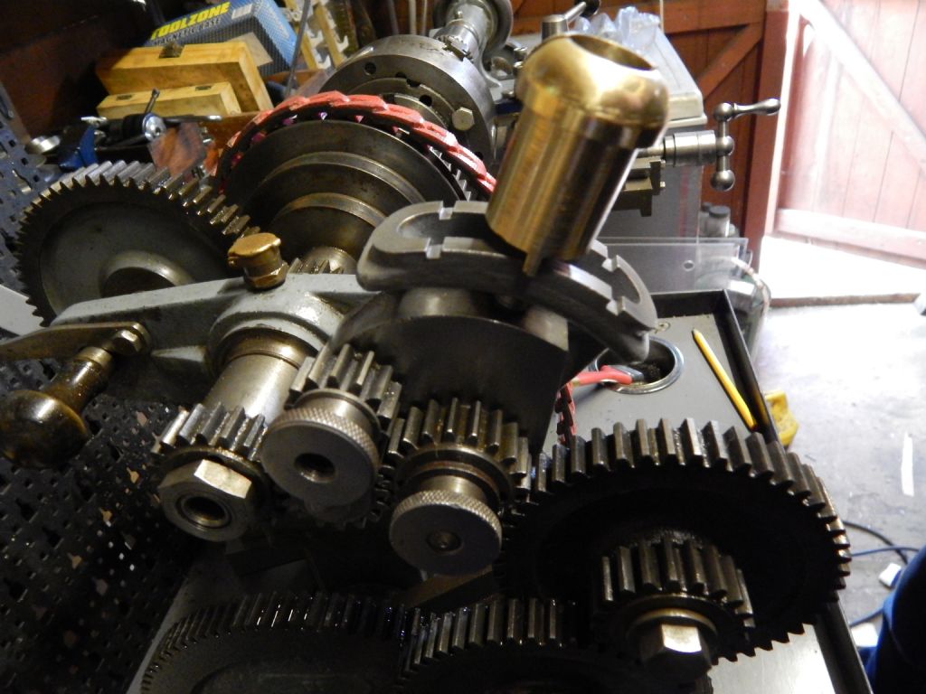

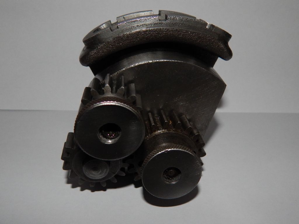

                    Here is the pins holding gears from rear
                    reverse of quadrant showing the pins for gears

                      More parts made for tumbler today letter sent to motor and drive factor. Still meed to cut slot and teeth in the handle . Made a brass bush for quadrant , as thought this was a better Idea . Had the entire unit on the lathe and had gears all turning by hand nicely .
                      More parts started today with some help from a friend

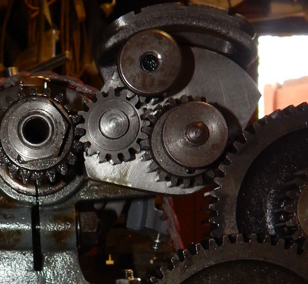

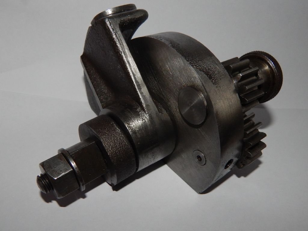

                        Well the Tumber is moving forward and only a few jobs left
                        Firts fit with newly made parts

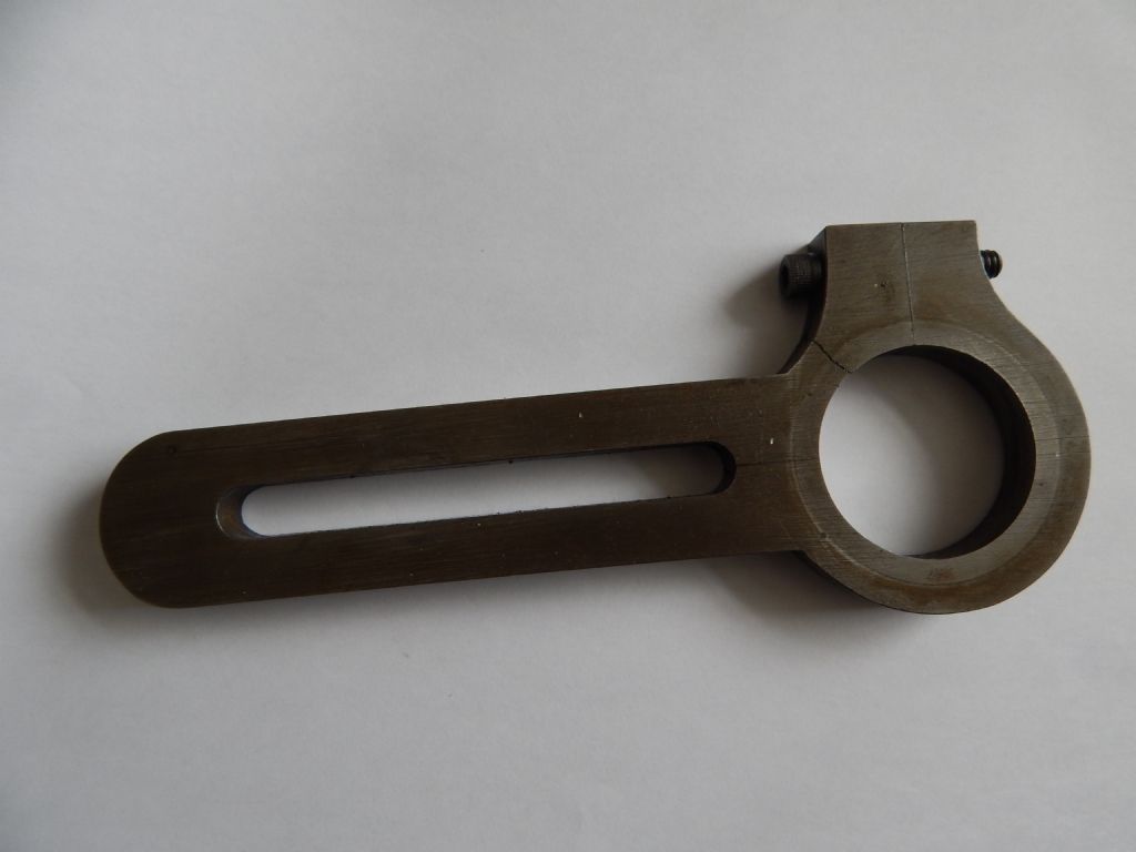

                        I still have to pin the Base I have pinned handle not in this photo with a roll pin . I am not happy with the roll pins i bought so am looking for some better ones. Whilst looking at the position of the gears I noticed that the sadle gear s where not holding in place. I noticed that this was because there was a crack in the bracket which prevented the bolt from locking up the bracket:

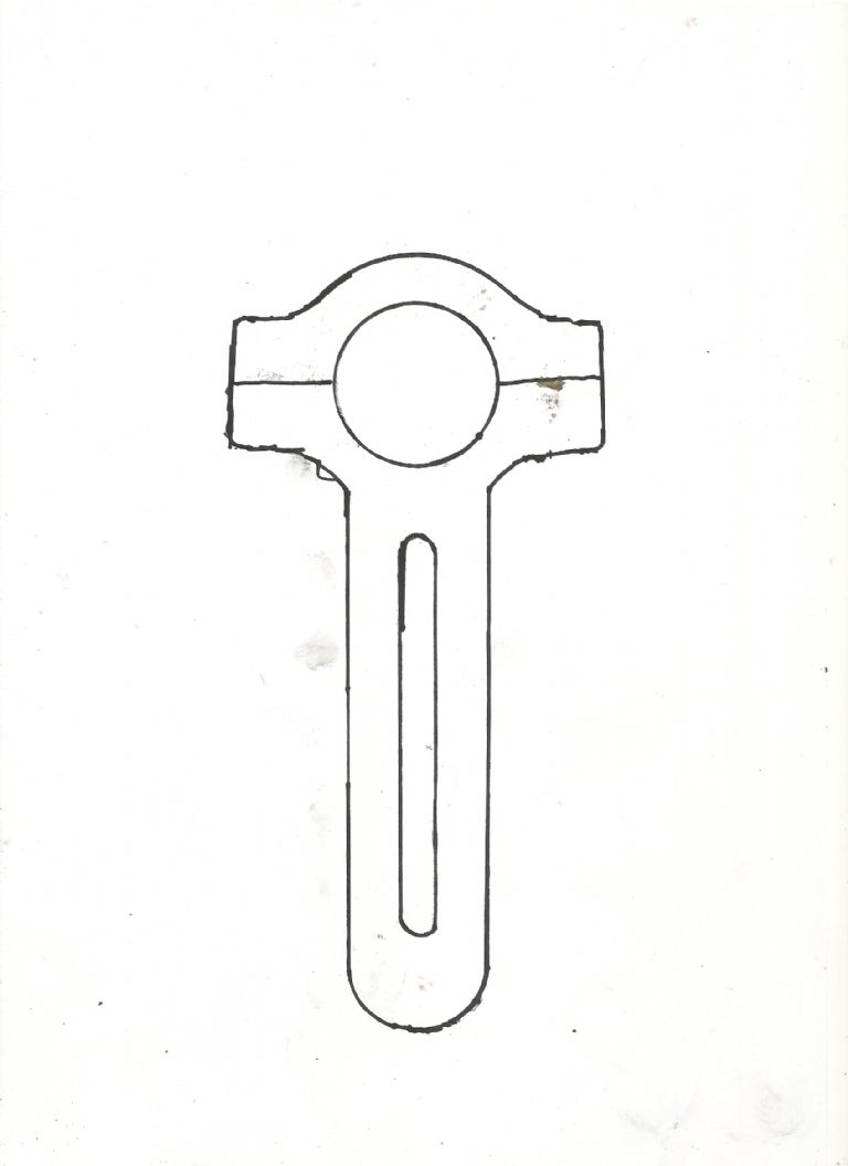

                        After fiddling with the gear train for the sadle I removed it as I nnoticed it was not holding tightly
                        This was a bit of a blow as the crack is from the casting material presumably the slag was in it when it was founded and cast. I have been thinking about this design and have to wonder if it not a good design either. I am thinking two bolts would be better like a piston con rod:
                        gear holder possible improvement
                        Anyone have any thoughts please?

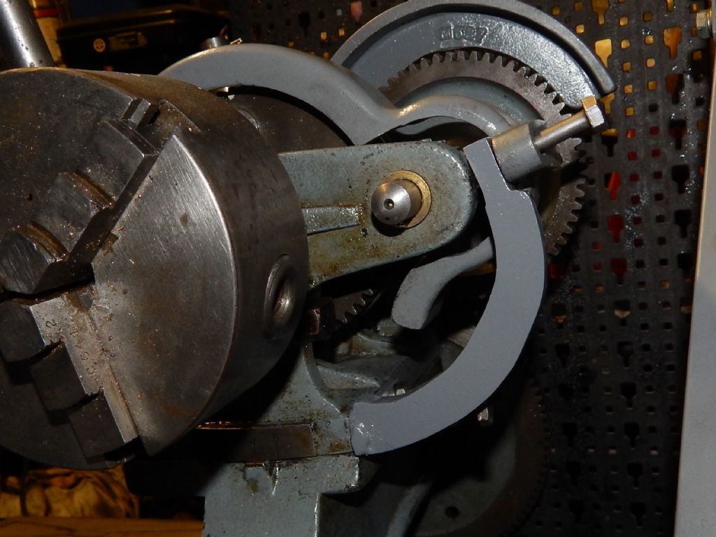

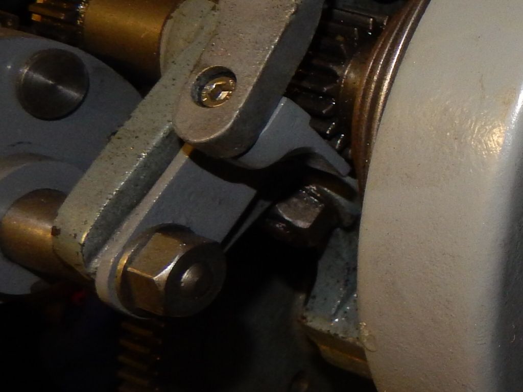

                          built bracket for front cover today. Its not the best and has to be removed for tapering but seems to hold Ok. Will attempt the rear at some point still no news about motor .
                          Well had time today to think of what to do next I had a cover painted from a Myford ML4 and decided to make a front mount

                            Had a bit more luck today . Was trying to locate a position for the rear bracket that would encompass the front off side . This did not go to well however . The bracket i made I cut in half and made into the other cover bracket. This is now bolted firmly in place unlike the front. I slotted the front bracket so that the lathe head could still be rotated and the cover would remain in the correct orientation :
                            found and made bolt holes for rear cover

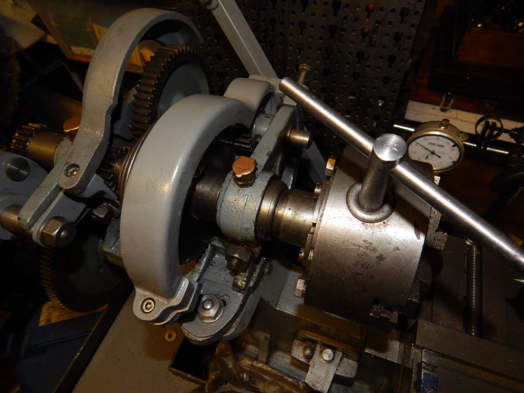

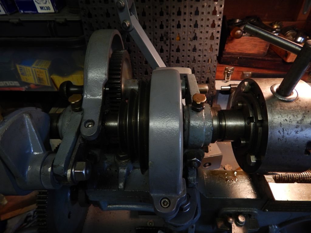

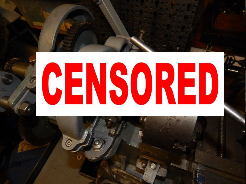

                              Well covers are finished to fit the front two gears. They came from an ML4 but had no clue how they fitted so used some artistic license here is what they look like.
                              New ML4 covers fitted
                              New bracket for ML4 covers

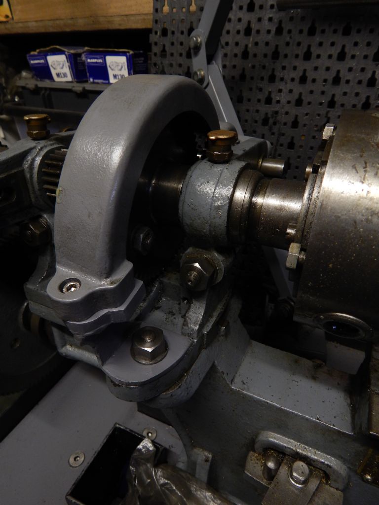

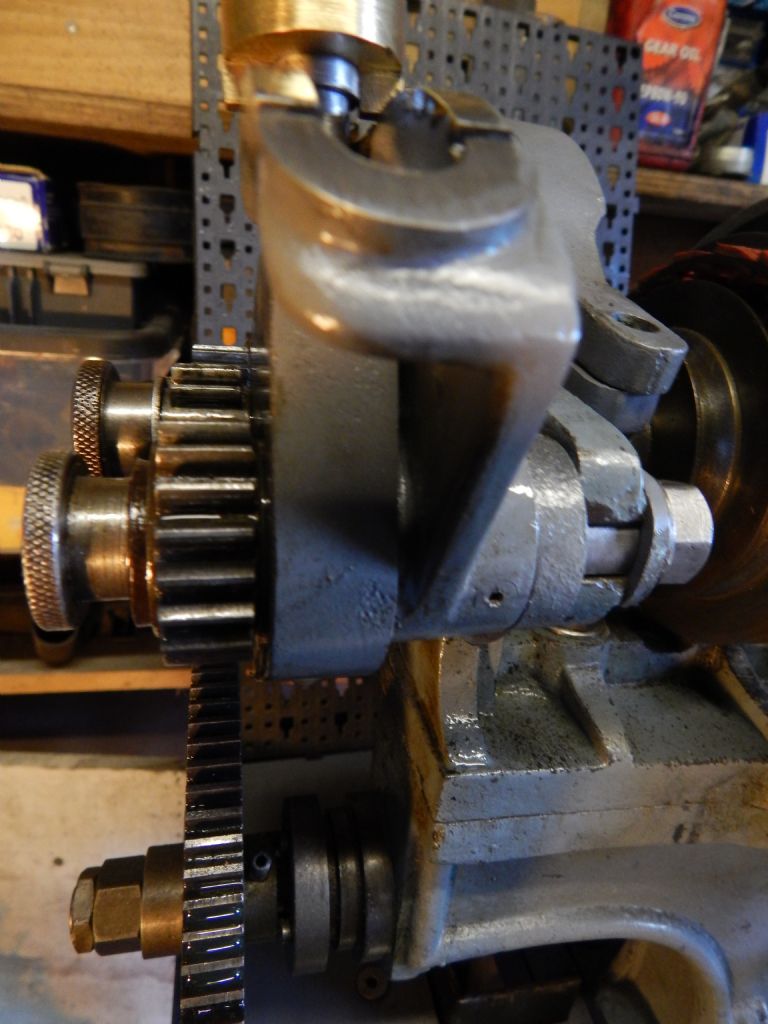

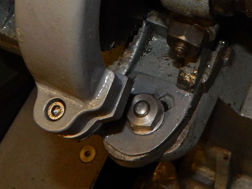

                                Close up of two of brackets . The rear is really good as it holds tumbler in to arm
                                bracket made for rear cover
                                The front is just made out of iron
                                bracket made front nearside cover
                                #241378

                                  Posted by Martin Newbold on 28/05/2016 15:21:06:
                                  The crack in the casting is more the result of bad design rather than just over tightening. The pinch bolt should be much closer to the diameter of the bore. The bolts purpose is to reduce the circumference to achieve the clamping action so the closer it is to the bore the more effective it is. Being positioned so far out introduces a bending moment in the casting rather than pure tension.
                                  Having the casting thicker (at the point it broke) than the rest of the 'band' round the shaft would have helped too. It might be an optical illusion but it appears that where it broke was actually the thinnest part.
                                  Your proposed design will work just as well, its just a matter of however you want to make it.

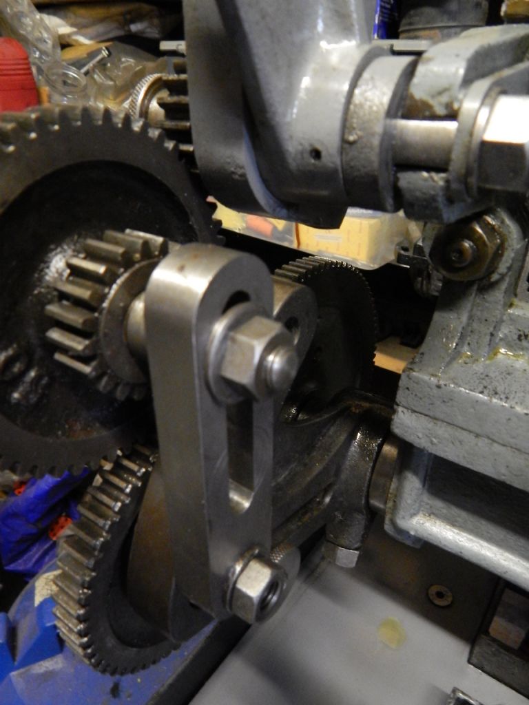

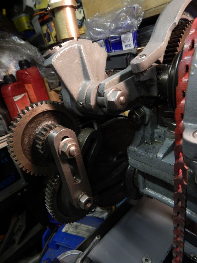

                                              Recieved new bracket for gears over weekend and had to mill 1mm of inside to get it to fit did this today and tried mounting really not sure what RPM is is but its all connected . I was hoping to turn 16mm to 19mm sleave up to try it out but flat pulley would just not hold on the belt long enough.
                                              new gear bracket . Had to remove 1mm from inside to fit
                                              gear brackets

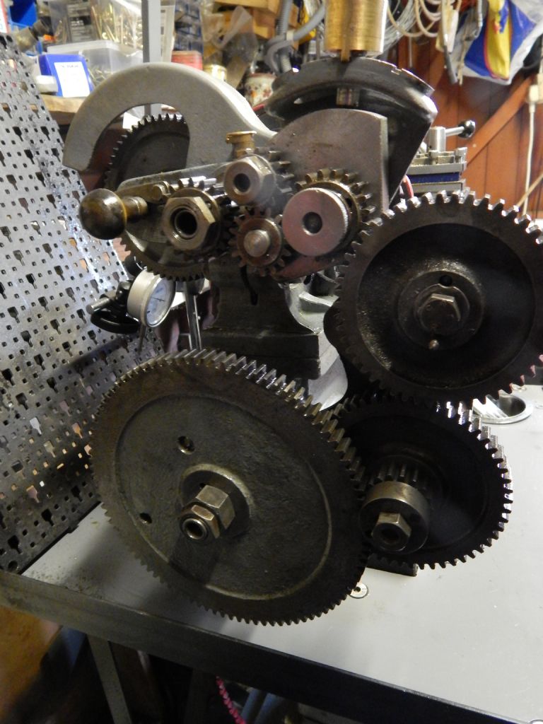

                                                      Well after first tests with the reverse tumbler it was apparant th elathe has no auto stops be ware so you dont break a gear pin I re drilled my roll pin hole in the reverse tumbler to take 4mm pin as was noticing that the back section was movig slightly preventing neutral or no gear selection. Whith this done I made some new spacers to space the gears in line
                                                      Back ofgears and tumbler
