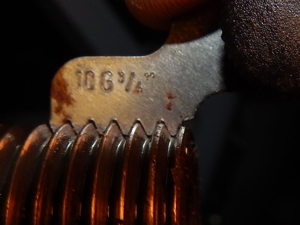

              Hi Martin I think you have a non standard spindle ! early ones 02-03 had a 3/4 w, late 03 onward 7/8 w spindle nose thread.. A myford type adapter is simple enough just a flanged bush threaded inside to suit spindle nose, thread the outside to 1 1/8 w. while your at it 24×1.5mm is another handy size to have.. As for the tumbler gear not to hard to reverse engineer though you may need oem type L shape banjo. The non standard spindle may make things a little difficult !…….b

                Hi John Inverter has gone back to AAB as the dealer would not handle it a well known internet company with supermarket in its name . The Motor TEC have been in contact with them and expecting a call today . Its lucky I had the lamp on it as it took the brunt of the load discharge not me thankfully.

                  Hi there Bodge,
                  Here is thread on my lathe 3/4" w so probably 02-03

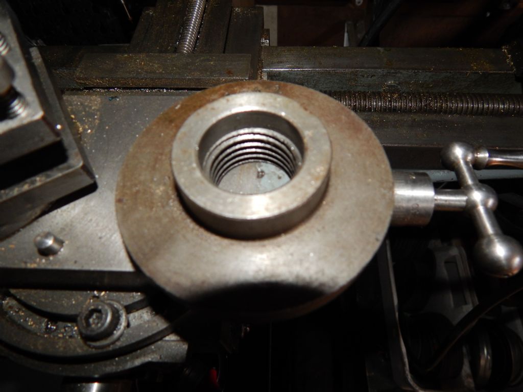

                    Hi Martin
                    Could you please measure major out side dia of the thread, because your caliper is showing an inch near enough on the register and im not seeing any step down to 3/4 in. the point being if you cut a ten tpi whit thread on 2 inch dia bar your gauge would still fit perfectly showing you had 10 tpi witworth 55* thread, i dont know for sure but i think the dia stamped on the gauge just refers to it being an industry standard in as much as you can buy a tap and die that size ie 3/4 in. As for year of manufacture i think you have a really early one, what might be called a pre production model ……..b

                      Bodge . I think that is the shoulder you are referring to . The thread is.major 09845" or about 25.1mm. The gauge I used was a Draper No 553 BSW 4-62. It was made in West Germany if that helps I think the G is tome German na,e as its TPI as in 10

                        Martin. As i understand it that would make it a 1 inch by 10 tpi w spindle nose thread, To be 3/4 x 10 the the od of the thread would need to be a few thou less than 0.750 inch………b

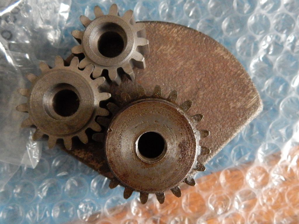

                          Am slowly obtaining these parts for this tumbler reverse gear . They are quite hard to find you are right about that , I just need one more 20T 14DP gear to finish the gear parts. Have been laying them out to see how they will interconnect , Geoff has been lovely and am so pleased to have the castings . Which I never thought I would obtain and have to make from steel block.
                          Gears

                                  Hi Bodge , Thank you perhaps this will help the odd thing is that it came with what looks like a Myford M Lathe chuck Plate that fits it it has V 1012 on it. Can this be identified

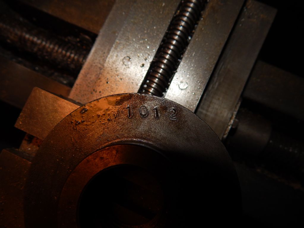

                                        Martin, at a guess i'd think the numbers on your back plate pic would indicate 1inch od by 12tpi, were early Drummond m types that size ?. I think the latter Drummond/myford were the usual 11/8x12tpi with a plain register ie not stepped like ml7. I tried to mount motor under the bench cos i would have liked to have kept the cast iron tray, did get it going that way for awhile but wasnt really happy with it, its much better how it is now. I think you have done pretty well to track down the castings & gears for the tumbler reverse though, i`d pretty much resigned myself to mowing them out steel if i ever get round to it. The head stock you have pre dates the production ones so would not take things for granted as regard to spindle size…….b

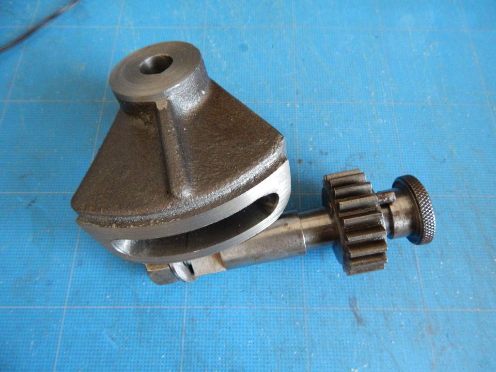

                                          Hi Bodge , yes i was originally going this route making the shapes from mild steel for the tumbler but it was quite a bit of milling and one of the forum members put me in touch with a lovely chap who had castings and smaller gears . He has been very well informed and nice and I am pleased with the castings and gears.
                                          I put up the back plate on here as was hoping someone could identify it from the numbers as I could only give the information I have it is around 1" or just under. I know my machine has been changed but not used by the previous owner for at least 50 years or so so the changes or any changes predate this date. Its pretty much as it came and made the table etc to mount it on. I believe he built it from an sale of a closing shop many years before.

                                              Martin have read your last post with the pic of reverse shaft, i made one quite while back, the smaller dia of the shaft as show`n should be 5/8 running fit in the gear wheel, its usually called the reverse stud, by the L shaped bit do you mean the banjo arm?………b

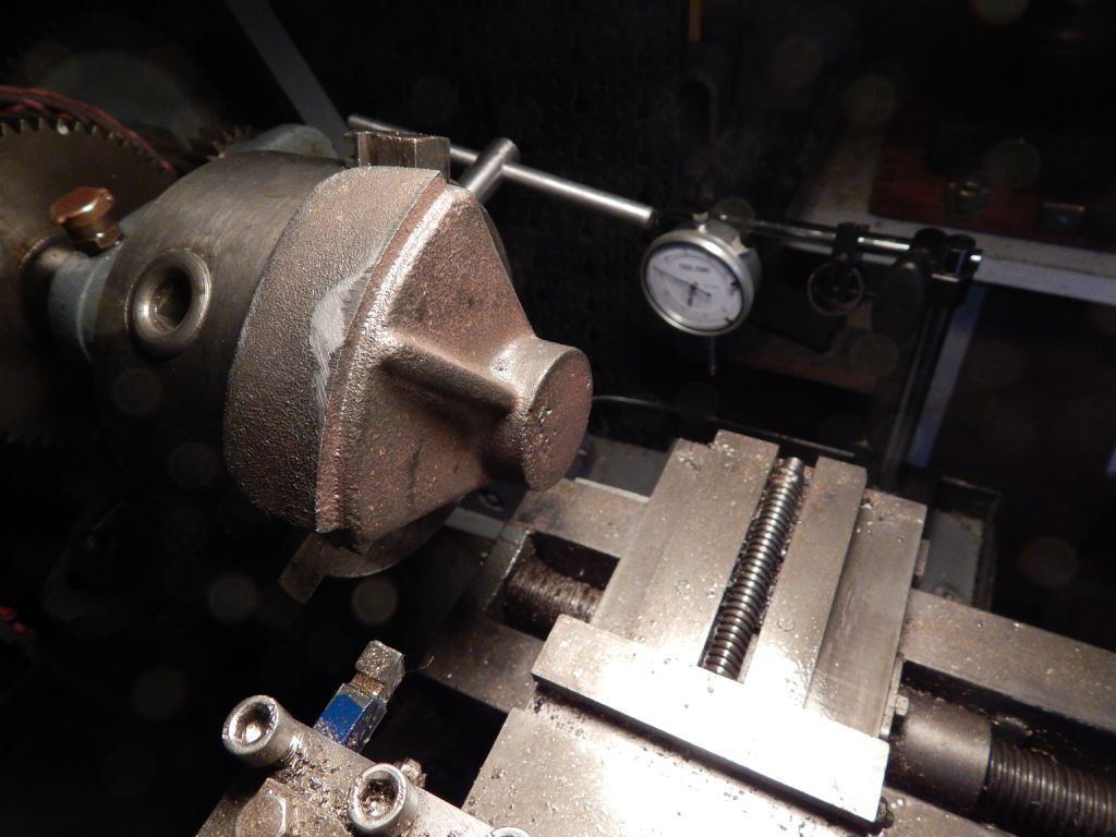

                                                #237601
                                                Martin Newbold
                                                  @martinnewbold

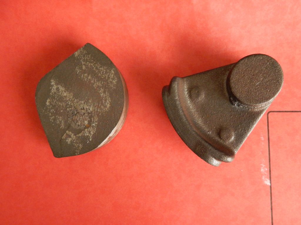

                                                  Hi Kieth , Bodge , I did some work on the back section of the casting of the tumbler this week . It pretty much went ok but the casting on the inside is not central as i anticipated. I am reasonably please with it I havent drilled out to 3/4" yet just 1/2" I was awaiting the reverse stud to see if it was indeed 3/4" which it is as I have now received it :
                                                  #237641
                                                  bodge
                                                    @bodge
                                                    Hi Martin, Nice pic, its all looking really good !. any good news on the motor drive ? ,check your in box pm`s sent .
                                                    Regards………….b
