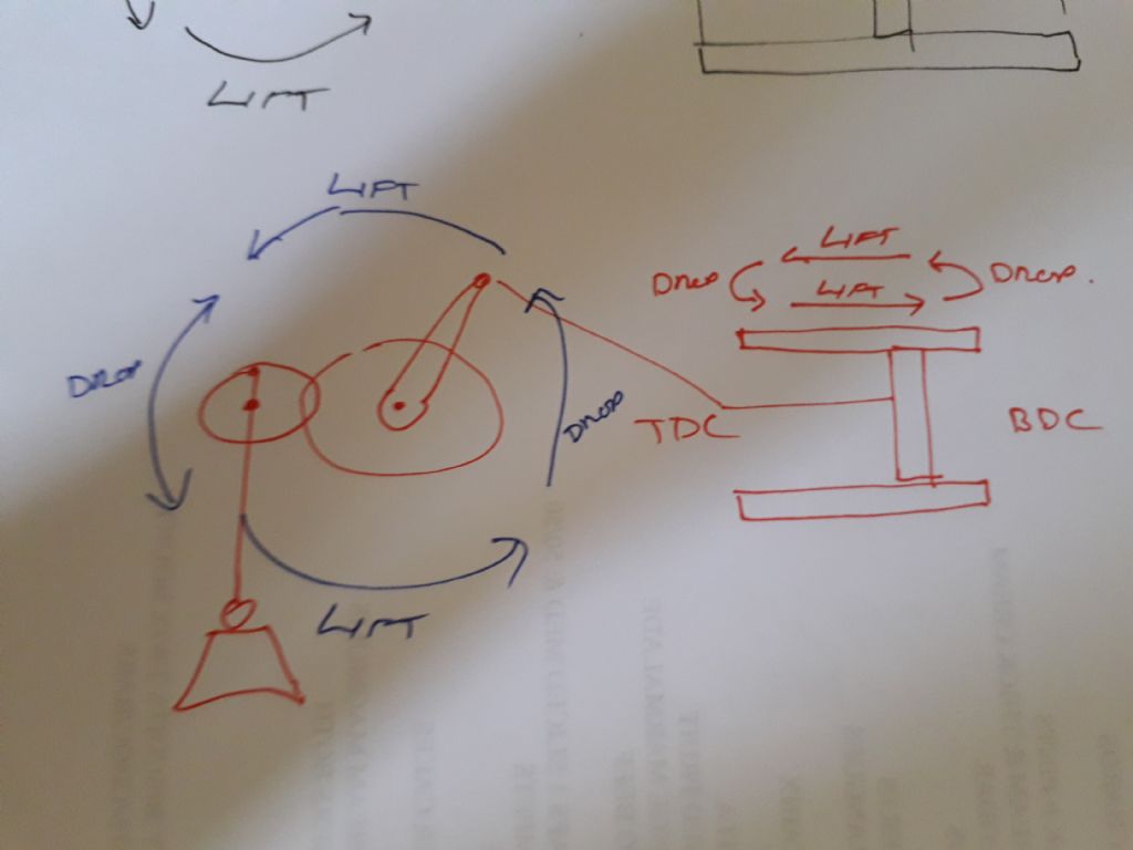

      I know it sounds daft but wondered if it had been done using a vertical weight raised by the power stroke. It'd still need some sort of crank to get round the dead centres? But if one was after a reciprocating power output (as in saw/filer) it might be more compact?

            Don't see how that would work…If at TDC, what would make the crank continue round – and if there is some strange force that could make it turn, why not turn the other way – its 50:50 as to which way it would go then as its only a weight pushing down linearly. How would you generate the reciprocating motion if starting with rotary motion? ( In your saw/filer..) If not starting with a rotary motion, then a piston arrangement, air/steam/solenoid driven would work fine, but has no need of a crank – other than the operator…

              Would you have to gear it 2:1 as you say you want to raise the weight on the power stroke so most steam engines are double acting but that may help if the dropping weight were used to carry it over TDC and BDC

                    Please explain the motion – the statement 'Steam pumps seem to manage OK' is pehaps just a little arrogant…
                    pgkpgk implies/mentions/questions a crank in the process – your statement implies no crank, but a double acting piston cylinder arrangement – in which I presume the piston is forced one way by the pressure of steam/air/ or whatever, on the one piston face, and when topped out, the force is applied to the other face, pushing the piston the other way. There is no crank involved, and so the discussion is moot.
                    You statement still talks of BDC and TDC, so , mixing concepts again, I assume you are converting linear motion to rotary – which was not part of PgkPgk' question, but nevertheless, the same problem manifests – if there were no flywheel impetus at all, there is no reason for the crank to go round once TDC or BDC is reached.
                    Perhaps PGK could explain a little more as to what he has in mind?

                      2nd one down is what you need
                      Posts crossed, I don't see the need for a crank on a filing or sawing machine and like above shows TDC would be when piston is at one end of stroke, BDC at other

                        I can see Jason's suggestion of 2:1 gearing working.
                        You could even use a spring which would be even more compact.
                        I suspect the answer is partly the extra complexity and partly that the energy stored by a flywheel is related to the square of its speed, while the energy in a raised mass is directly proportional to its height.
                        This means a flywheel can give proportionally more energy for a small change in speed, and as the purpose of such a devices is to reduce the change in speed over a rotation a less massive flywheel will do the job more efficiently.

                                      So if you did want a crank and TDC/BDC this is how I saw the geared weights working.
                                      The double acting piston would connect to a crank and then to a crankshaft. large gear on the crankshaft would drive smaller gear at 2:1 and weight suspended from smaller gear. on the two power strokes from 45deg to 135deg and 225 to 315 the weight would be lifted. Before the piston gets to TDC or BDC the weight will start to drop and by driving back through the gears will pull the crank over BDC & TDC.
                                      Saw or file could be driven by a second crank off the shaft or linked to the piston one.
                                      That's how I see it working but the saw/filer may jump about a bit as the weight goe sup and down

                                          As I said, that is a double acting cylinder with NO CRANK. Obviously such a mechanism works fine – the motion is generated linearly from the start – there is in fact no TDC or BDC – the motion changes direction when the appropriate valve is actuated.
                                          If PGK drops the thought of a crank in his mechanism and uses a double acting cylinder, then , well, nothing to discuss..
