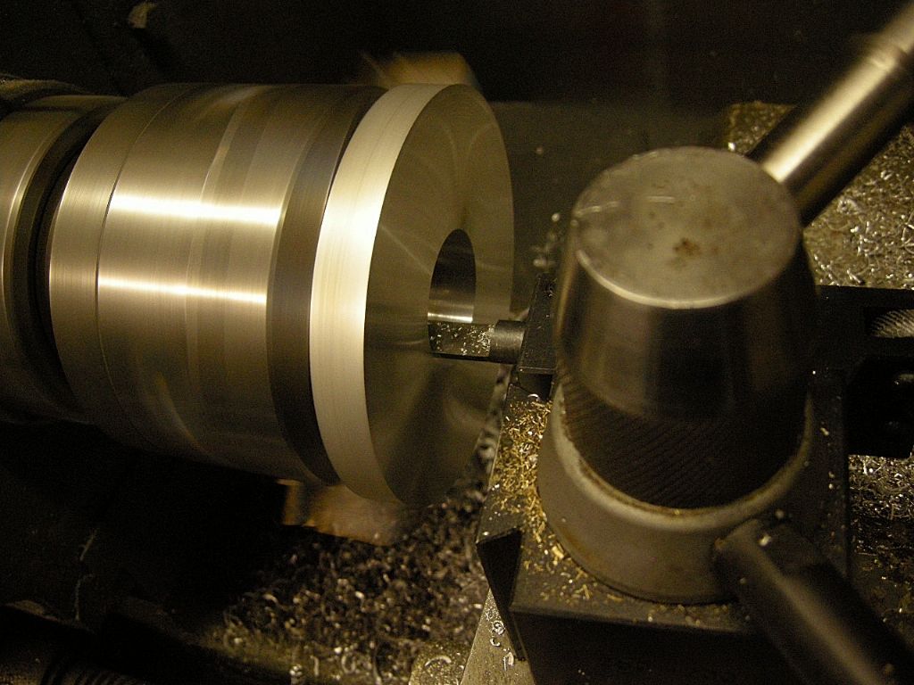

            Jon
              @jon
              You don't say which grade of stainless G303 is regarded as machining quality, G304 still highly workable, though G316 can be problematic certainly the S11 and G321.
              Best way as above but no need to pilot drill or even drill, if boring is on line it will cut the pip out the centre.
              Heres one done earlier about 14 years ago 44.2mm bore x 15 deep from memory. For this purpose using 28mm drill just to create a hole, you cant do that. Angle boring bar in to work not at 90 degrees and drag it out. Face off tot depth no drilling straight in.
              Bore

                    #169438
                      Neil, it depends on the size of your tool, this is a 4" dia recess 3/16" deep in an iron casting, no problem with a medium sized boring bar of 10mm dia, as KWIL says you don't need much overhang.
                      #169458
                        Agreed, that boring tool is effectively my 'end on' knife tool, my 10mm boring tool has an angled 1/8" toolbit for jobs like this and would take ages, while the bits that suit my boring head aren't particularly good angle for rapid metal removal either.
