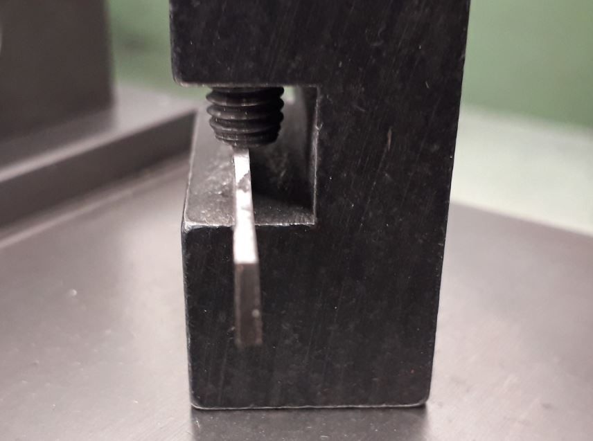

      Hi all
      just received rear parting tool from Cowells and upon installing parting tool even with as much packing as I can fit in, the cutting edge ( but on the bottom as it’s upside down) it is still 1.5 to 2 mm lower than the dead centre in tail stock, any suggestions?
      Thanks in advance Dell

        #450201
        not done it yet
          @notdoneityet
          You could put it the normal way up and run the lathe backwards – as long as the chuck cannot become detached, of course.
          Or you could put some raising material under the tool post?
          Can’t think of any easier ways.

            Pretty obvious answer is to contact Cowells on Monday morning and tell them the problem, they should be able to provide you with an answer.

              I cannot run it backwards as the chuck on a Cowells 90ME is threaded so it would unscrew, and I have sent a email to Cowells.

                Thought about it again, just now. Another alternative would be a parting cutter (tool) some 2mm+ less than the one you have received.🙂

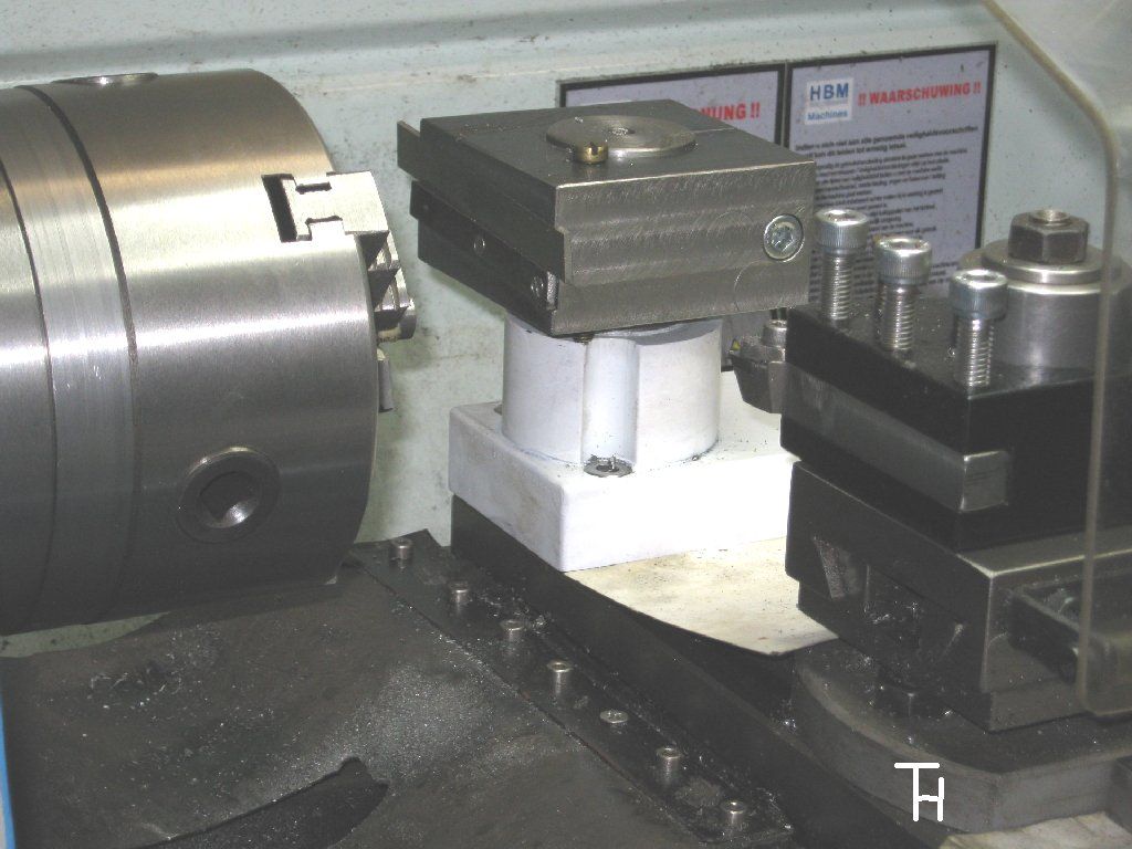

                    I made a rear parting toolpost for the Smart & Brown model A which takes industrial 26 and 32mm blades. The top half can be turned around and it is positioned right on the edge of the cross slide. No adjustment is required, as the carbide inserts are not ever sharpened. Because the forces are upwards, I also added a rear saddle lock, which was easy as the rear screw hole for the travelling steady was in exactly the right position, and the locking screw passes through the existing tapping in the saddle. The locking clamp is easy to remove if the travelling steady is used. It is visible in the picture.

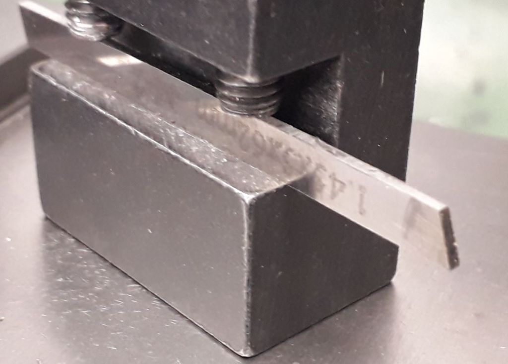

                              7e0afbed-5e2e-450b-8fbd-00956007bdb9.jpegThanks for replies
                              If I shim just the front only the leading edge will it be stable enough as I have put it in without shims and held it at an angle and it lines up.

                                  Derek, The Cowells is intended to use 1/4" or less tools your combined blade and holder is approx 8mm that is why you can't get it high enough

                                    There looks to be a lot of overhang on that setup, just be aware that the tool and its holder will flex when taking a cut.

                                        I agree with Jason the toolpost is "old school" and designed for quarter inch tooling.

                                          The overhang was just to set the height to centre and yes I can use a 1/4” HSS parting tool but some of the things I intend to make are 45mm diameter in brass so an HSS parting tool is not going to cut it ( pun intended ), if I make a wedge to set the tool on a rake would that not work ?.

                                            If you are careful to make sure the cutter does not get tilted sideways it is possible to just mount the HSS bit that you show in the toolpost without the holder, might just mean you can't get quite as close to the chuck jaws but only by 1mm or so.
                                            There are also other designs of holder that would allow you to use the same type of tapered section tool but mounted higher up.
                                            The problem with tilting the holder is you will get more negative top rake, may get away with it on brass but not dood for anything else. Also if you want to move the blase in and out it mucks up the ctr height, those 1.5mm blades can easily flex sideways so for your 45mm dia cut you would want to start with say 10mm protruding then extend another 10mm and finally a bit more to reach right in to the ctr.

                                                  So first option is to do away with the holder, you will probably have to stone or grind the bottom of the tool flat as they are usually slightly angled otherwise the srews will try and tilt the tool, a small packer on top can also help.
                                                  The alternative is to use a holder like this one from Chronos that positions the 5mm high blade central to the 6mm part that is held in the toolpost rather than above it like the one you currently have. Not actually tried one of these but should think it will fit the Cowells.

                                                    If using tee slots for the rear toolpost, I would definitely make use of two for stiffness. After all, stiffness and the inverted tool are the main advantages over compound mounting.

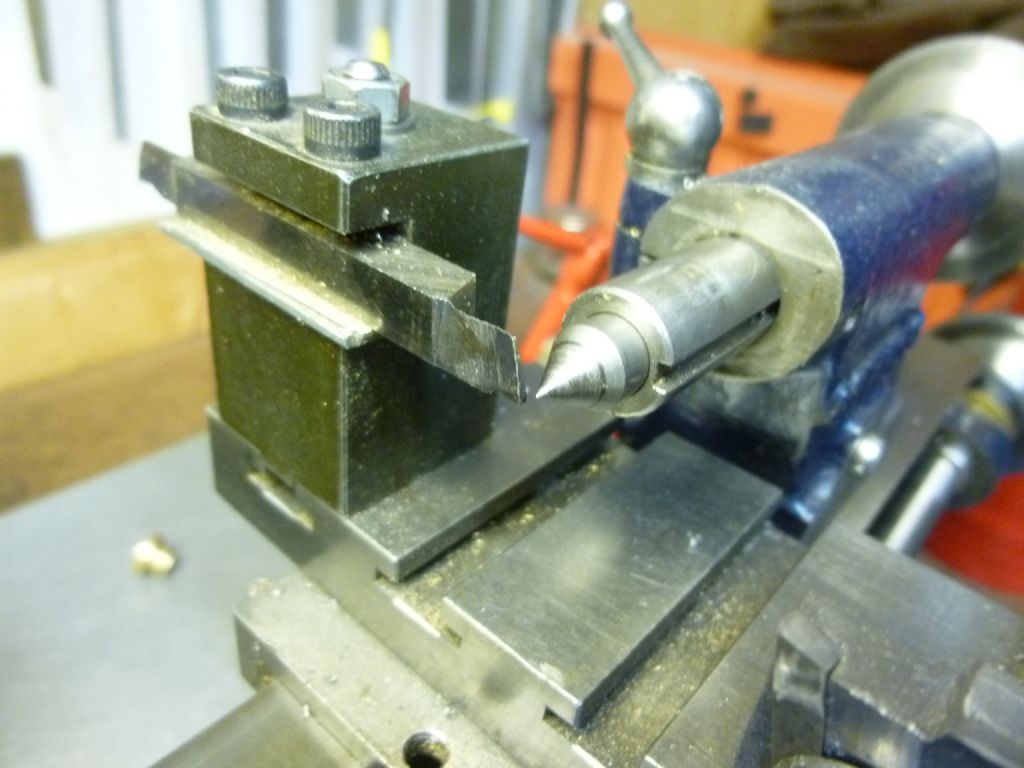

                                                      You actually have a good way forward because the toolpost is low. Get a plate say 1/4 in thick and big enough to go under the toolpost and out across the second T-slot like the one in Phil's version. Bolt this to the underside of your toolpost with 4 csk screws. You could even consider making these small brass screws so they can failsafe.
