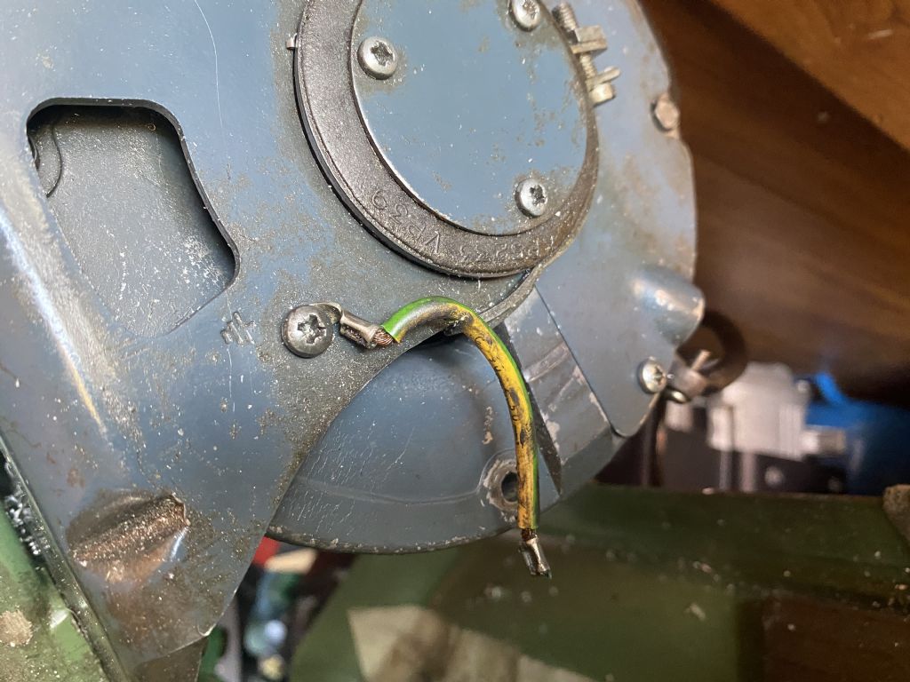

      Hello everyone, needed your input on what might be the possible problem on my S7 motor. Its been ok since I have my lathe over 5 years now and it never failed me once, ok a few times it tripped my RCD but after reset all is well until 2 days ago. My lathe is in a well ventilated shed and I doubt moisture is the cause as all my other machines are ok and its been in my shed for the last 5 years.
      When I turned it on there was a "clicked" and everything went dead. So I went to reset my RCD knowing it will be ok but when I tried to switch it on it tripped the RCD again and not even a click on the motor. Wires are all ok, plug fuse is new and i could not smell any burning wires. The rest of my tools are ok so the wire to my shed is all intact.
      The motor is the original Myford motor. I do have a spare stored away but I need to access it once weather is ok as its buried deep and I don't want to take things out yet. Motor is a single phase by the way.
      I was wondering did I fried the motor?
      Is the start capacitor the problem?
      Is it moisture?
      Hope you guys can help me out as I'm useless at electronics. I tried to search the web but I gave up at the end, guess this is the easiest way out. If you guys think its inappropriate for me to ask a silly question then mods can just delete this thread. Thanks in advance!

                After a period of cold weather followed by a few days of warm weather moisture condensing onto cold metal can cause problems. It will sort itself out after some time but poorly ventilated areas will take more time than well ventilated ones. Since motors and switches tend to be poorly ventilated they can take a bit longer than expected. Given the recent weather condensation would be my prime suspect.

                  Hi Raphael, I would recommend that you disconnect the wiring at the motor and make the ends safe, either connectors or insulating tape. Then power the lathe up, if the RCD trips then the fault is in the wiring or the dewhurst switch. If the RCD doesn't trip then it looks like the motor. Unbolt the motor and take it indoors, put it somewhere warm and dry for a few days. Refit the motor and try it again if it still trips then you are going to have to get the motor looked at. Hope this helps Tom.

                            As said the problem could be in the switch but I believe more likely to be the motor.
                            If there is a short circuit live to earth or neutral at the motor repeated closing (switching ON) of the switch will cause further damage to the switch contacts.
                            If the trip is a balanced load type even a neutral to earth fault will operate the trip.
                            Check all wiring for damage and tight connections.
                            Is there a capacitor fitted ?
                            Ideally you need an insulation resistance test meter (Megger or other make) to locate the fault without causing further damage by making the faulty circuit live.
                            You may be lucky and locate the fault with an ohm meter.
                            Good advice given given re condensation in motor or Dewhurst, check the Dewhurst for signs of tracking between contacts and earthed metal.

                                                      Good morning to all. After following all the advice here I managed to fix the motor. Thank you to all who have chipped in their advices and instructing me on what to do.
                                                      This is the culprit, this wire I believe is the earth. Repeated rotation of the motor caused it to rub on the housing and the wire plastic over time becomes brittle and the mounting snapped. The wire then went inside the mounting where I could not obviously see and seems to look like its still connected and Its likely shorting out and tripping the RCD. I cleaned everything dried up the motor for a good 1 hour with the heater and replaced the wire and fully tightened everything. I also cleaned the dewhurst switch and dried everything up. Restarted the motor and all went well. I will get a NVR switch as advised. Again thank you all for helping me out.
                                                      Best wishes to all,
