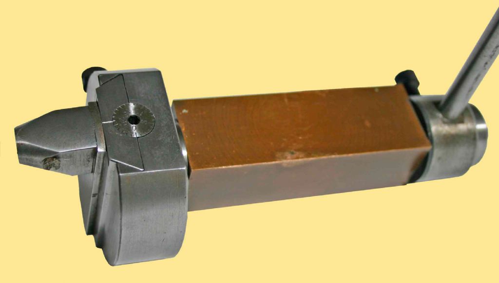

       With this set up is it posible to turn a complete ball and part it off
      Nobby
      #21777
      Nobby
        @nobby
        #61877
          No, the part holding the tool will hit the bar the ball is being turned from before a full shere can be cut.

              Hi Sam & Jason B
              Thank you for input on this issue .I made a radius attatchment using my boring head I made .as you may have seen on my uploaded photos . I will try your cranked method.
              Regards Nobby

                Nobby
                 If you look at the tools in this radii cutter you will see the one at the top
                is cranked. this allows you turn spheres.
                tomk

                Nobby
                  @nobby
                  Hi Tom K
                  Thank you for info  The boring head one i made was used mainly for turning radius electrodes for the sparking m/c with a micrometer adjustmet i could turn to the  size required by adjusting the dail .
                  Regards Nobby

                        Hi Sam
                        Thank you for information . Its was of great interest. The boring head in the photo can also be screwed  on my Kerrys mill drill arbour
                        Regards Nobby

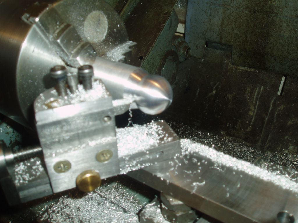

                          Hi Jason B  ref radius dresser
                          I encounted the problem trying to cut a complete ball as the fixture swinging  round would hit the chuck . thats why I wondered how to cut a complete ball .thats why i looked at the up and over way. C.N C users would not have this problem IE start position circle center end postition. etc ( in English)
                          Regards Nobby
                          #62004
                            Thanks Nobby, thats what I was thinking, your type would seem to have better clearance.
                            As you can see with my style of cutter the side of the insert and the post it fixes to gets in teh way when trying to do a full circle. I will make another post to take the longer diamond shape inserts or just a HSS bit that can be ground to suit.
                            Jason

                              I will post a picture of my other rad, cutter and see what you think

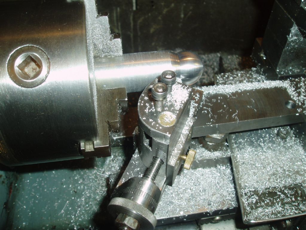

                                                      Hi
                                                      Its a bit Heath Robingson I know  . please  see dail adjustment .Any feedback welcome?  ? note how close to  the chuck in fhoto 3 .Note  angle tool  slot to try and get tool to get round further /deeper .
                                                      Regards Nobby
