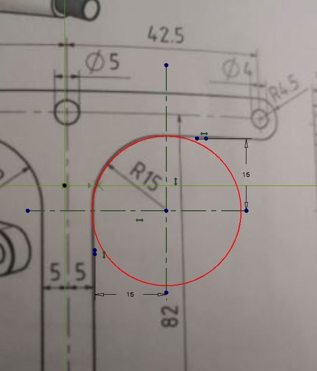

                An example from the drawing:
                Mod edit:  for convenience here it is, and the right way up!
                Edited By SillyOldDuffer on 23/06/2021 17:37:02
                #551048
                  More or less as I said above draw two lines 15mm from each edge of the "tee" shape as you mark out the sheet of metal. punch where they meet and then draw a circle of 15mm radius.15r.jpg
                  When it comes to making the part you may want to make a 30mm dia hole in that location first and then cut the straight lines or simply file the radius after machining of filing the two straight edges

                    In the case of the drawing shown, the exact radius is not vital,and could vary. I notice that the material is not vital either, (ALU/MS).
