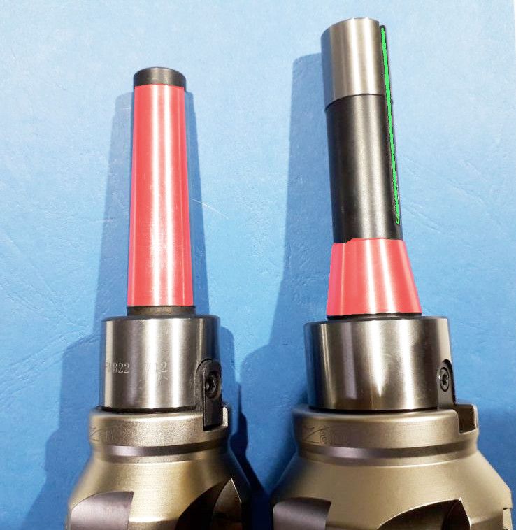

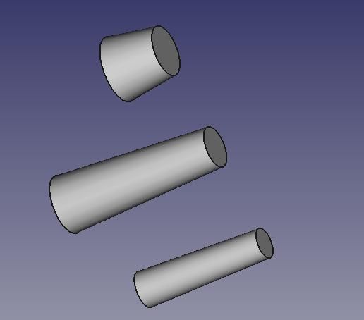

        Posted by old mart on 12/06/2020 16:02:30:
        Size and stiffness wise, R8 is equivalent to MT4, not 3. …
        Not according to my calculations (which are always dodgy!)
        Comparing the surface area of the R8, MT3 and MT2 tapers with a CAD package:
        MT3 is 6105 sq mm
        MT2 is 3304 sq mm
        R8 is 2287 sq mm
        R8 is bottom of the class! Being short and stubby might make it less likely to bend, but flex probably depends more on the heft of the parent mill's spindle rather than what's plugged into it. R8 could be considerably stiffer in a beefy Bridgeport than a lighter Chinese machine. Especially as it's been suggested some MT machines have been bored out to take R8 without beefing up the spindle.
        Always possible I've missed something but looking at the specs the advantage of R8 over MT is quick release and compatibility with other non-MT machines. If speedy tool changing matters, or you own a Bridgeport or similar, go for it, otherwise…
        I felt it would be advantageous for my mill and lathe to share the same taper. Good theory, not so hot in practice. It comes in handy occasionally.

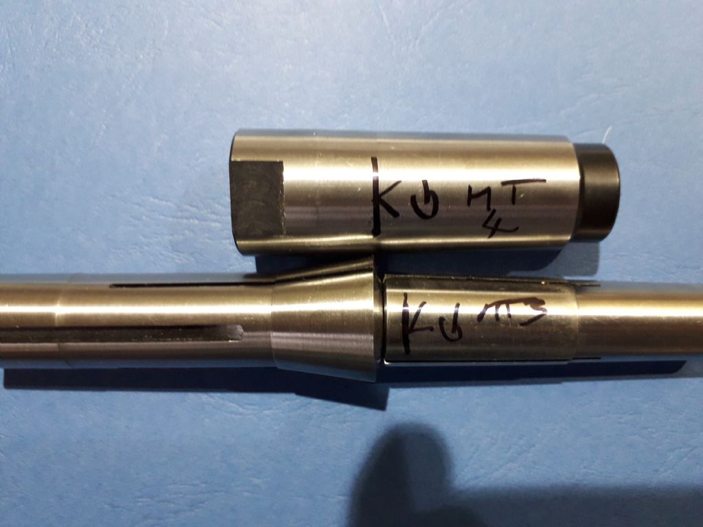

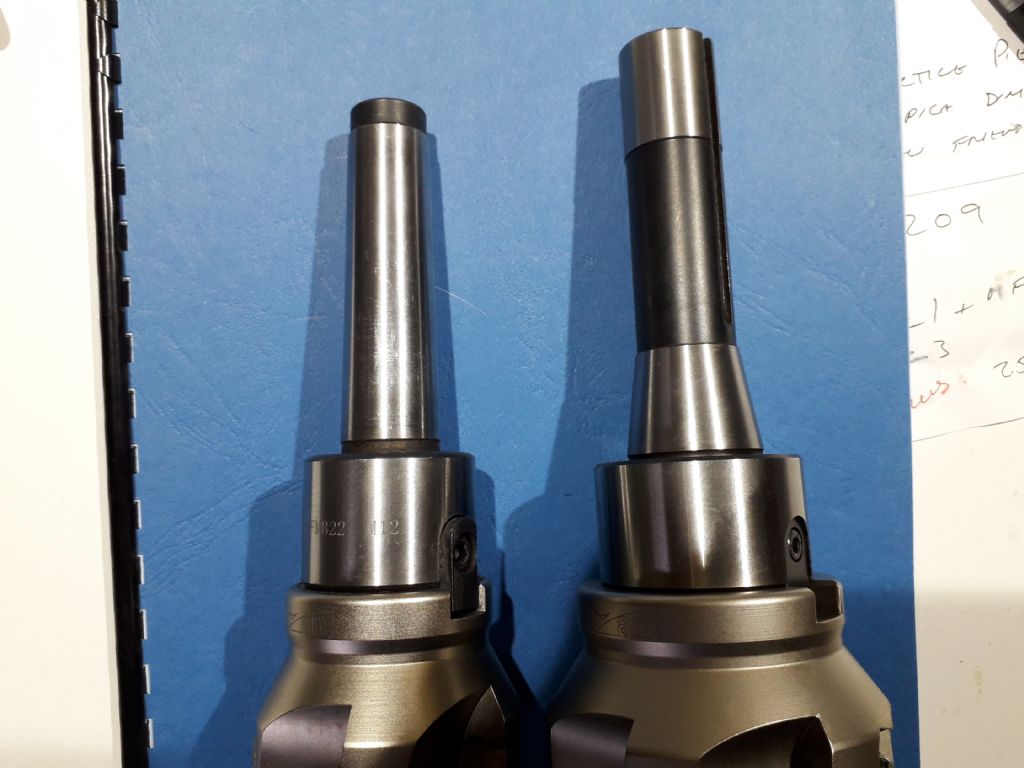

            Posted by SillyOldDuffer on 12/06/2020 17:48:20:
            Think you may be bottom of the class davedevil
            Always simpler when you have the items infront of you. Pic below shows MT3 end to end with R8 collets and a MT4 sleeve above. gauge dia of the sleeve is less than the end of the R8
            And to rub salt into the wounds look how much more metal there is where the R8 taper joins the arbor body compared to MT3
            Edited By JasonB on 12/06/2020 18:36:29

              Dave, you have completely missed the top register on the R8 collet. The stiffness is nothing to do with the taper but is based on the diameter of the tooling where it is unsupported. The length of the R8 collet with its upper register is comparable to M3 so that will not be an issue in stiffness.
              R8 diameter where it exits the spindle about 30mm.
              MT3 diameter where it exits the spindle about 24mm.
              MT4 diameter where it exits the spindle about 30mm.
              Martin C

                          Posted by JasonB on 12/06/2020 18:30:18:
                          Always simpler when you have the items infront of you. …
                          Who me, get it wrong? Never happened before!!! blush
                          Maybe this is my Waterloo and I shall be off to Saint Helena to think about my crimes! But first, I shall sacrifice the Imperial Guard.
                          My case against R8 was based on looking at a drawing, not the real thing. The surface area of the R8 taper is small compared with MT3 (and MT2) as shown in pink:
                          But what's that highlighted in GREEN? If it's a key-way, I'm in the poo again! Of course it's a key-way…
                          embarrassed
                          Very educational this forum!

                                      SOD, your illustration with the red highlights conveniently leaves out the top end of the R8. Why is that?
                                      The point where the lack of diameter in the MT3 makes it more  flexible than R8 is where the tool emerges from the spindle.

                                                    Ah ha, I'm not explaining myself properly!
                                                    There are two different desirable features in a milling machine's tool fixing system:
                                                    1. It's ability to resist sideways bending, AND,
                                                    2. Being able to transmit torque to the cutting tool without slipping.
                                                    The top of the R8 is a parallel register and no doubt it improves stiffness. On that point R8 is better than MT3 because MT tapers are slimmer. But I didn't colour the register top because it contributes nothing to power transmission. ( I believe!)
                                                    It's point two that has me worried. The R8 taper has a small surface area compared with MT, and power handling depends on it, just like a clutch. As the amount of friction between taper and socket is proportional to contact area, taper angle and drawbar pull it seems likely to me that R8 can't transfer as many watts to the cutting edge as MT2 could without slipping. Unless R8 drawbar force is higher than applied to MT?
                                                    I thought the key-way explained the difference, but owners say the R8 key-way doesn't transfer power.
                                                    I'm not convinced MT tapers are much less stiff in practice than R8 either. On their own, maybe, but when cutting they're supported by the mill's spindle.
                                                    Couple of unanswered questions:
                                                    • Any evidence that MT tools bend?
                                                    • Any evidence that R8 tapers slip?
                                                    The answer to both in normal conditions is likely 'no'. If MT doesn't bend I suggest it's not worth paying extra for R8 on a small Chinese Mill, and if R8 doesn't slip it would be daft to replace it with MT on a Bridgeport!
