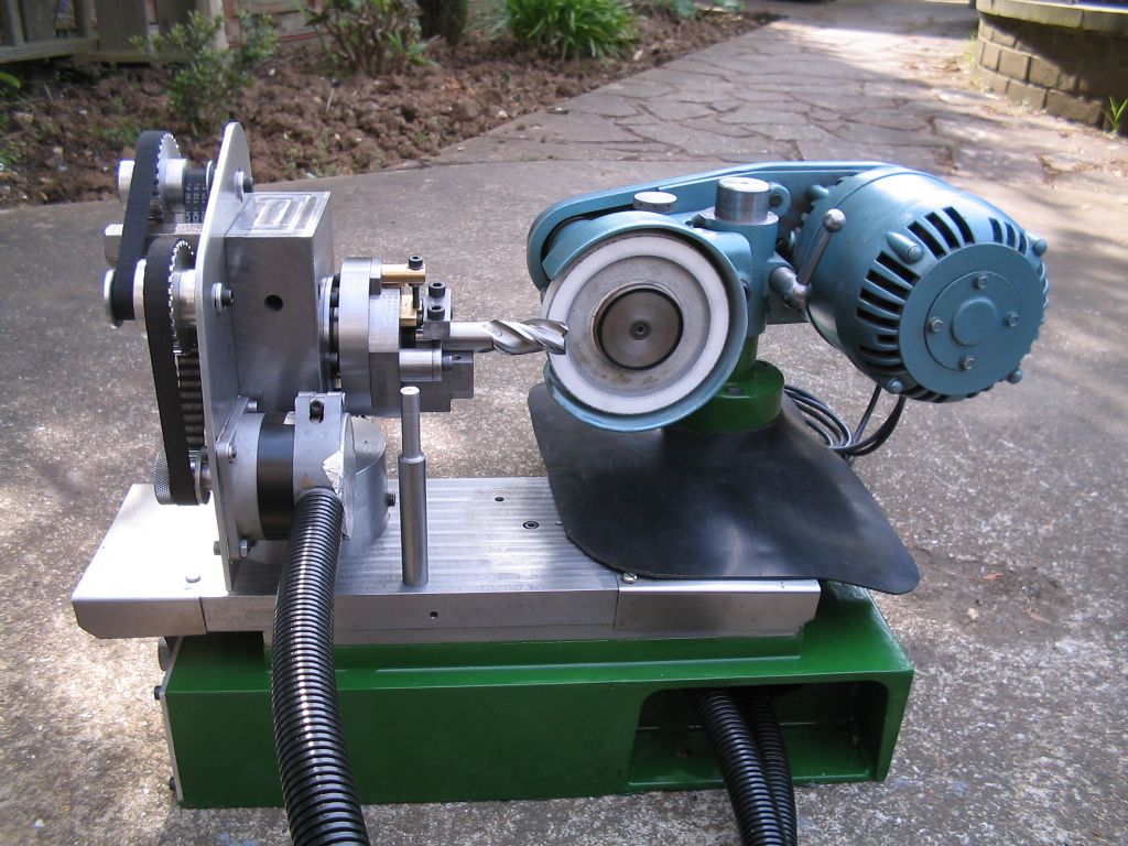

                In the time since then i made this cnc grinder which uses the Quorn
                head, up to now i have sharpened hundreds of cutters along the flutes
                from 2,5 mm dia to 20 mm dia all of the cutters that i use, they
                all come out as sharp as new cutters and in some cases sharper than
                new cutters from some suppliers.
                The resolution of the machine is 1/20 th of a degree and as such the
                clearance angles can be set with this sort of accuracy.

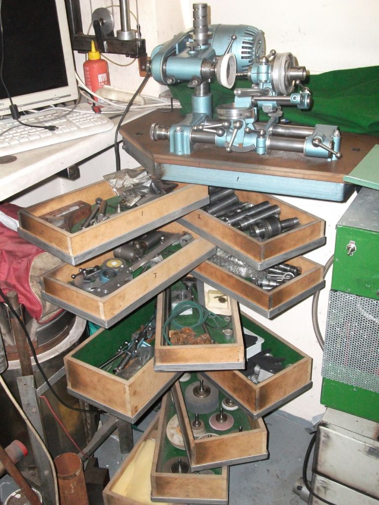

                  Nice looking Quorn and a very well planned nest of swing out drawers, is that your design ?

                    Just a matter of space saving ,some angle iron supports hold
                    the wooden trays on a single strut.
                    The photo shows in the foreground a post that is secured to the
                    table, this is a zero reference to the workhead axis,using a
                    dti the tip of the cutter is set to a zero position using
                    this reference.
                    Looking at the photo rotating the cutter anti-clockwise
                    increases the angle from zero to the desired amount .The
                    grinding wheel is at a shallow angle relative the the work
                    axis ,as can be seen by the black line around the edge the
                    point of contact is small as it should be.

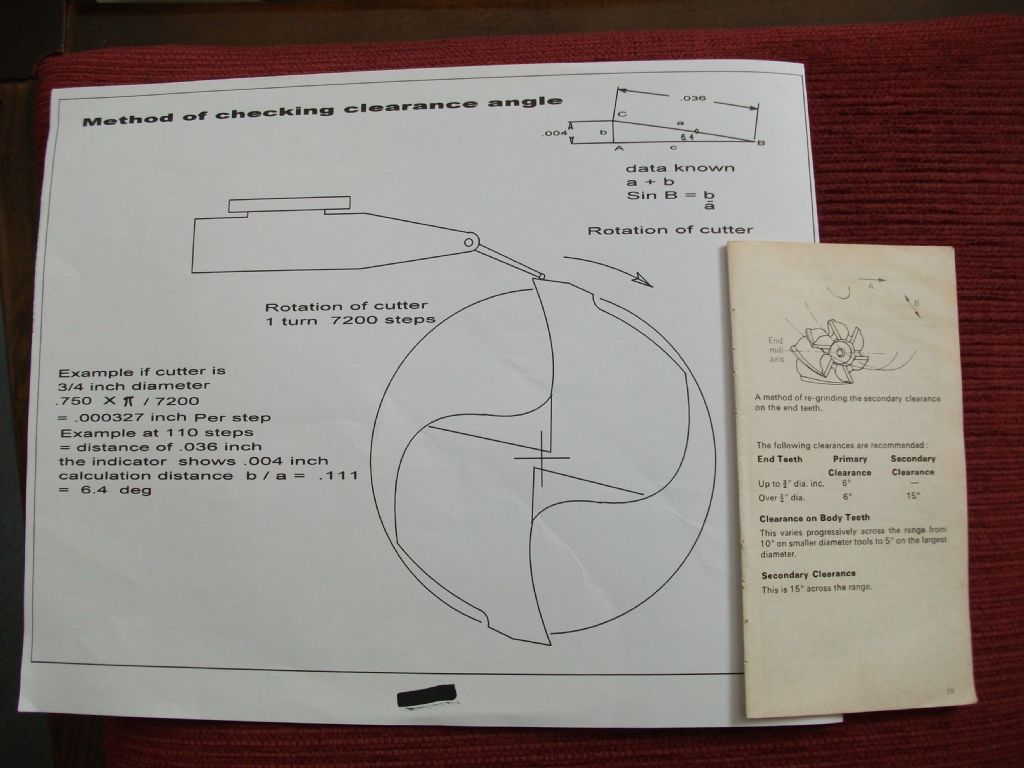

                    Early on when i first made and used this machine this is
                    how i would set up,now i use the same basic method but grind
                    first the secondary clearance. The Quorn book seems to show
                    the primary clearance as 6 deg ,in a Dormer handbook this is
                    shown as " Clearance on body teeth , this varies progressively
                    across the range from 10 deg on smaller diameter tools to 5 deg
                    on the largest diameter . Secondary clearance ,this is 15
                    deg across the range".
                    Setting 15 deg on the machine ,20 motor steps = 1 deg ,rotating
                    the work shaft 300 motor steps sets the 15 deg.
                    When the cutter is ground, the secondary clearance can be
                    measured on the machine as in the photo diagram ,since from
                    this the true angle is known it is a simple matter to rotate
                    the cutter to set the primary clearance angle.
                    Page 94 of the Quorn book makes reference to grinding
                    on the periphery of the wheel.
