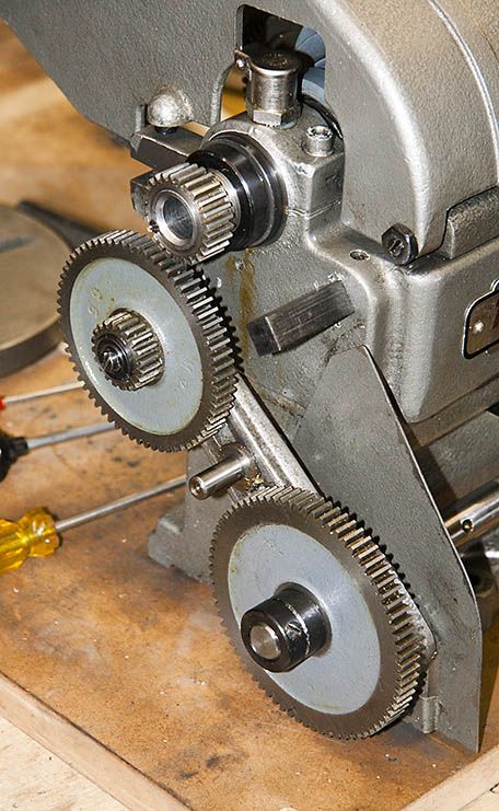

      Just purchased a Myford ML 10 from out of the Netherlands (I live in Belgium). It is in pretty good shape for its age and all tolerances appear to be tight. Only a few little problems to be sorted.
      Warning: I’m a bit of a newbie with Myfords, so please bear with me. I’ve experience with metal lathe work (Sheldon, Taig, Unimat), just not with the British made Myford.
      Stupid, obvious question first: What wrenches are needed for the Myford? Do I need to purchase a set of British (Whitworth) wrenches to use on the hex head bolts, or will American inch-measure wrenches serve?
      A similar question applies to the Allen head screws on the lathe. It sort of seems like metric Allen wrenches fit (??), but can that be correct?
      The biggest issue is that prior to my purchase most of the change gears went missing. That means no threading and no auto feed (horrors!). I see that almost all change gears are still available, either from Myford UK, RDG Tools or on eBay. My big concern here is that the splined bush for the center transfer idler gear pair is also missing. I could probably make it with a bit of fussing, but far easier if I could just purchase a replacement. RDG tools offers a change gear stud assembly. Is that what I am looking for?
      **LINK**
      Another problem: The lathe came with two Pratt Burnerd chucks. The 4-jaw independent is just fine. The 3-jaw self-centering chuck is missing two out of the three external jaws. Are replacement jaw sets for these chucks to be found? Or is it simpler to avoid the grief and just buy another (complete) 3-jaw chuck for external use?
      I see from the literature that a dog clutch was once available for this lathe. I don’t really need to tackle this issue right away, but it would be quite useful to have in the future. It doesn’t appear to be so very difficult to machine such, but are there any plans or literature available to help me with this?
      Any other tips or pointers gratefully accepted.

          Maybe the missing bush is still in one of the missing gears? You are still needing retaining washers and screws for the gears anyway.  There should also be another bolt and spindle for the fitting of 2 gears. .Do the mod. to the cross slide spindle as well.
          Clive.

            That is probably true. Sadly, the change gears were already missing when the previous owner purchased the machine.

                You will need Whitworth or BS spanners to fit the nuts and bolts on a Myfrod. American AF spanners will not fit.
                But ordinary American AF Allen keys will fit the Allen head bolts on the Myford.
                No metric fasteners on the machine that I know of, unless fitted by previous owner etc.
                Note too that many of the smaller threads such as oil nipples and gib adjuster screws are BA threads. The hexagon nuts on the gib screws use a Whitworth/BS spanner though and the oil nipples a small BA spanner (AKA shifting spanner in my shed.)
                I havent come across a standard dog clutch for the Myfords but have not extensive experience with them. But Martin Cleeve's book Screwcutting in the Lathe has plans for a shop-made screwcutting dog clutch that could be handy if doing a lot of screwcutting but not really needed for occasional use.

                  The two open ended spanners supplied with the plain bearing ML10 were
                  1/4"BSW:5/16"BSF + 3/16"BSW:1/4"BSF
                  5/16"BSW:3/8"BSF + 3/8"BSW:7/16" BSF
                  I can't remember ever having to look for another spanner for my ML10 in 40-odd years. smiley
                  The Allen keys required were Imperial and there is one special one to use on the cap head screw holding the locking dog on the bull wheel. It has its end at around 70 degrees rather than the normal 90 degrees and is shorter than normal. This lets you get at the screw in behind the front headstock bearing.
                  Another mod you might consider is fitting a calibrated ring to the leadscrew handle so that you can move the saddle by known, accurate amounts. If you do this, you will need a leadscrew clutch to avoid having to put your gearing out of mesh when using the hand wheel. There should be a groove ground round the leadscrew which showed where to cut the it for the Myford clutch.
                  I note that one of your lathe's previous owners did what I did, and fitted wick fed lubricators requiring a cut out on the belt guard. smiley
